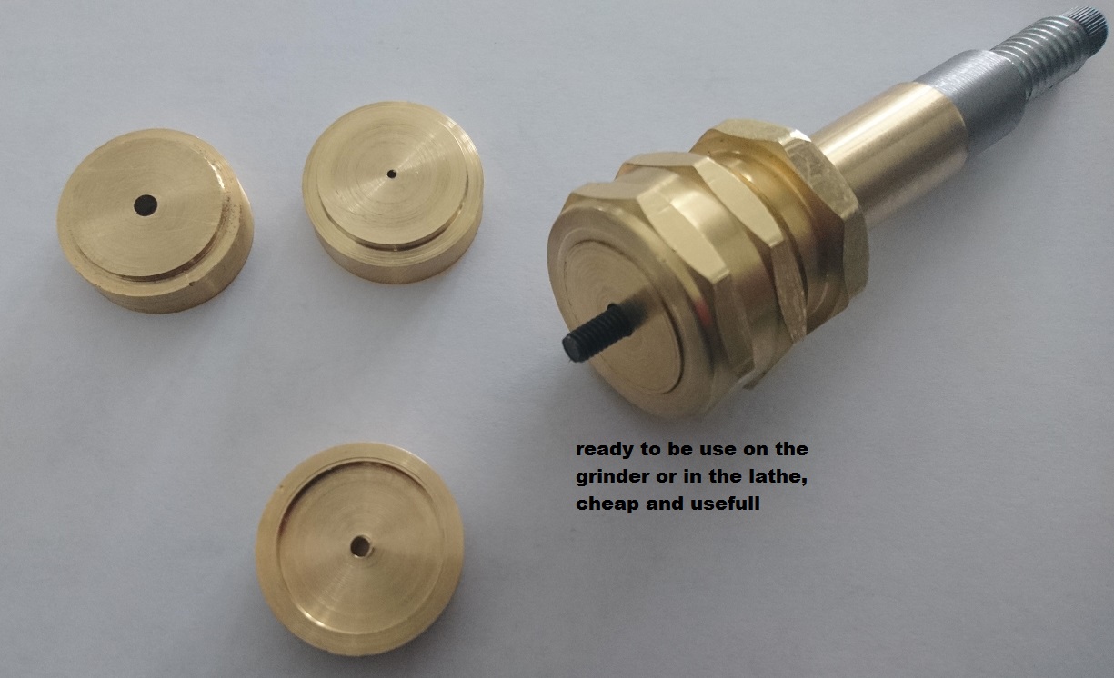

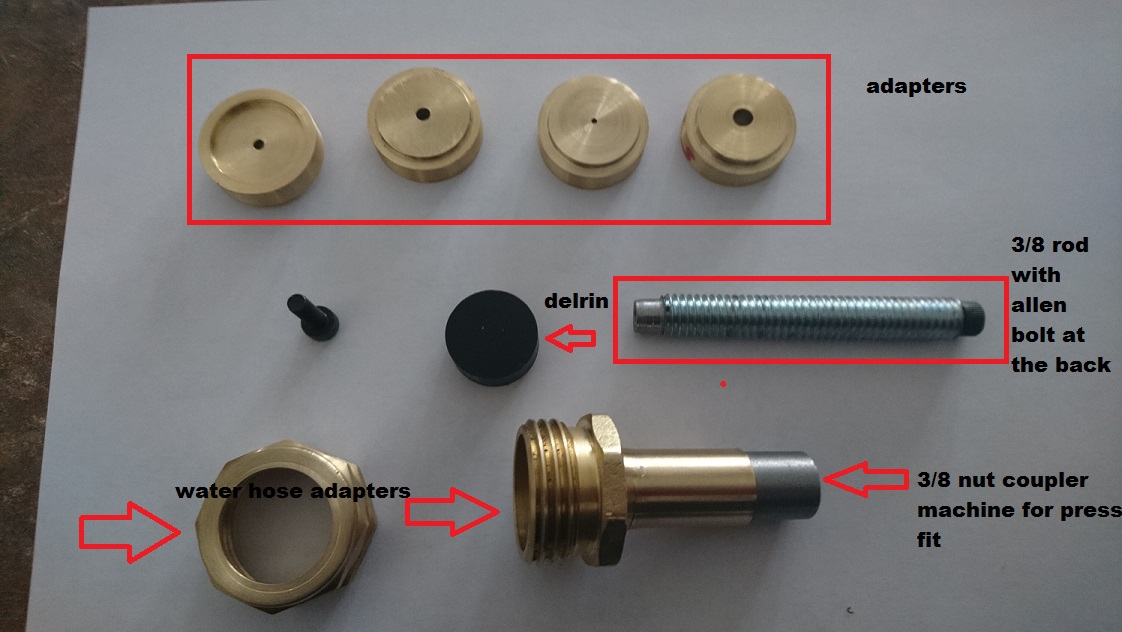

    Hi this is my version of lantern chuck.
    it's cheap, easy to make and versatile. It will hold a nail up to a 3/8 bolt.

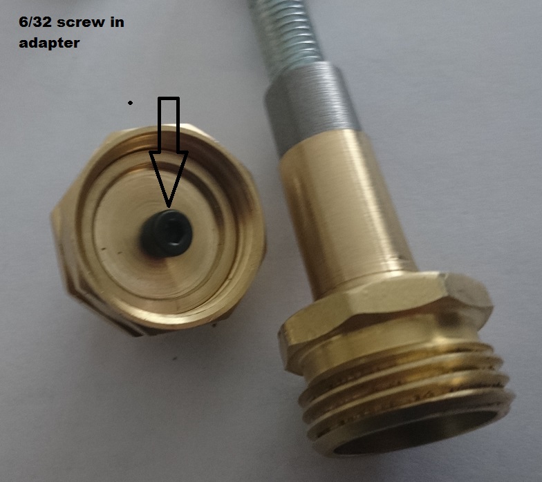

    you could to 3/4 head if you want. the main body are water coupler. one end was machine
    so I could press fit a 3/8 nut coupler.I did put a socket head bolt at the end so I can use it in a lathe.

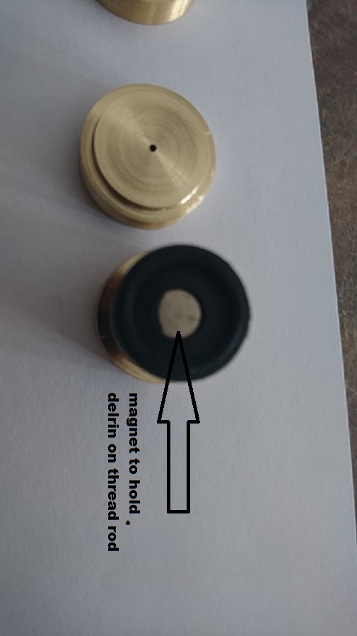

    the delrin parthas a magnet in it. It's precise enough you can put it in a lathe to machine a screw,bolt
    enjoy the picturesClick image for larger version.
