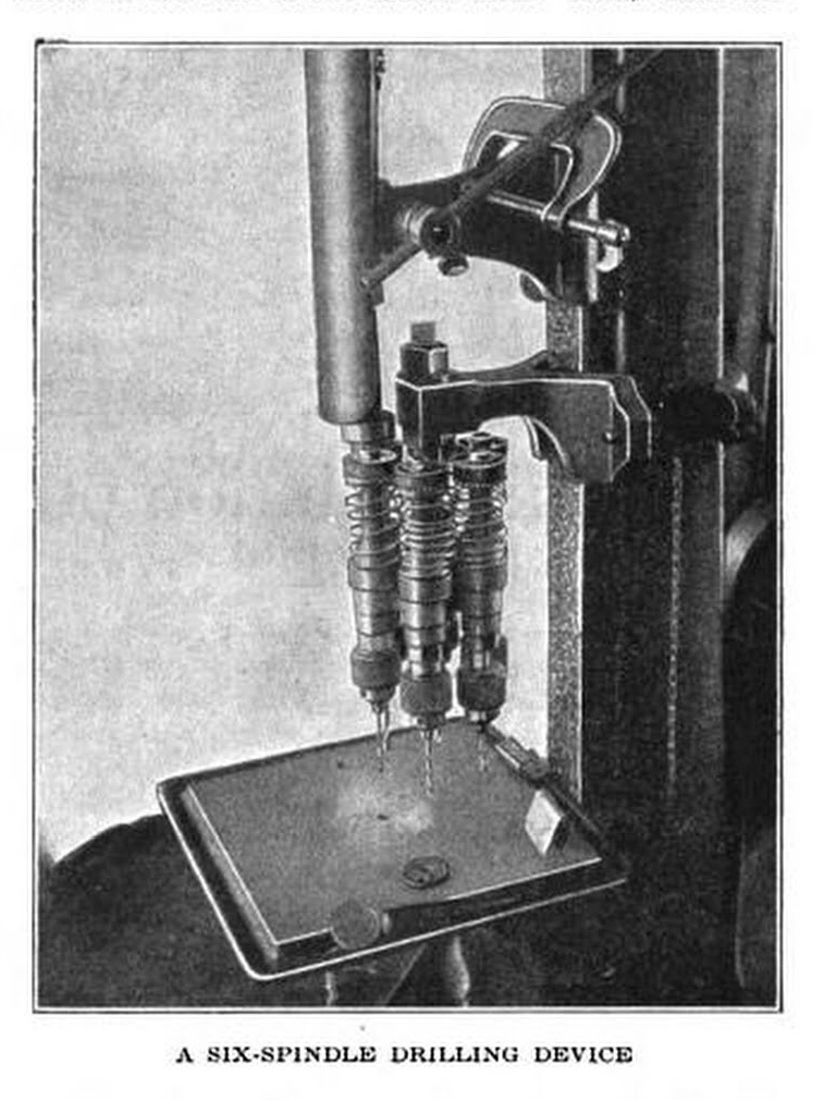

Similar system from the 1920s by Charles Cuno of Meriden, CT, that I noticed looking for something else. I think I saw pictures of small lathes with revolving drilling tailstocks like this, too.
Attachment 30249
https://books.google.com/books?id=Mr...page&q&f=false

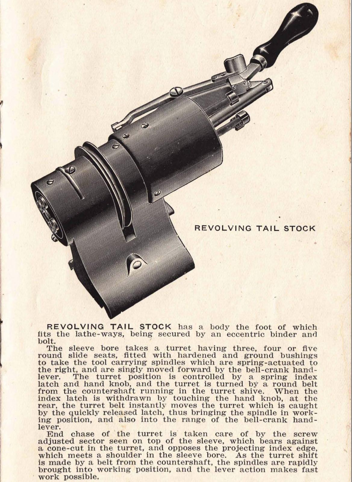

Edit: I guess I misunderstood what the pulley was for on this Sloan & Chace tailstock - though run by the overhead belt drive it just advances the turret to the next station.
Attachment 30295
The also non-rotating Stark tumble tailstocks have a similar look to the Cuno drill, though. Stark Lathes Page 2
