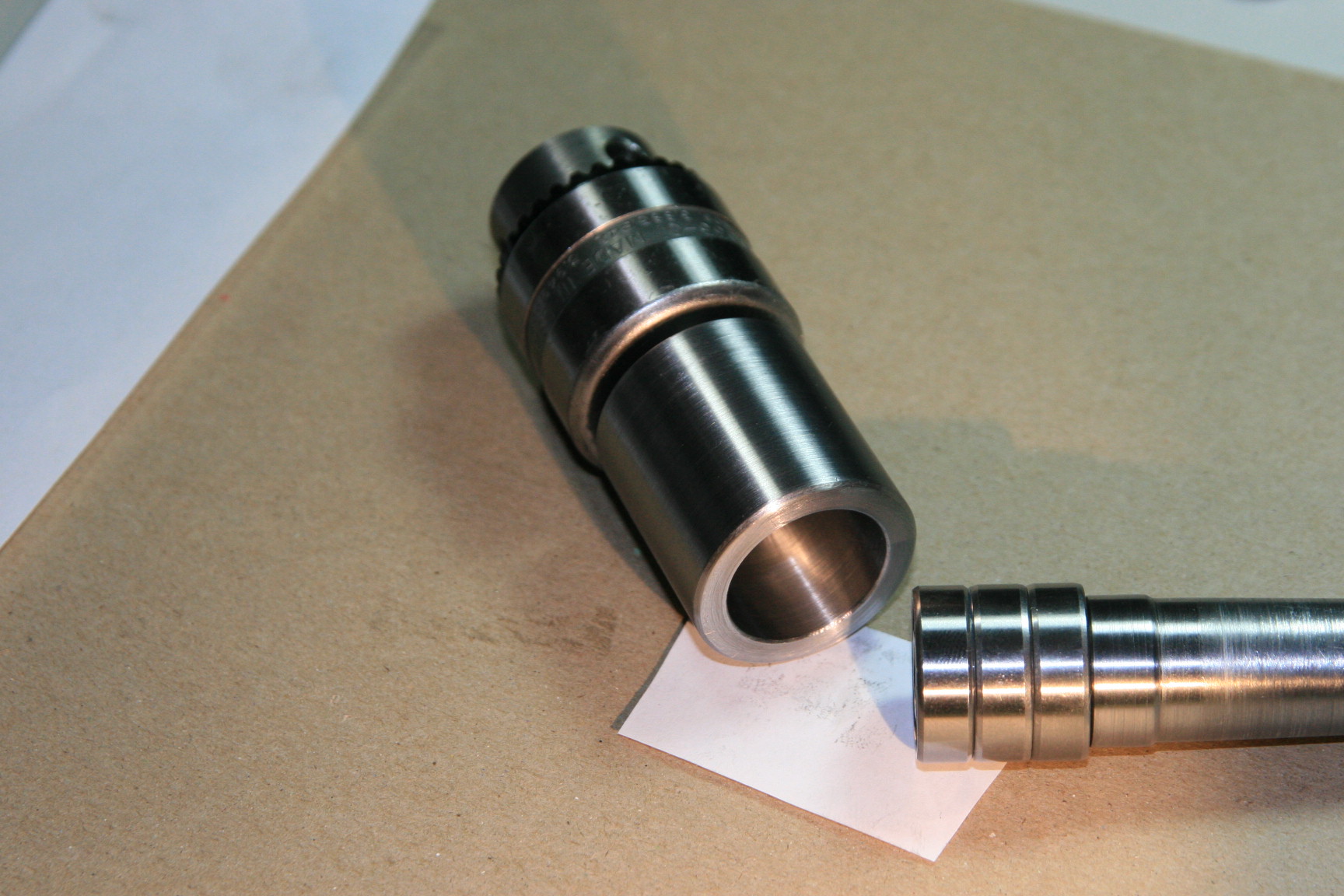

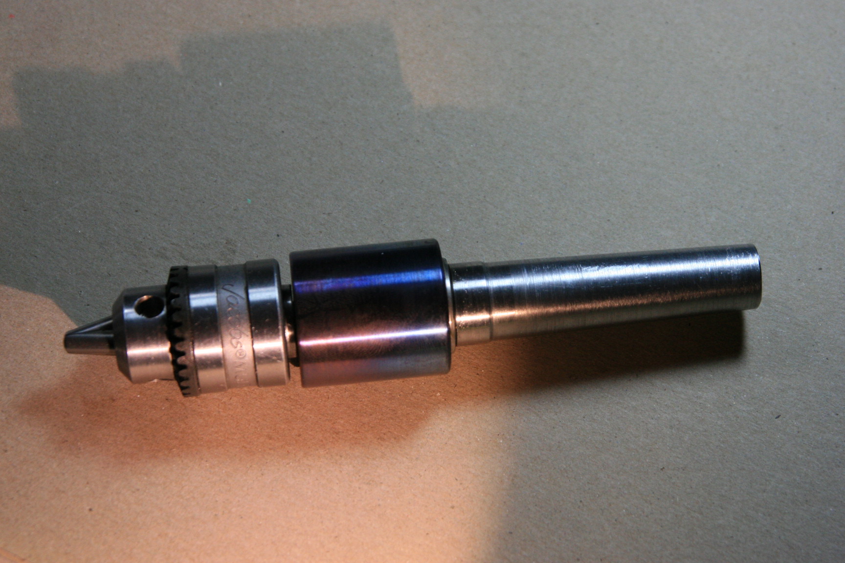

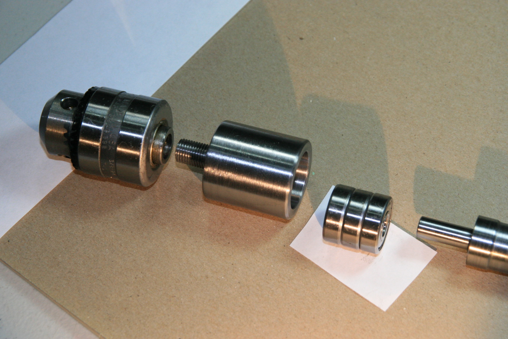

    Had to stop the progress on the little steam engine model I was building due to small parts.
    This particular shaft has a very small .093" section and another at .064".
    Well after one attempt I found that a standard live or dead center would not work,
    at least not for me. So I found some ideas using a revolving chuck in the tail stock
    to hold the end of the shaft. Seems like a good idea so I made one.
    Just used a Jacobs chuck with a 3/8-24 thread and some bearings along with
    a MT2 taper blank that I made a year or so ago and some mystery metal. I think
    the mystery metal is just some hot rolled steel that was left over from another project.
    I turned the parts for an interference fit so that I would have to cool (freeze) the MT2 arbor
    for the inner race of the bearings and in the last step the housing was heated with a propane
    torch so the outer race of the bearings would slip into it. Worked out great. I figured this was
    a one time build and that if it went together properly it would never be taken apart.
    The pictures show the story. I used 3 surplus bearings that I had in stock and fired up the lathe.
    First use will be tomorrow when I make that tiny shaft.
    Cheers, JR

    Jr I used to have a dead center that instead of a point it was bored to accept a point made from a .125" tungsten tig tip spun ground to a sharp point it worked beautiful for small parts.

    JJR2001's solution is well founded; when a center isn't feasible, often due small diameter. Frank S's tungsten is excellent alternative. A 60 degree pointed drill blank and high pressure grease is another. Dead centers don't run any RPM long if dry before galling. https://www.google.com/search?q=lath...utf-8&oe=utf-8
    We often have to bore ends of long rollers used in printing industry. This is to repair bearing fits after sleeve is inserted.
    Before anything can start the end usually needs a narrow area turned for the steady rest to run. This is done with the left end in a 4-jaw, and a 4-jaw in the tailstock.
    Both chucks are 'timed' together, visually and then with a torpedo level, oriented so they mirror the same clock position. Tailstock chuck is a soft #5 taper dead center, turned to fit dual bearings, and a 10'' chuck [reversible jaws, no back plate] bored to fit the bearing OD. This was shop made decades ago; they are also sold by toolhouses. https://www.google.com/search?q=4+ja...utf-8&oe=utf-8
    Can't make much recommendation as to sizes, readers have too many possible combinations of equipment. But three independent ball bearings is good enough for typical live centers. Another combination might be needle roller and angular contact, positioned 'inboard' for thrust. Also possible: to mimic a live center with live bearing at each end, or sleeve a center with a bronze valve guide.
    The main fabrication issue will be attaining near perfection in concentric axial and radial surfaces.
