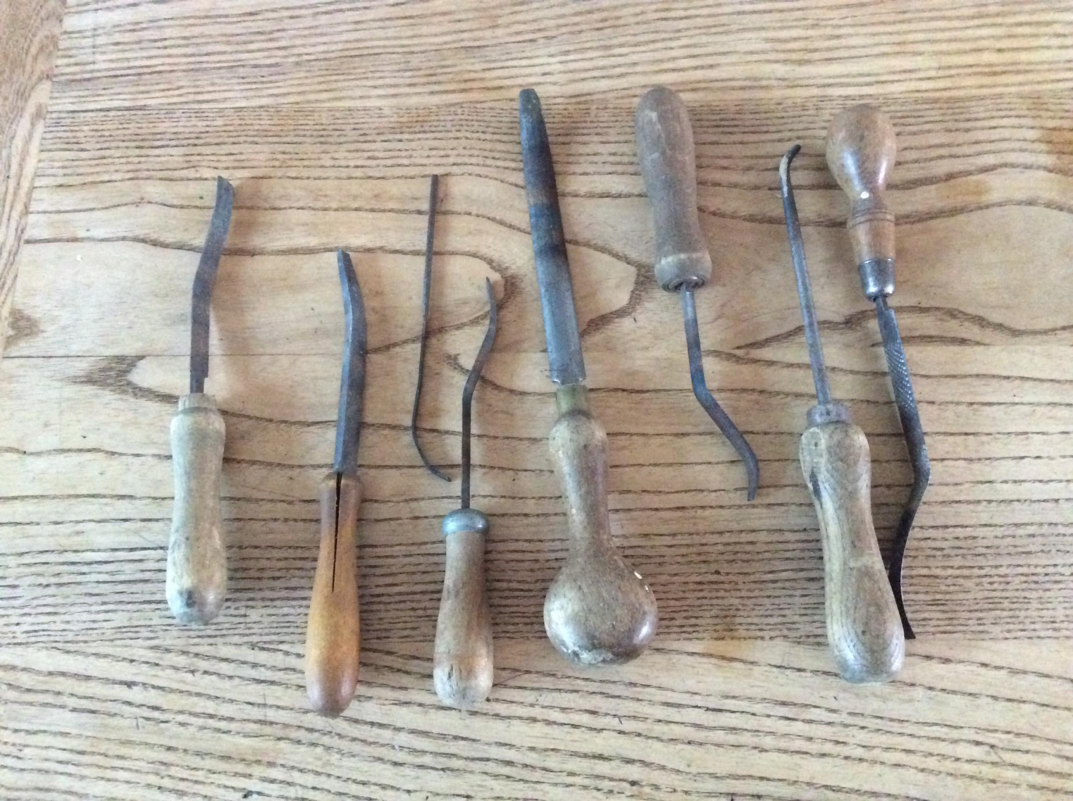

    No need to buy rifflers for woodcarving if you have some old files - the tips seldom show much wear. All you need do is to heat it to a cherry red, (which you can do in a barbecue, bend and quench. Sanding carvings is so tedious, isn’t it?
