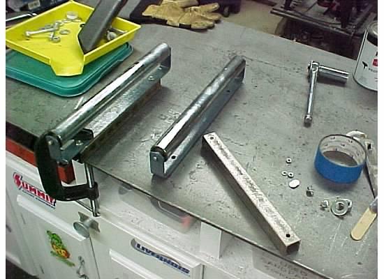

ANYWAY, I had a set of cheap rollers I got at HF so I made an impromptu rim roller to make it easier to work on them.
Here are the parts involved. The rollers and a couple of pieces of 1" square tubing.
https://s3-us-west-1.amazonaws.com/f...che/9877-1.jpg

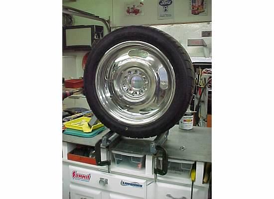

Bolted the rollers to the tubing and use a couple of c-clamps to hold them on the work table.
https://s3-us-west-1.amazonaws.com/f...che/9877-2.jpg
The tire spins real nice on these and should make the work ahead a bit easier.
