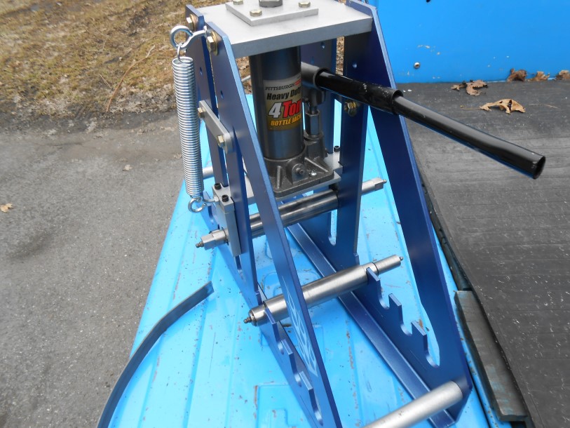

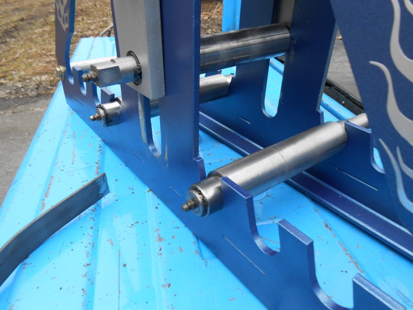

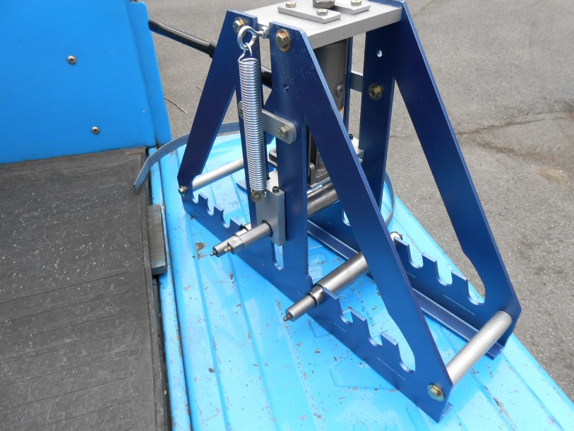

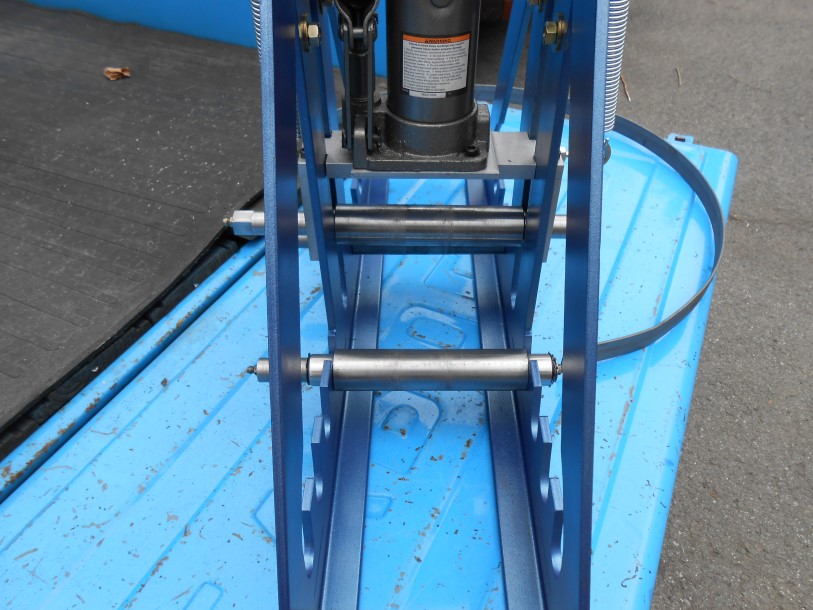

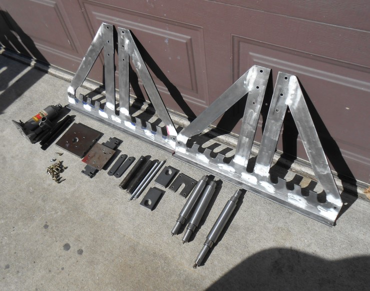

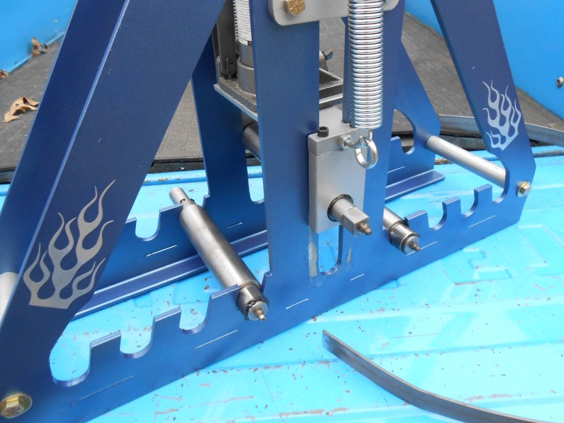

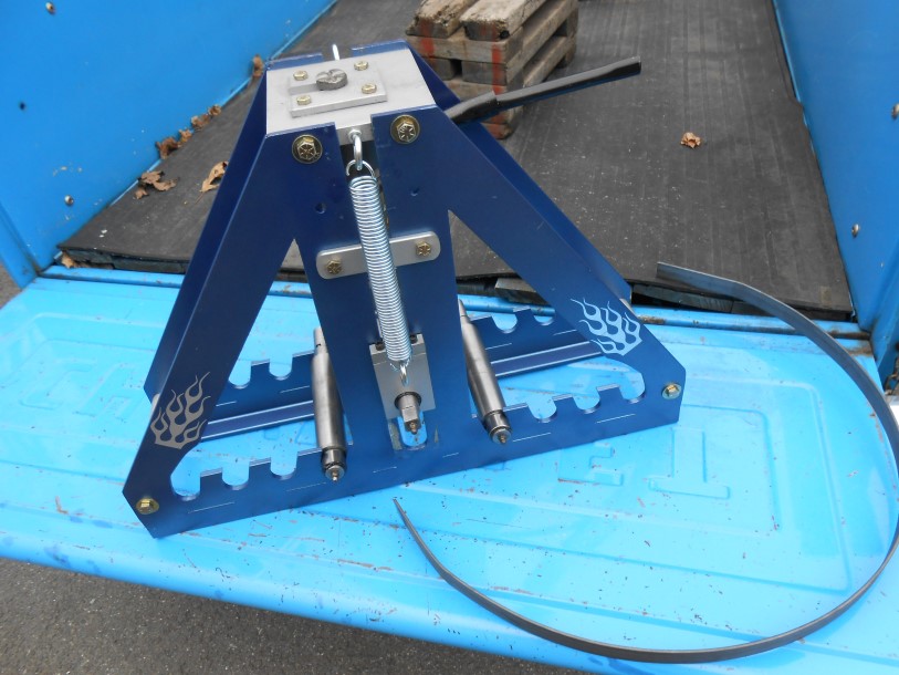

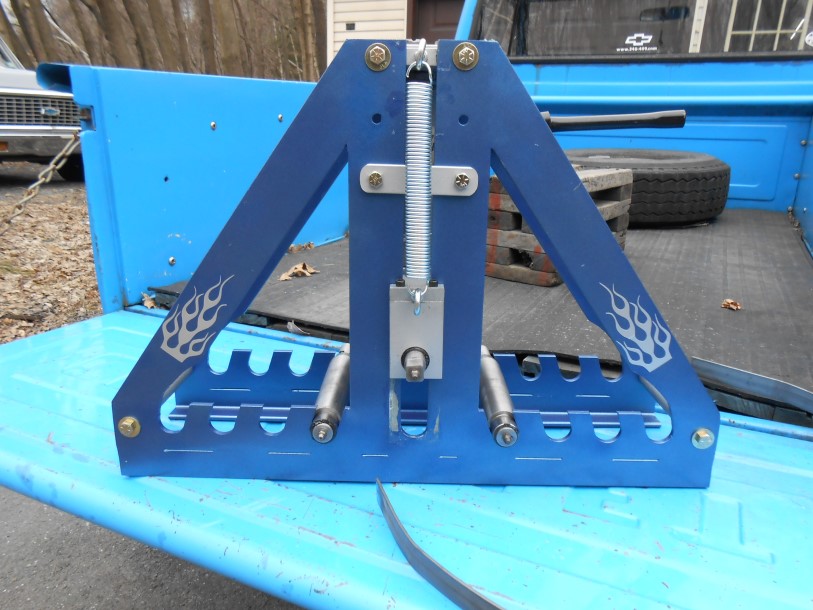

I've been working my tail off on this latest project and it's finally time to unveil it! What we have here is a multi purpose ring, tube and pipe roller.

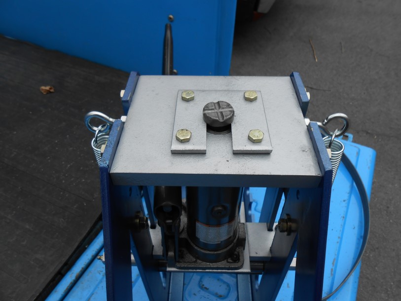

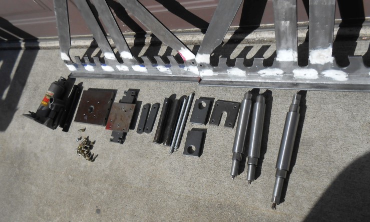

Designed from other rollers I've seen on the net with a few of my own touches added. You can roll flat material on the inside up to 6 inches in width! I will be making slip collars that can go on these rollers for working with square and round tube/solids. Pipe and tube dies can also be added as I need/make them and can be made up to 4 inches in diameter. It features a 4 ton jack for downward pressure, needle bearings at both ends of the shafts and I drilled and added zerk grease fittings for maintenance purposes. I also milled a square end on both sides of the upper shaft where a wheel will be installed. (use it on either side) I will be making a 20 inch wheel with this tool soon. (and other improvements as I see the need)
In addition, I created extended shafts on the back side. This is to accommodate roller dies that I will be making for lighter materials. I'm thinking of making dies that have about 4 grooves each so they will work with 4 different sized round materials like 3/16, 1/4, 5/16 and 3/8 would be a good start.
P.S. The brushed aluminum flame graphics were added for show and offer no improvement in performance. :D Paint is a dark blue metallic by Rustoleum with their hammered gray for the accent pieces. All hardware is grade 8.
