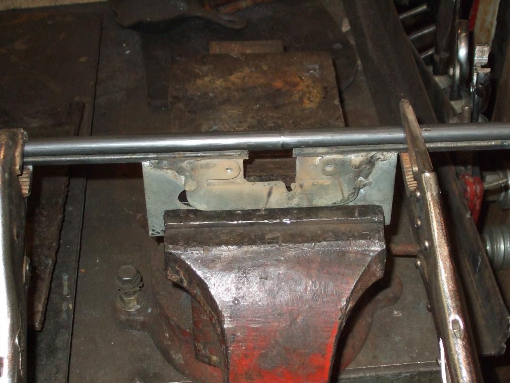

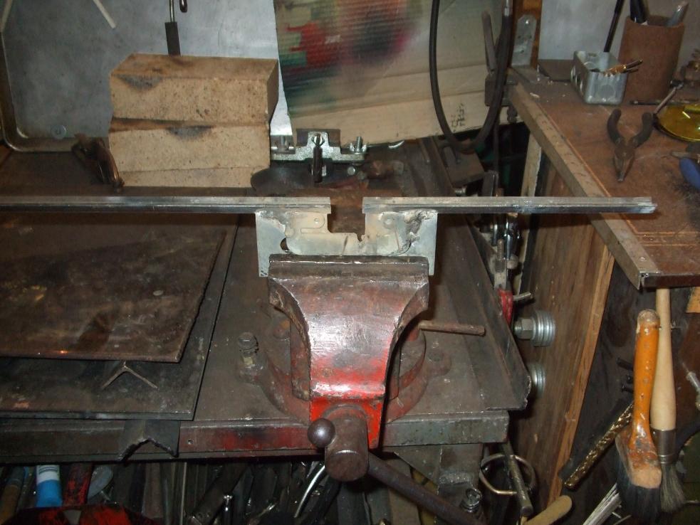

    Made this to hold rods in alignment when welding end to end. Just used small angle iron and some scrap.

    That's one useful jig strube1369. Could be used for pipes or anything cylindrical.

    Nice. One doesn't really need to have a nice-looking tool (though always a bonus!) to achieve a well-finished workpiece.
