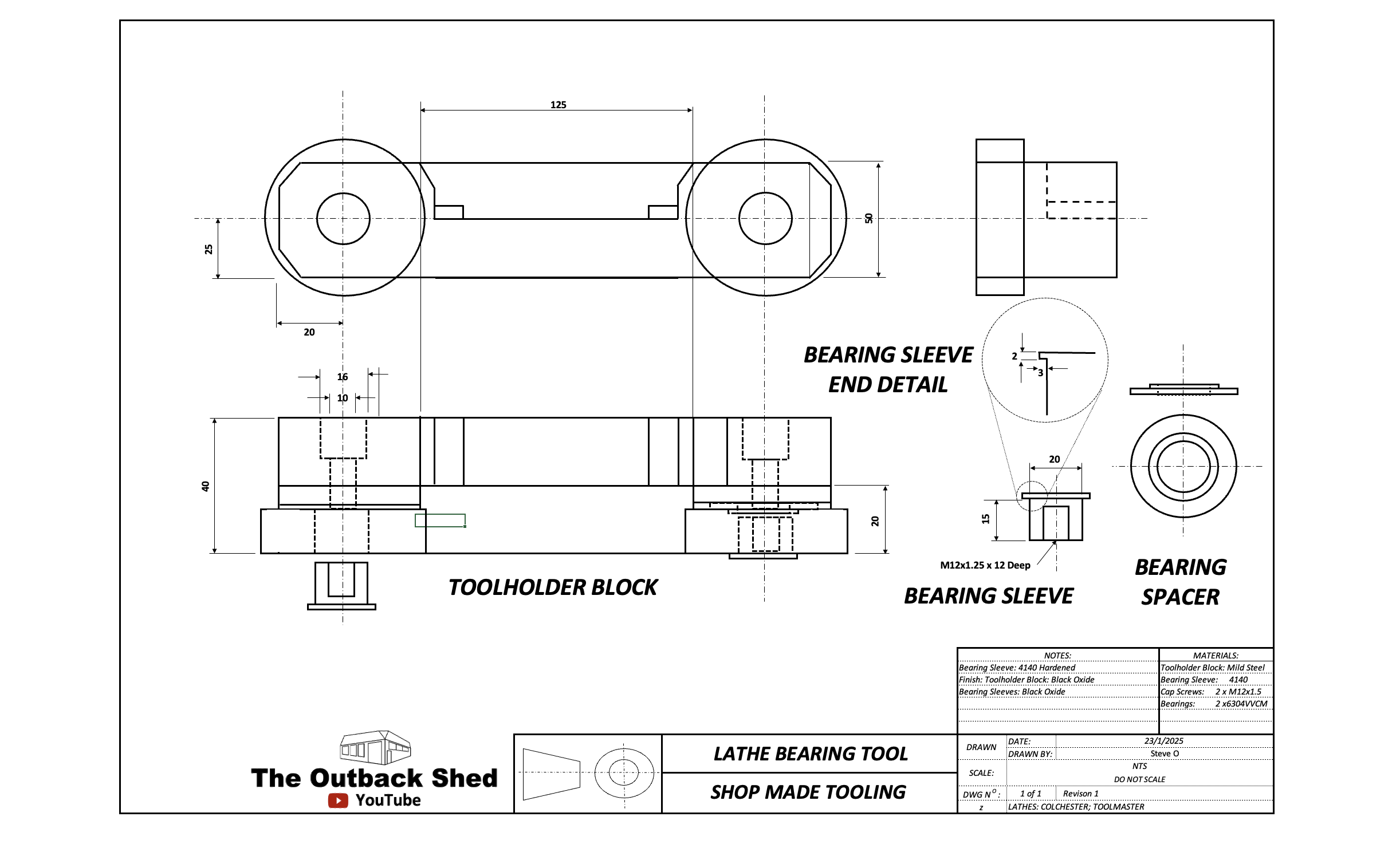

    Rollers & Balls - A Bump and Burnishing Tool for the Lathe - Plan Includes
    Channel Link:
    youtube.com/channel/UCiACkN-H8fmDl_R0YZi1dMQ?sub_confirmation=1
    Rollers & Balls - A Bump and Burnishing Tool for the Lathe - Plan Includes-lathe-berring-tool-drawing.png
    This Shop Made Tools Project is to build a Push Tool for the Colchester and the Toolmaster Lathes.This is a multi-use tool, not only for aligning work in both the X and Y Axes but it is strong enough to be used as a Burnisher as well.The tool has extra-large bearings to allow for a rear mounted socket head cap screw and with minimal stick out on the working side of the bearing this allows the tool to be used close to a shoulder.This project could be seen as a follow on from the ‘Diamonds & Balls’ project as I am making a tool that is a useable burnisher.We will compare the performance of this tool with the Ball Burnisher from the previous build, adding to the lessons learned about burnishing.
