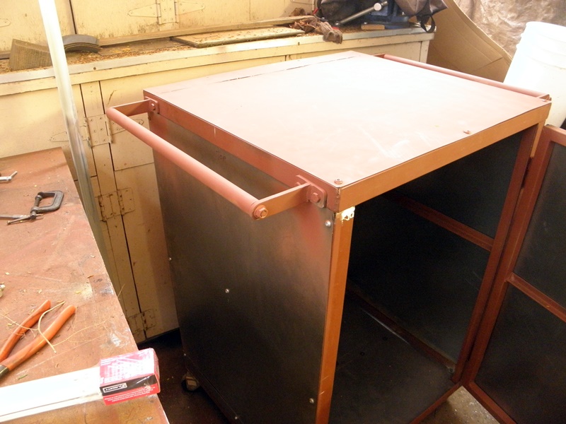

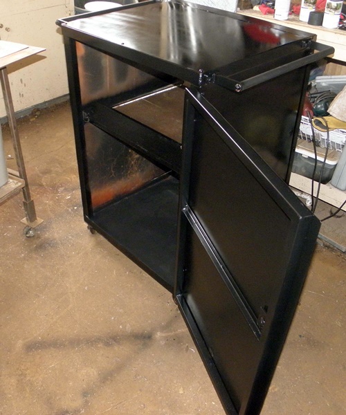

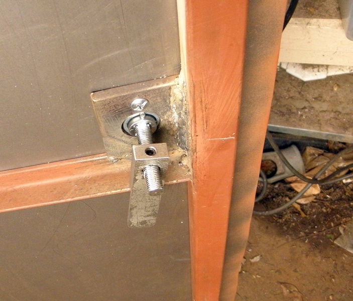

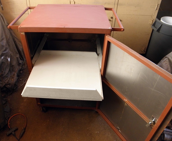

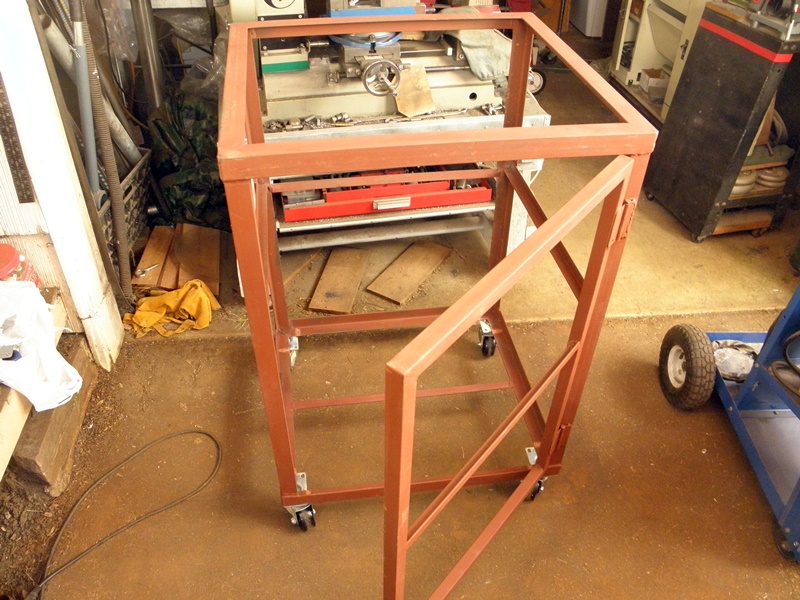

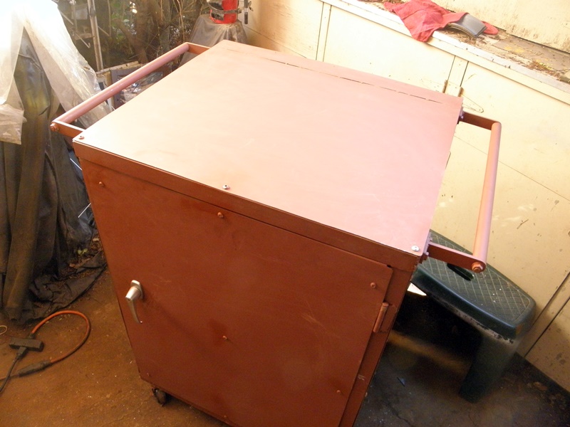

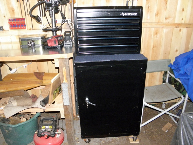

    Rolling tool cart...Made from angle steel,sheet metal galvanized, drawer sliders and knotty pine wood.
    I started to weld the skin on but changed my mind after the first one
    and went to sheet metal screws.I will put some electric tools in the drawer, ie router, drill, belt sander ect. I used emt for the handles and 1/4 CRS for the brackets welded up.
