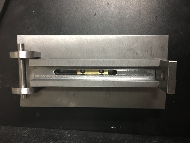

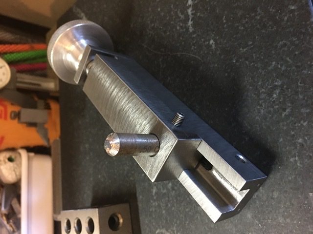

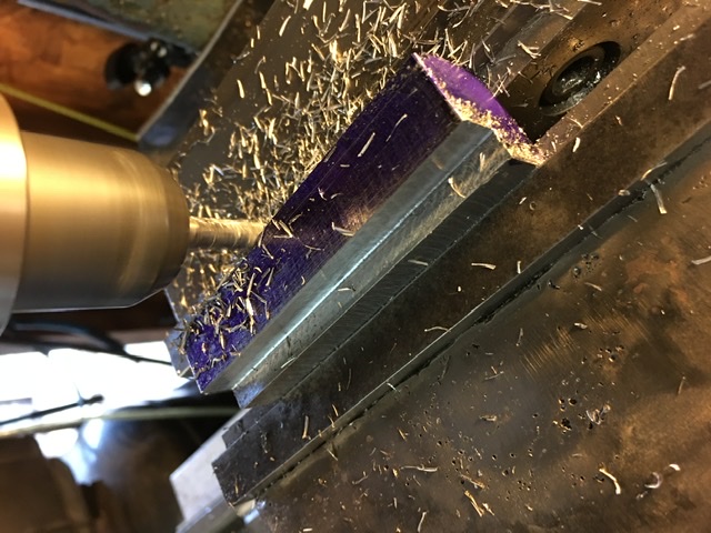

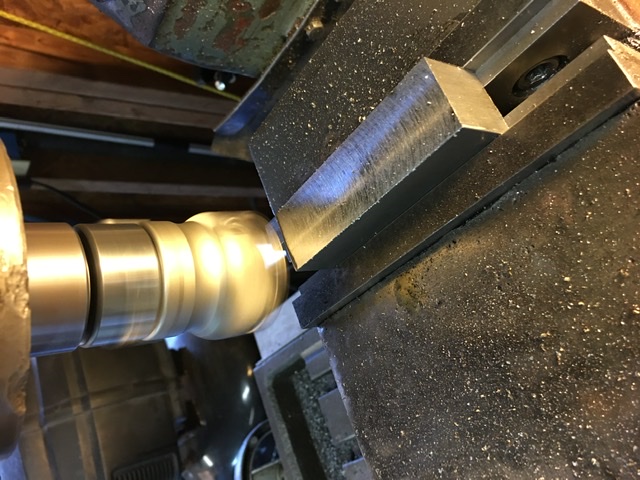

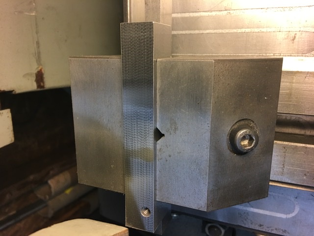

Starting work on the upper body portion.
Attachment 32394
Attachment 32395

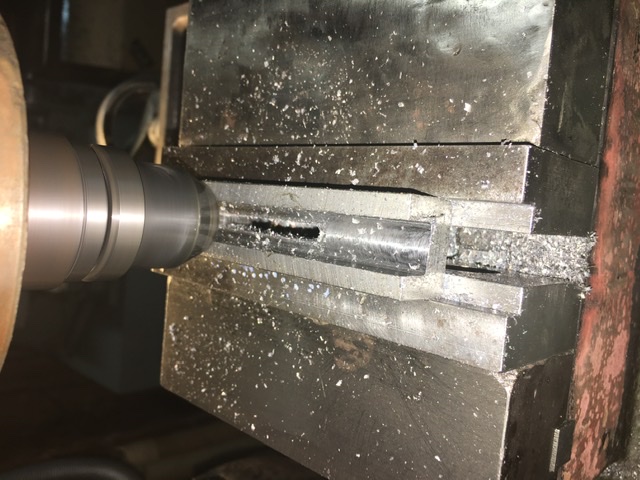

Cutting slot in lower body.
Attachment 32396
Attachment 32397

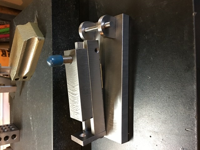

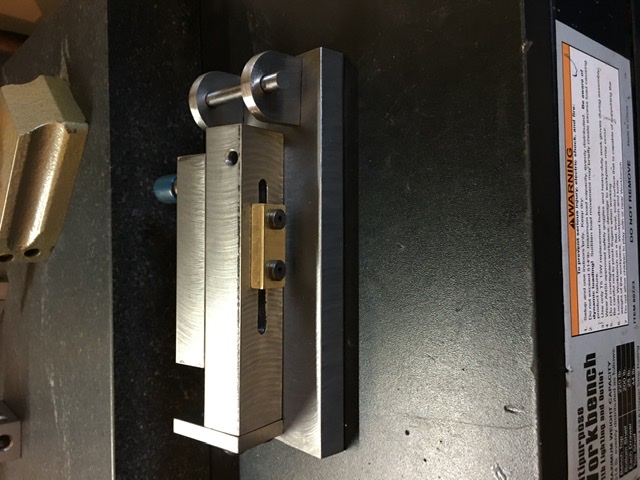

Body complete, testing fit
Attachment 32398
Attachment 32399

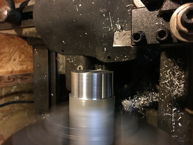

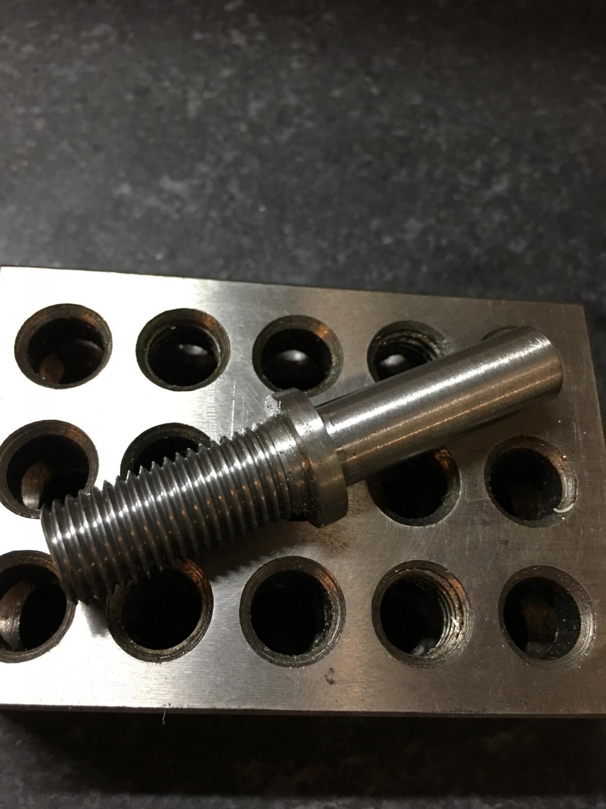

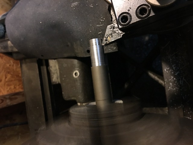

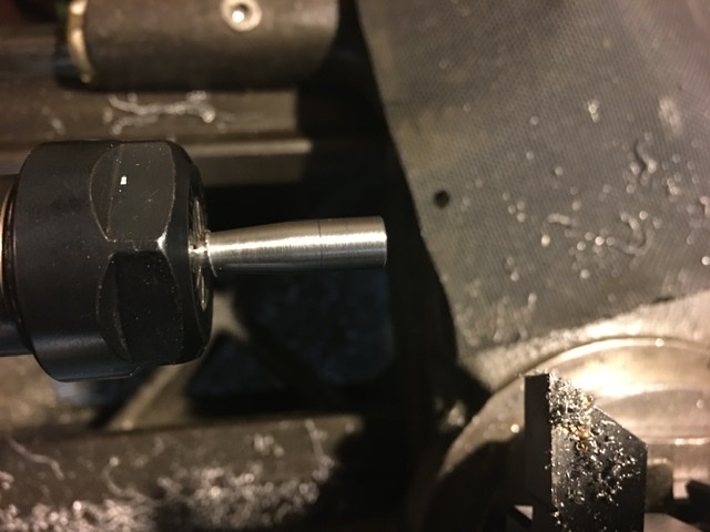

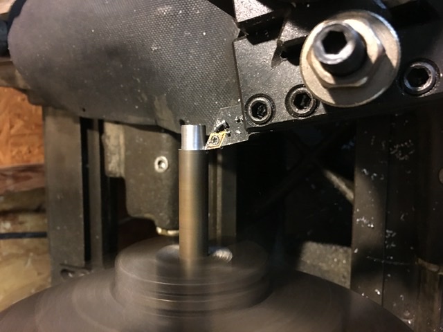

Lathe work is next, starting on the screw first.
Attachment 32400
Attachment 32401
Attachment 32402

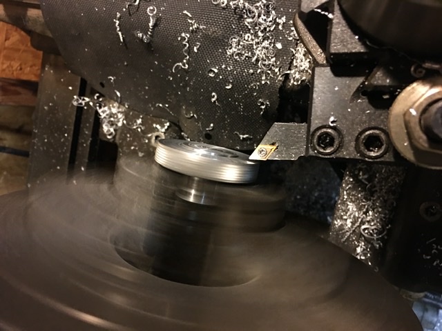

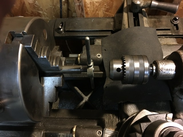

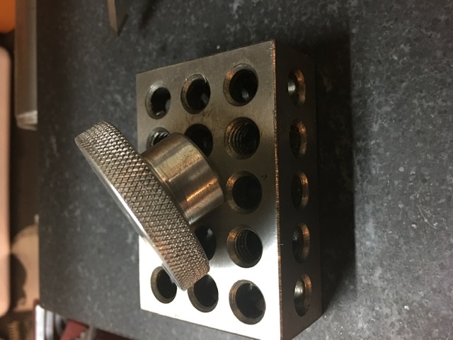

The knob, tapered and threaded. Used a die for 10-24 threads.
Attachment 32403
Attachment 32404
Finally the hand wheel. Knurls didn’t turn out too well, should’ve went deeper.

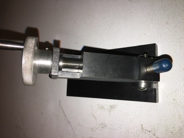

Final assembly before grinding.
Attachment 32408
Attachment 32409

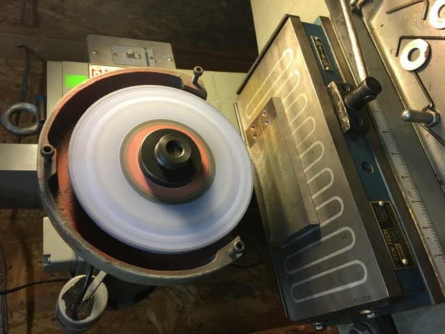

Grinding begins!
Attachment 32410
Attachment 32411

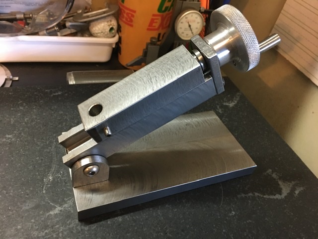

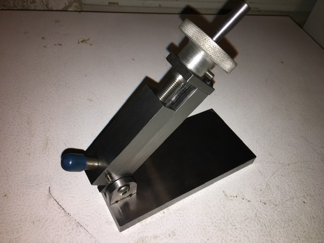

Final assembly, ready for use.
Attachment 32412
Attachment 32413
This was a fun project that will definitely get use in my shop. Thanks for checking it out and Thanks to Rossbotics for the clever idea and sharing it with us!
