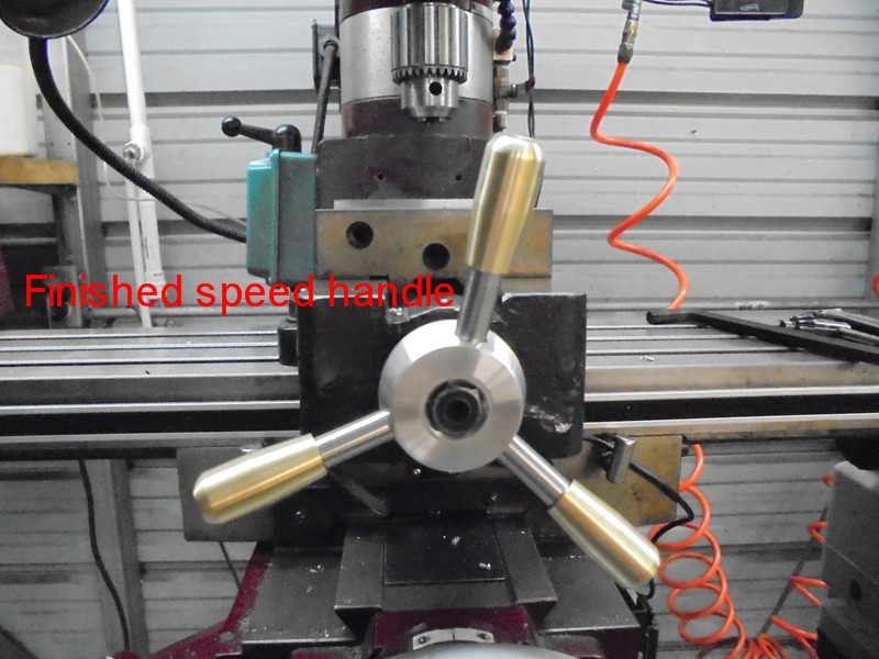

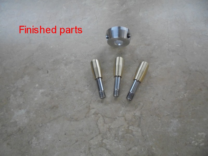

    What inspired me to make this tool was I wanted to make a speed handle for my mill vise, I have never been fond of any milling machine vise handle, while the original handle is satisfactory I still like things to be a bit more user friendly, the original handle is to awkward when having to open the vise up more than an inch or so, they have a tendency to fall off and hit your big toe nail, while speed handles are readily available I still prefer to make my own tools, store bought tools today aren’t what they use to be, there is very little quality anymore,
    Making a new handle for the vise is easy; it’s the hexagonal hole in the handle that becomes a can of worms, shops with a punch press would have no problem with this setup, but unfortunately there isn’t one of those beasts sitting in my shop, after watching numerous videos on You Tube and reading about rotary broaching I decided that this was the most practical way for me to tackle this 9/16” hexagonal hole.

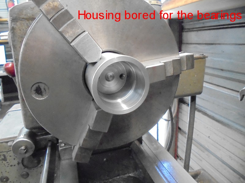

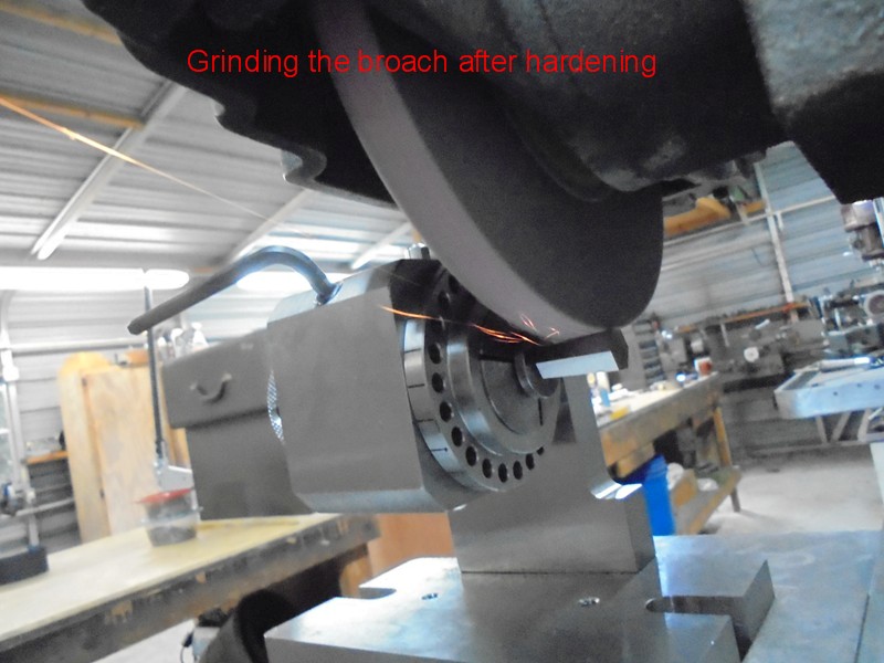

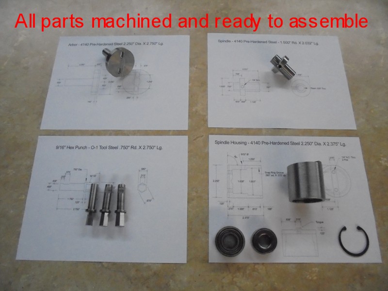

    There are only four parts to make, the arbor, bearing housing, spindle and broaching tool, the spindle rotates in a SKF-5204 double row angular contact bearing and end pressure is absorbed by a NICE-607 thrust bearing, the three main parts were machined from 4140 pre-hardened steel, the 3/8”-1/2” and 9/16” hexagon punches were made from O-1 tool steel hardened and ground, square punches and form tools can be made as well.

    All parts made for the Rotary Broaching Tool

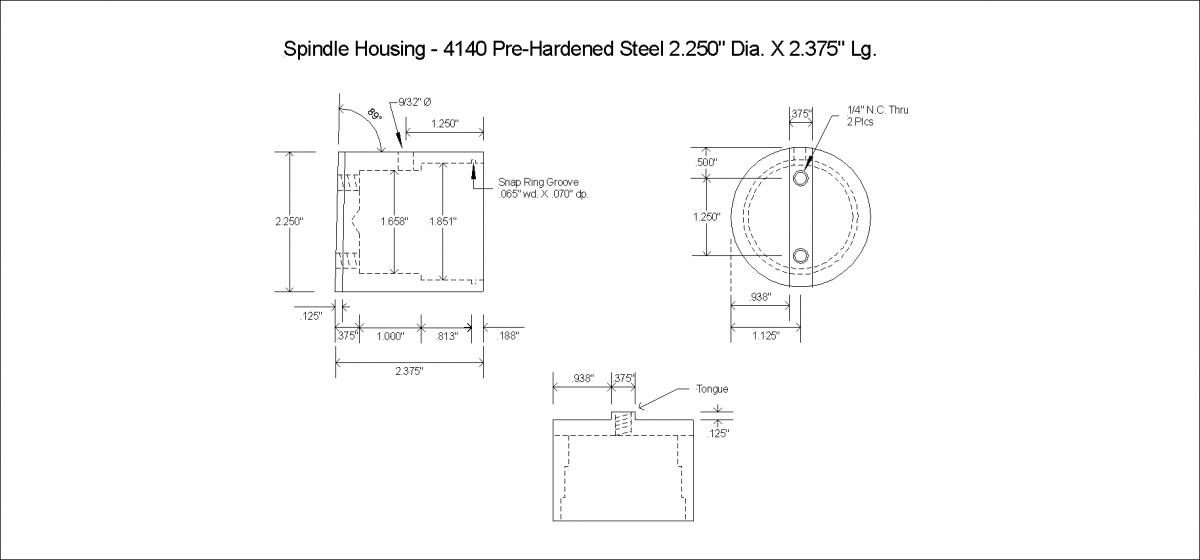

    Bearing housing bored for the angular contact bearing and thrust bearing

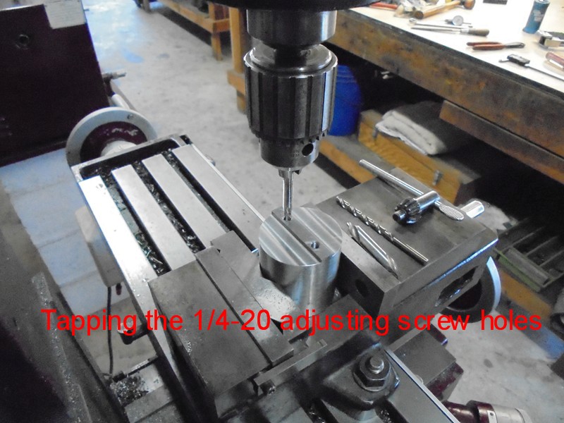

    A 1° angle has been milled on the backside of the bearing housing along with the tongue and two 1/4"-20 holes

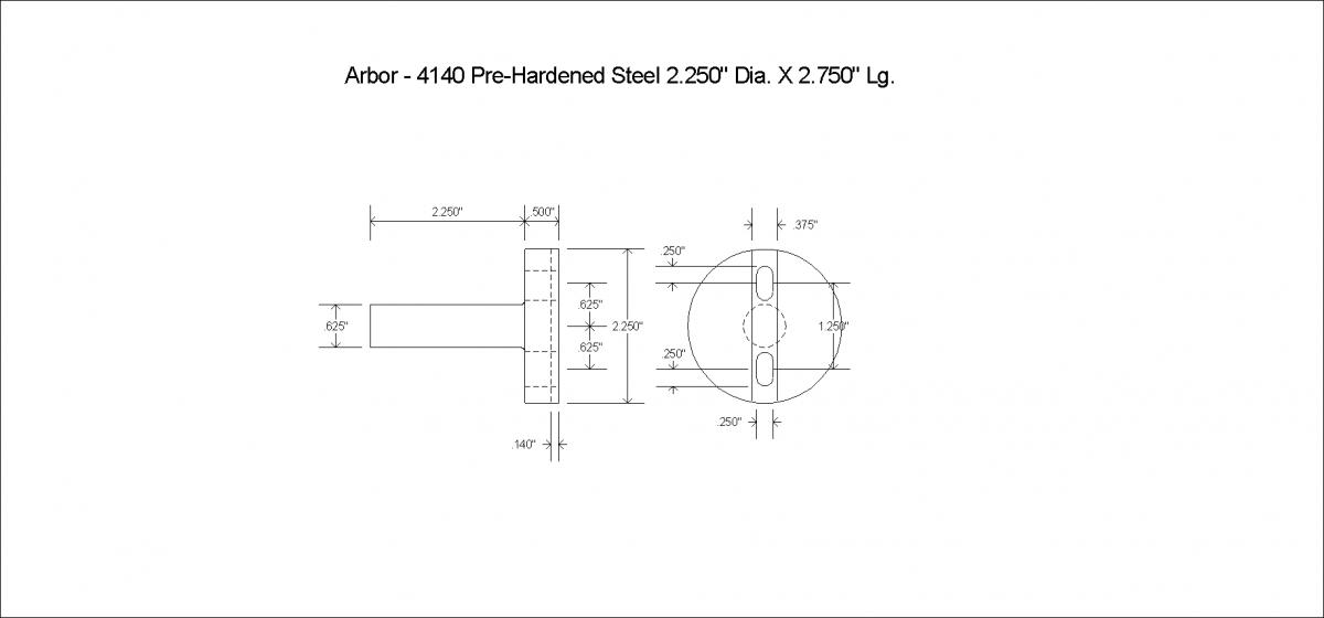

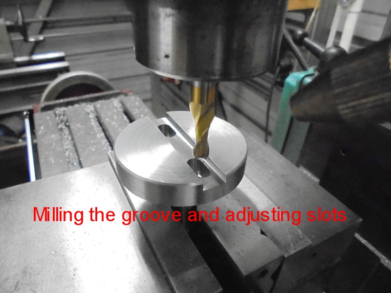

    This is the arbor with two adjusting slots and a groove for the tongue on the bearing housing to mate

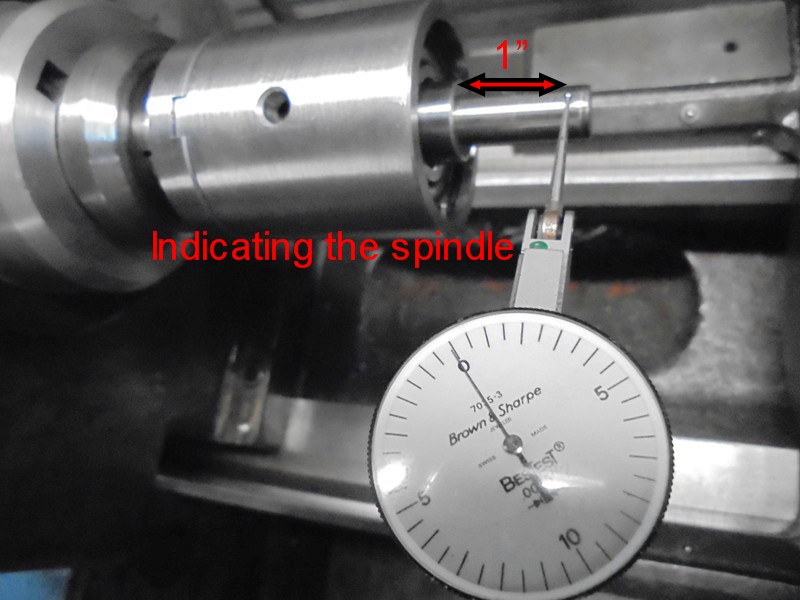

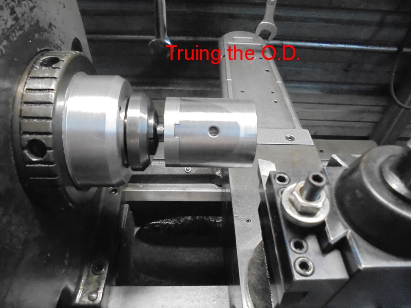

    This photo shows the unit assembled and installed in a collet on the lathe, a 1/2" dowel pin is protruding 1" from the face of the bearing, this is where the it has to be running true, all punches were made the same length so indicating was only necessary one time, make the punches the same length no matter what size they are and indicating will only have to be done one time, it's just a matter of changing punches

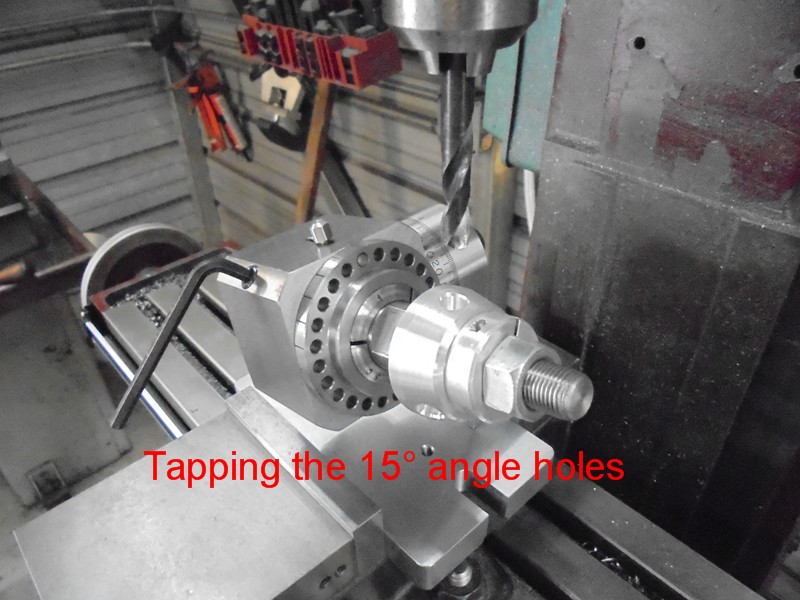

    This photo shows the unit held in a 5/8" collet on the lathe and being turned true after the indicating

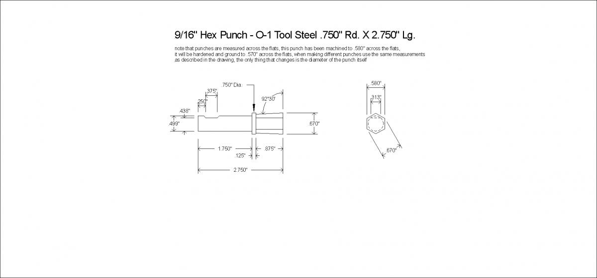

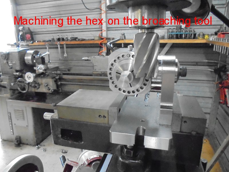

    This photo shows the hex punches being made
    This photo shows the punches being ground after heat treating

    This photo shows all the parts made for the speed handle
    Speed handle complete and install on the mill vise

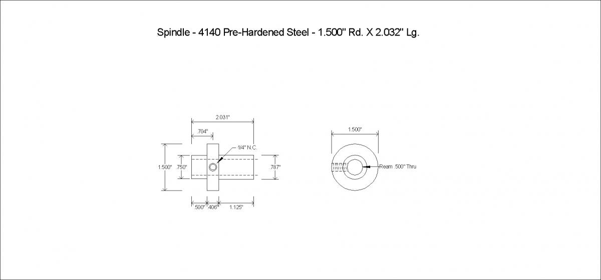

    Below are the 4 drawings to make this tool, good luck, and post your completed tool !
    Drawing of Arbor (above)
Name:	Spindle Housing.jpg
    Drawing of Spindle Housing (above)
    Drawing of Spindle (above)
    Drawing of Punch (above)
