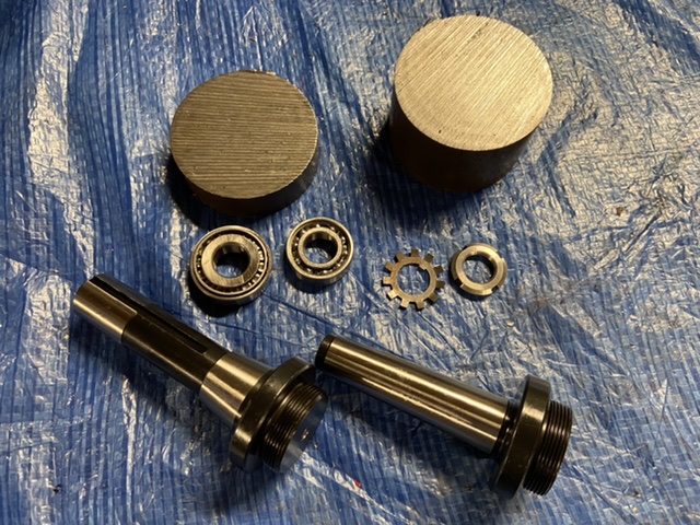

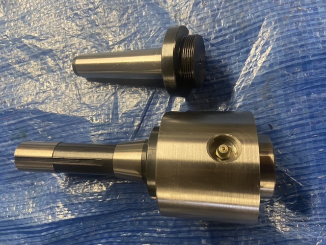

i don’t normally make a tool if I haven’t got a job for it but I am fascinated by rotary broaching. Anyway cutting a long story short I have made one and am very pleased with the results so thought I would share with you the build. I bought the bearings, tab washer, locking nut and two arbours (R8 and a 3MT).
Before I get on to the build I will try and explain how rotary broaching works and what it is used for.
Rotary broaching is a form cutting process and both internally and externally forms can be produced using this technique. (I am interested in internal forms) Examples of forms are squares, hexagons and splines which can all be produced.
The broaching tool body has the internal shaft supported on bearings angled at 1 degree angle which obviously allows the tool to run off centre (a bit like a drill that hasn’t been correctly placed in a chuck and then runs out). As the cutting tool is in a housing supported on bearings the tool, when it comes in to contact with the work piece stops rotating with the spindle but moves in a oscillating motion and this action allows the corner of the tool to cut the form of the cutter in a pre-drilled hole.
A tool needs to be made with the desired shape and size to be cut. When grinding the cutting tool flanked clearance is needed at approximately 2 degrees for clearance and the bottom of the tool relieved to give a sharp cutting edge.
One drawback is the cutting tool needs to be positioned at a known distance from the centre of the broaching body centre line to allow the cutter to produce the correct size.
I hope the photos will clarify my explanation on how the tool works.

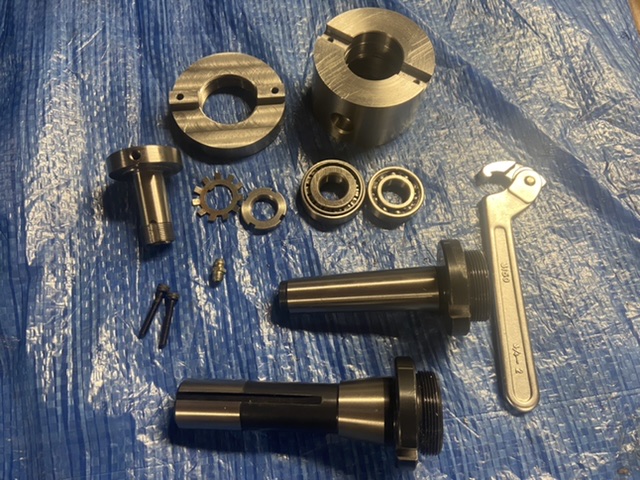

Material and purchased items
Attachment 34124

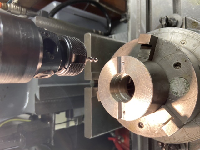

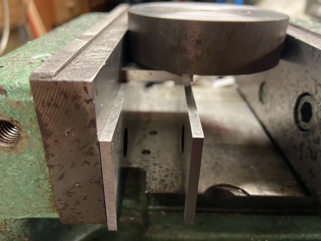

centring work piece
Attachment 34125

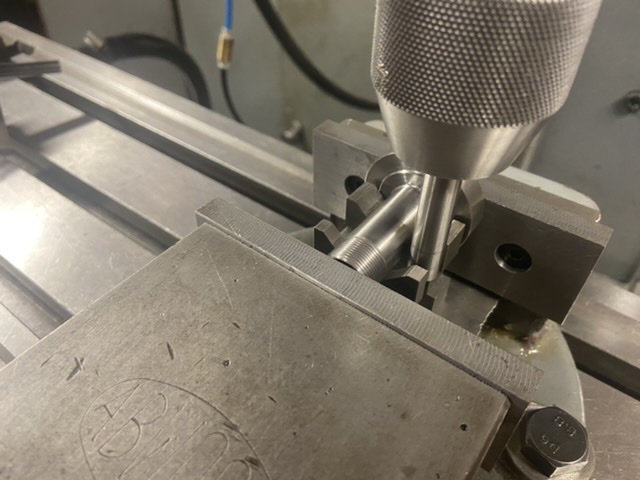

Main body set at 1 degree
Attachment 34126

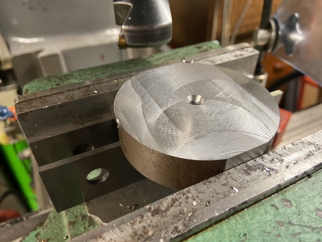

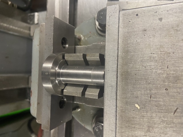

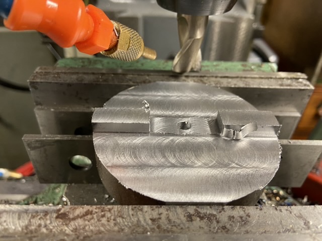

machining location tongue
Attachment 34128

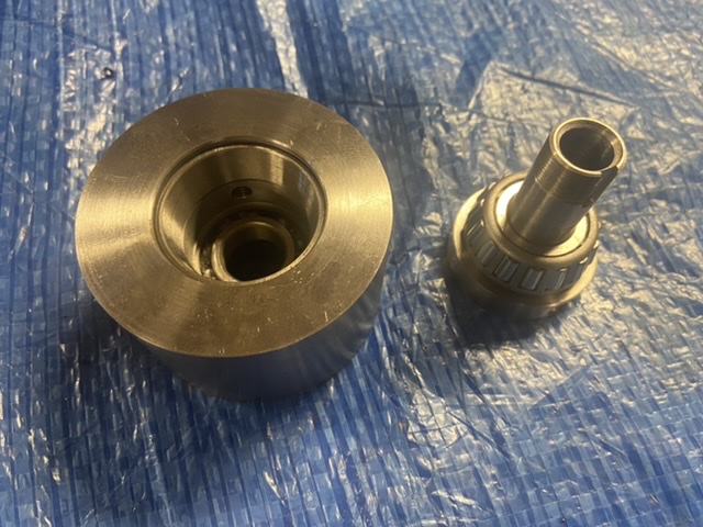

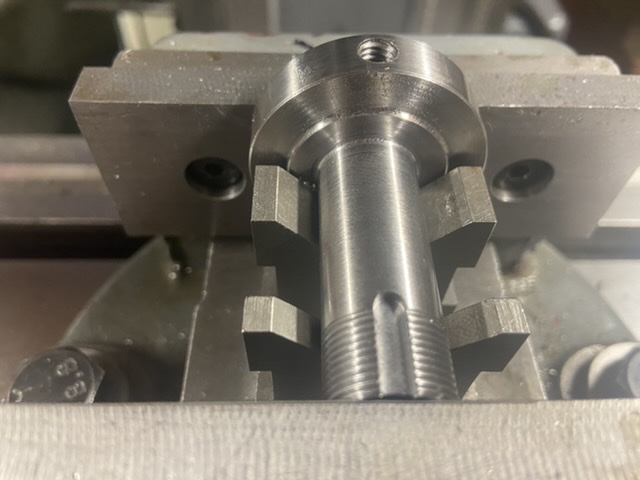

Tool shaft
Attachment 34132

Truing the outer body in the lathe so this runs concentric to the main spindle. The internal bearings and tool shaft maintain the 1degree angle to allow too to oscillate.

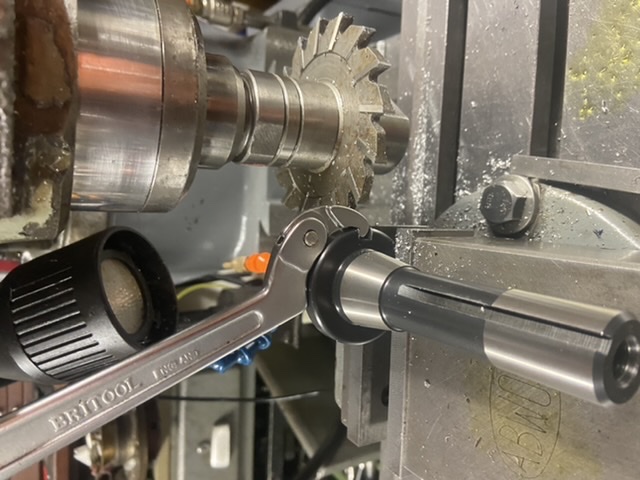

machining shanks for c-spanner
https://www.homemadetools.net/forum/...0-d7bf35bf4153
Shaft screw cut for purchased bearing locking nut.
Attachment 34144
Internal shaft thread and machined to accept locking tab washer.

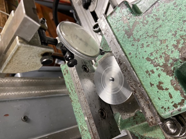

The thin bee-blocks make it easy to clock to find the centre. Link to vee-blocks https://www.homemadetools.net/forum/...649#post107979
Attachment 34129

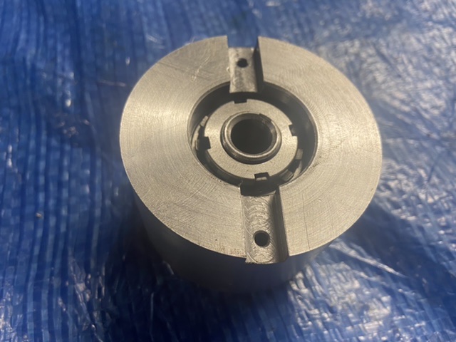

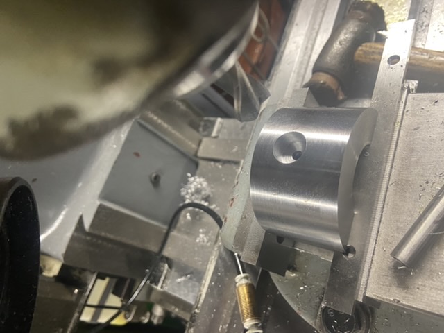

grease hole for bearings sunken in to body to avoid nipple protruding outer body.
Attachment 34135
completed parts ready for assembly
Attachment 34136
Attachment 34137
Attachment 34138
Completed body
Attachment 34139

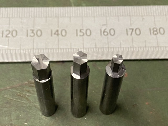

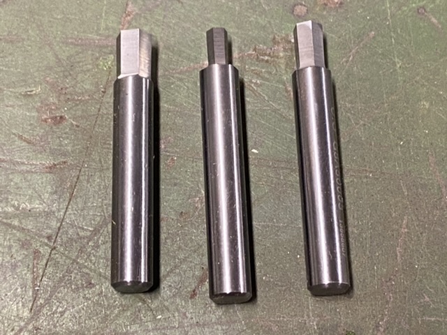

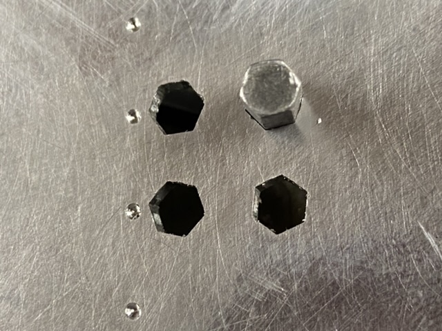

Cutting tools from old slot drills
Attachment 34140
Attachment 34141

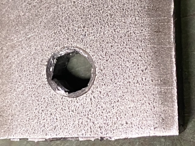

3/16” hexagon in steel
Attachment 34142
Aluminium
