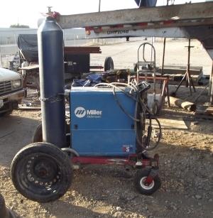

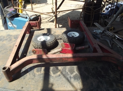

my little Miller 210 mig welder has been suffering from a gravel floor for far too long
very difficult to move around on the factory wheel kit
So I dug a few items out of my classed for reuse pile of scrap and made a cart that can be moved around very easy.
I started out with the front frame of a Toro walk behind mower
Attachment 4703

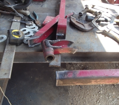

First up modify the frame work
Attachment 4704

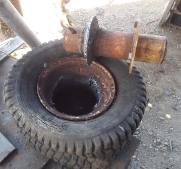

Next cut the hubs out of the rear tires
Attachment 4705
then lengthen the forks for larger tires
Attachment 4706

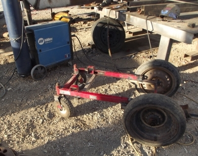

he modified assembled cart frame
Attachment 4707
I managed to make 2 hubs out of 1 so this gave me 4 hubs
2 of these will be used on my torch cart later this week

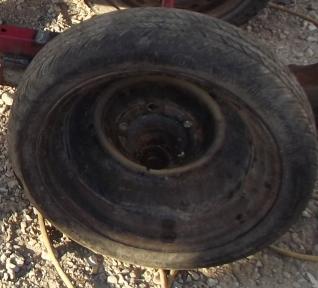

here I have just welded the hub into the center of a doughnut spare tire these can be bought for next to nothing but I had 2 the same size just laying around
Attachment 4708

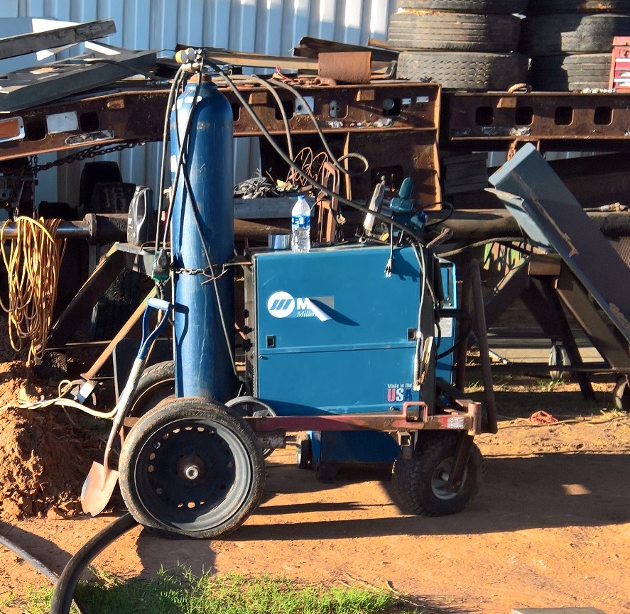

the finished cart may never win any beauty contests but it is very functional
