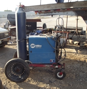

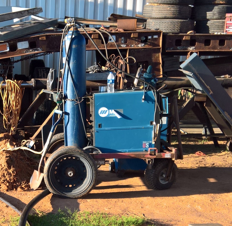

    my little Miller 210 mig welder has been suffering from a gravel floor for far too long
    very difficult to move around on the factory wheel kit
    So I dug a few items out of my classed for reuse pile of scrap and made a cart that can be moved around very easy.

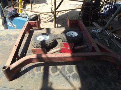

    I started out with the front frame of a Toro walk behind mower

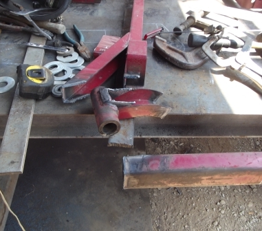

    First up modify the frame work

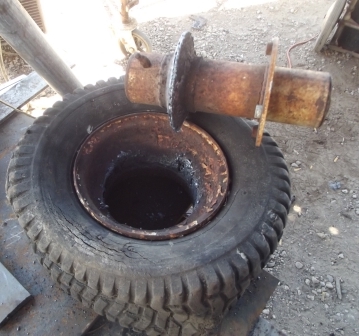

    Next cut the hubs out of the rear tires

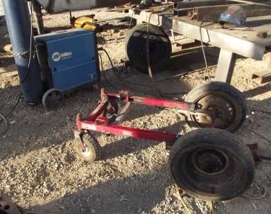

    then lengthen the forks for larger tires
    he modified assembled cart frame
    I managed to make 2 hubs out of 1 so this gave me 4 hubs
    2 of these will be used on my torch cart later this week

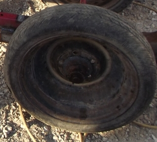

    here I have just welded the hub into the center of a doughnut spare tire these can be bought for next to nothing but I had 2 the same size just laying around
    the finished cart may never win any beauty contests but it is very functional

    One thing is for sure it rolls easy.
    Later I plan on adding a shelf on the back with some bottle supports to add one of my cutting rigs to it this way I will have both welder and torch at hand at all times. I have 2 or 3 sets of bottles gauges hoses and torches that I am not using just now anyway

    A few years ago I modified the cart to a 3 wheeled design with a steerable pull handle removing the front casters as they had a tendency to go the direction they wanted but not both in the same direction I have a golf cart tire for the front wheel now and it is so much easier to move around
