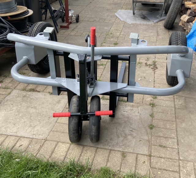

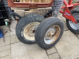

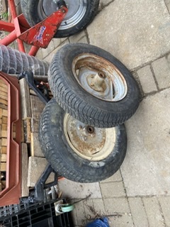

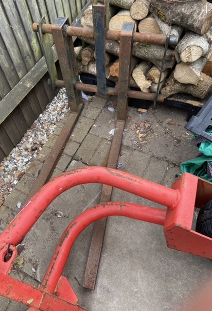

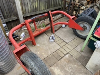

    I was fortunate to buy two Rough terrain pallet trucks at auction for £22. Admittedly they were not in great shape but there was enough between the two to make one good one. So took a chance.
    The first thing was to get them home as the are quiet heavy and large but luckily they just fitted in my van with help of a skilled forklift driver. Next issue would be to unload at home. Using an engine hoist was able to lift them out (eventually )
    Then stripped both down and my gamble paid off there was all the bits needed to make a complete one.

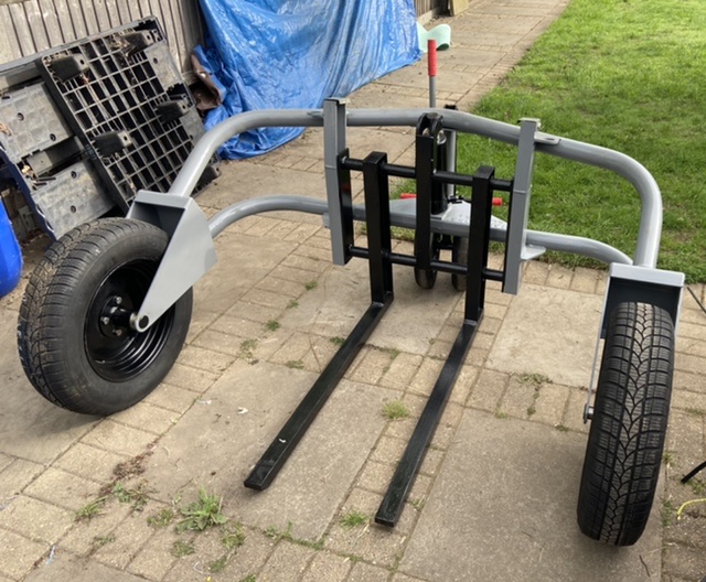

    set to work on cleaning all the bits for painting and overhauled the hydraulic ram fitted new tyres and the rough terrain pallet truck was back in action.
    I then couldn’t bring myself to scrap the remaining bits so placed on a well known auction site and sold them for £60.
    The photos below show the condition of the items bought at auction.
    Rough terrain pallet truck.-93ff2067-e762-425e-8c47-d37ac83a5c7a.jpeg Rough terrain pallet truck.-4dd0596f-cccc-4b55-bc26-2994bd2b335f.jpeg Rough terrain pallet truck.-c9f42116-438d-4616-a3ad-bb9e1d0e4ab5.jpeg
    Finished in battleship grey.
    Rough terrain pallet truck.-ebffe002-b82b-414b-8848-0125eee77806.jpeg Rough terrain pallet truck.-aef82332-596d-43bb-beef-bdd7c3a9d575.jpeg
    Really pleased with the result and has been a real asset for moving pallets of fire wood up and down the garden.
