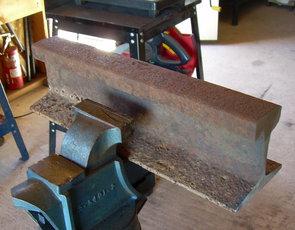

    As mentioned in another RR anvil thread, a few years ago while filling in a old homestead basement dugout I found a 7 1/2' piece of rail, I had thought of making an RR anvil so this was perfect. After collecting more rust for a couple years I finally utilized a 1.5' to build a double horn anvil for light work. The first picture is were I started.
Name:	7 Anvil rail section.jpg

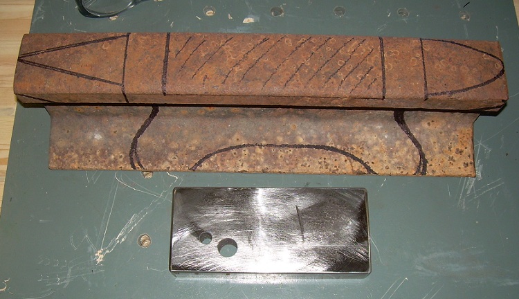

    In this picture I have done a rough mark-up for a guide and I made up a face of 1" thick tool steel to add weight and size to the working face.
Name:	13 Markup and face.jpg

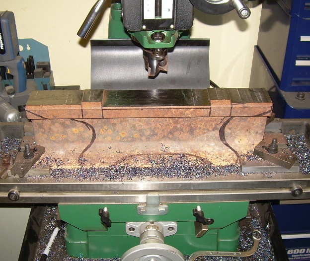

    Here I faced off the top surfaces on my mill/drill.
Name:	15 Milled Top.jpg

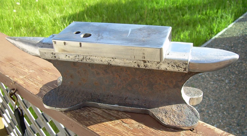

    Here the horns have been refined, ready to heat treat the face and weld it up.
Name:	27 Almost There.jpg

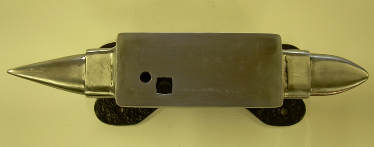

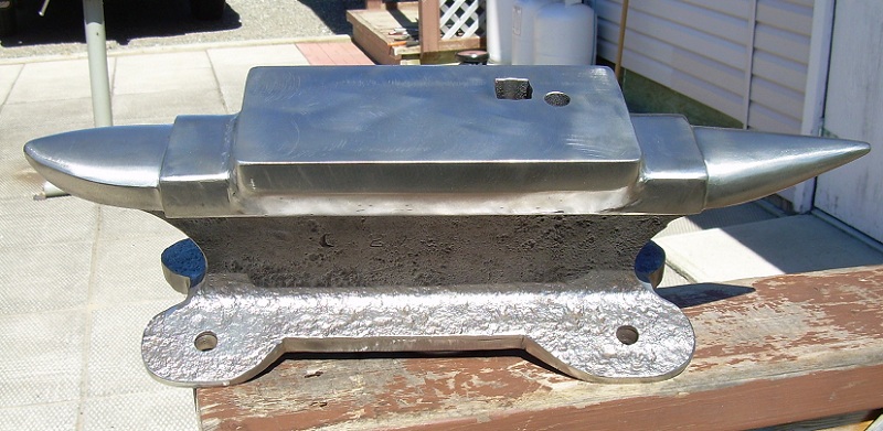

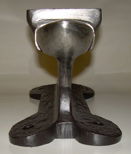

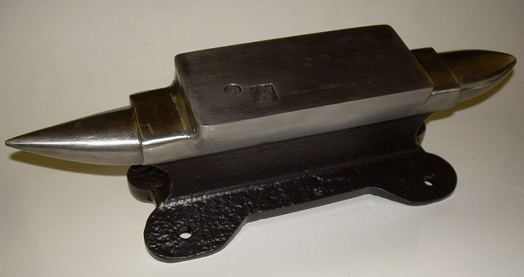

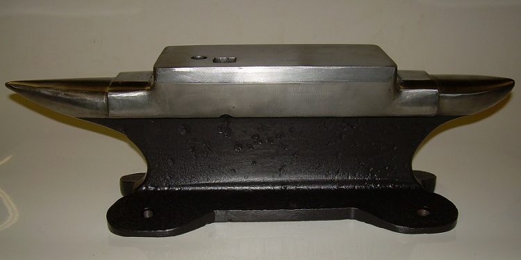

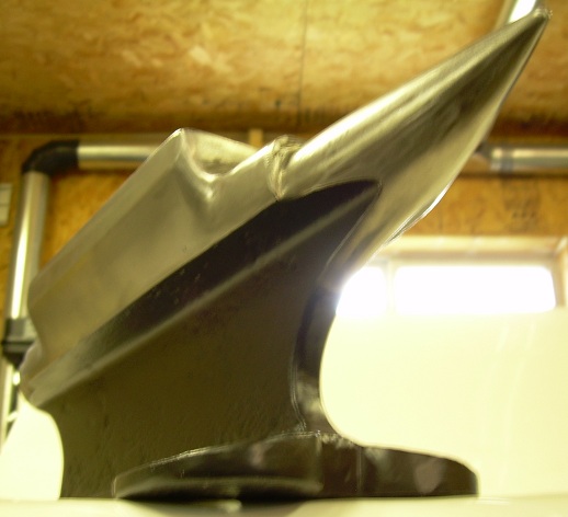

    All finished, the paint is two coats of high heat Tremclad flat enamel. Here are the finished pictures.

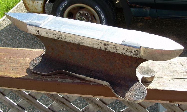

    The anvil has a nice clear ring to it. Should do me well for the light work I intend to do on it. There are more pictures and full build documentation on my site at the address in my signature.
