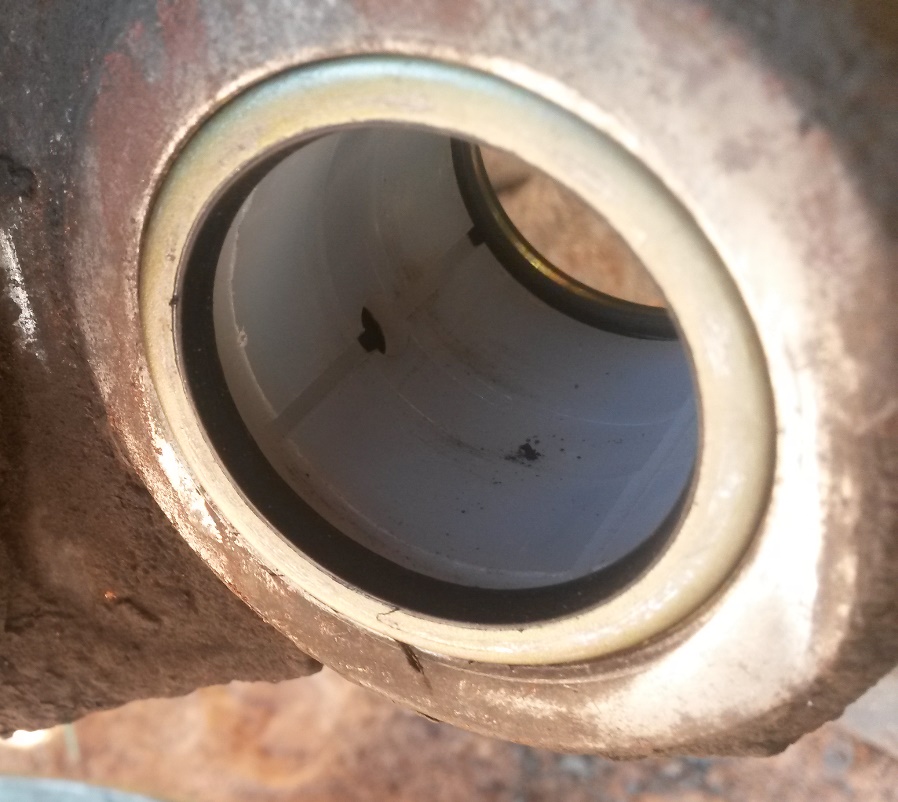

Working on a semi trailer there are always a few special tools that help to make a job easier.
I either couldn't find the one I had made previously or quite possibly re made it into something else.

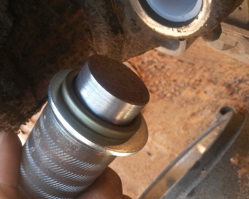

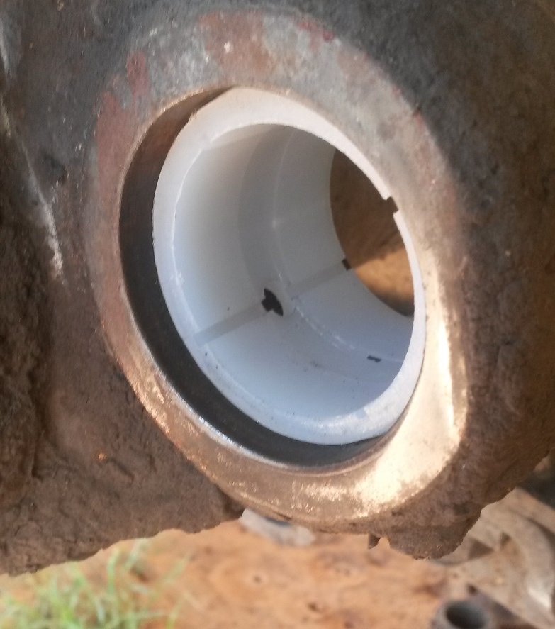

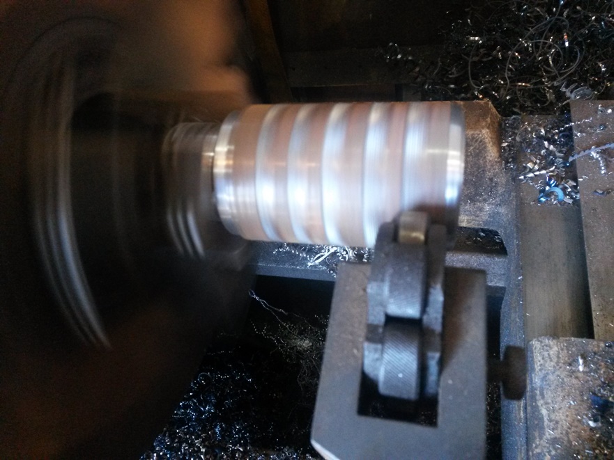

So I made another the solid cylinder was already about 4 inches long and 1.75" in diameter do all I had to do was turn it down with 2 steps one to serve as the pilot for the bushing the other as a depth gauge
Attachment 25538
Attachment 25539
Attachment 25540

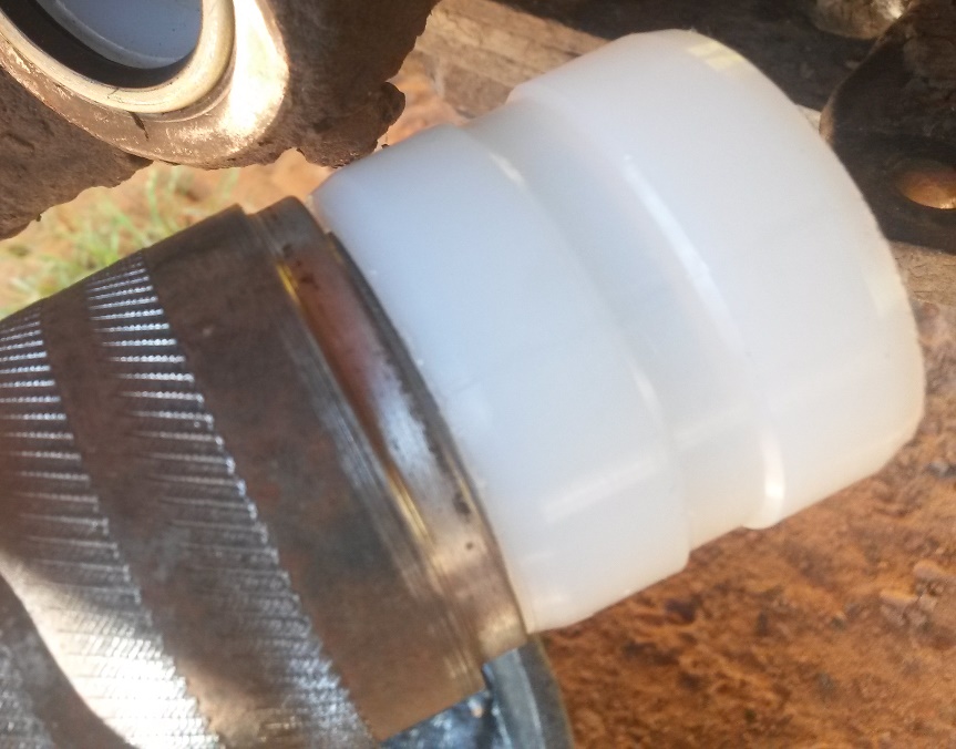

Ass a washer and now it can install the seals
Attachment 25541
Attachment 25542
