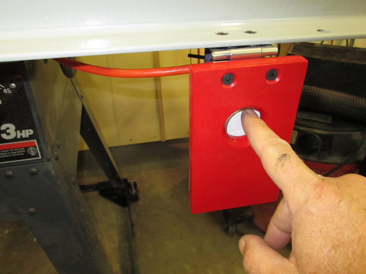

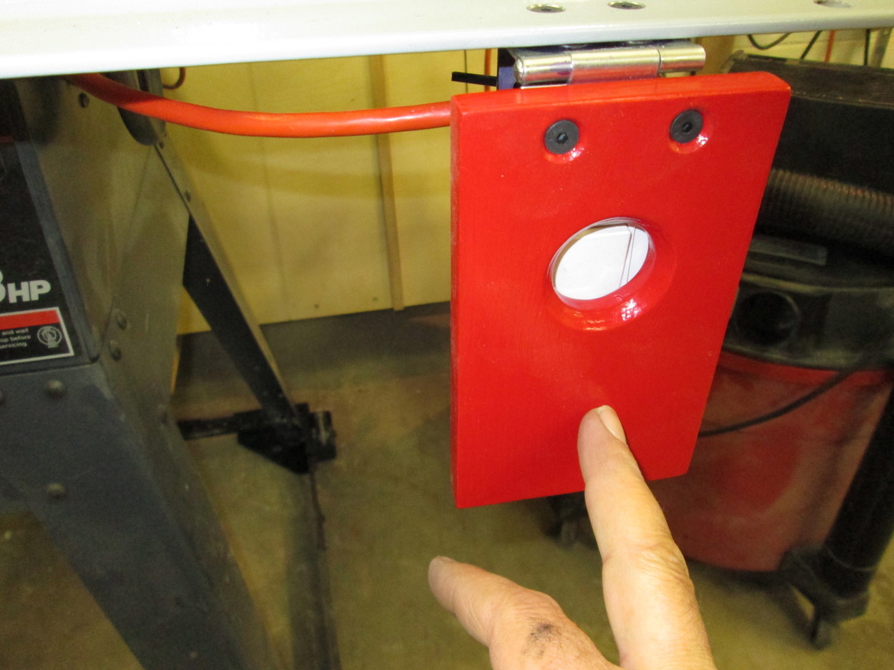

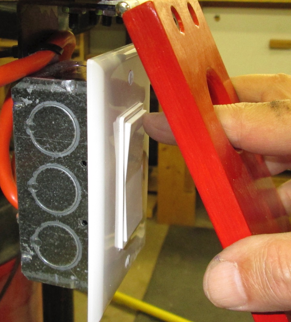

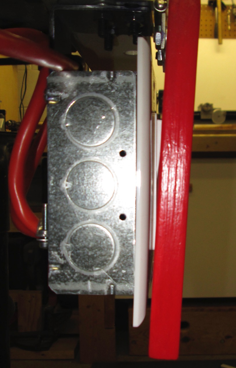

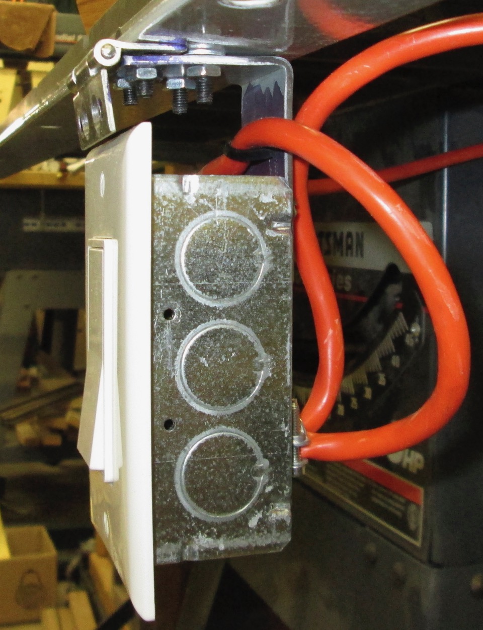

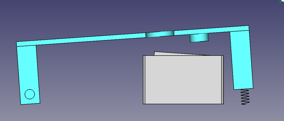

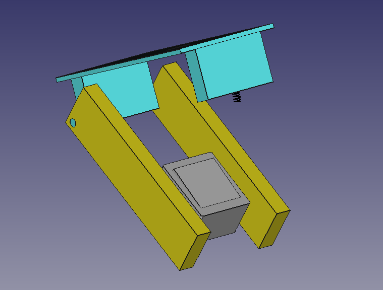

Here is my proposal for an effective safety switch that can easily be made, based on a standard commercial wall rocker switch.
Here it is, nothing fancy, not a master piece of woodworking, but it actually works pretty well :)
