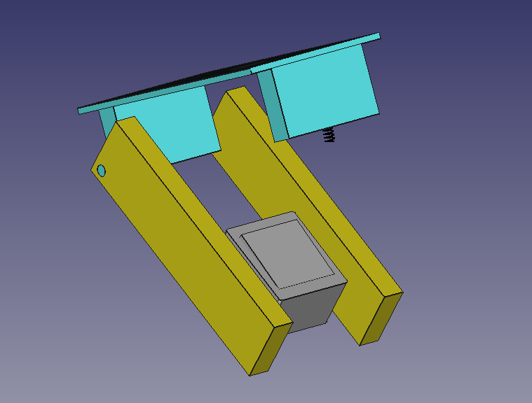

    Here is my proposal for an effective safety switch that can easily be made, based on a standard commercial wall rocker switch.
    Here it is, nothing fancy, not a master piece of woodworking, but it actually works pretty well
    Cheers !
    Christophe

    Hi Christophe, nice one thanks. Want to see and know the trick a tad more please.

    My version:
    I need to add a spring like Christophe did since mine will occasionally turn itself off if there is too much vibration in the saw.
    The box, switch and hinge are readily available at the big box stores or any hardware store. The paddle is just a scrap of wood with a hole drilled through it.
    You might need to add a small block to contact the "Off" side of the switch if your hinge isn't just right

    Hi Chy,
    Given the very detailed level of explanation you provided for your VFD, shame on me to be so poor on this one.
    I spent some time to do a 3D model, here are the pictures :

    Good morning Christophe, thank you so much for you illustration, it tell perfect!
