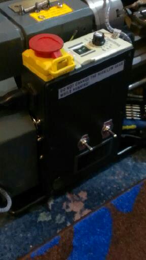

Having tried my new layout it worked but the newly added Tacho was now awkward to read.
ORIGINAL DESIGN:-
Attachment 19848,

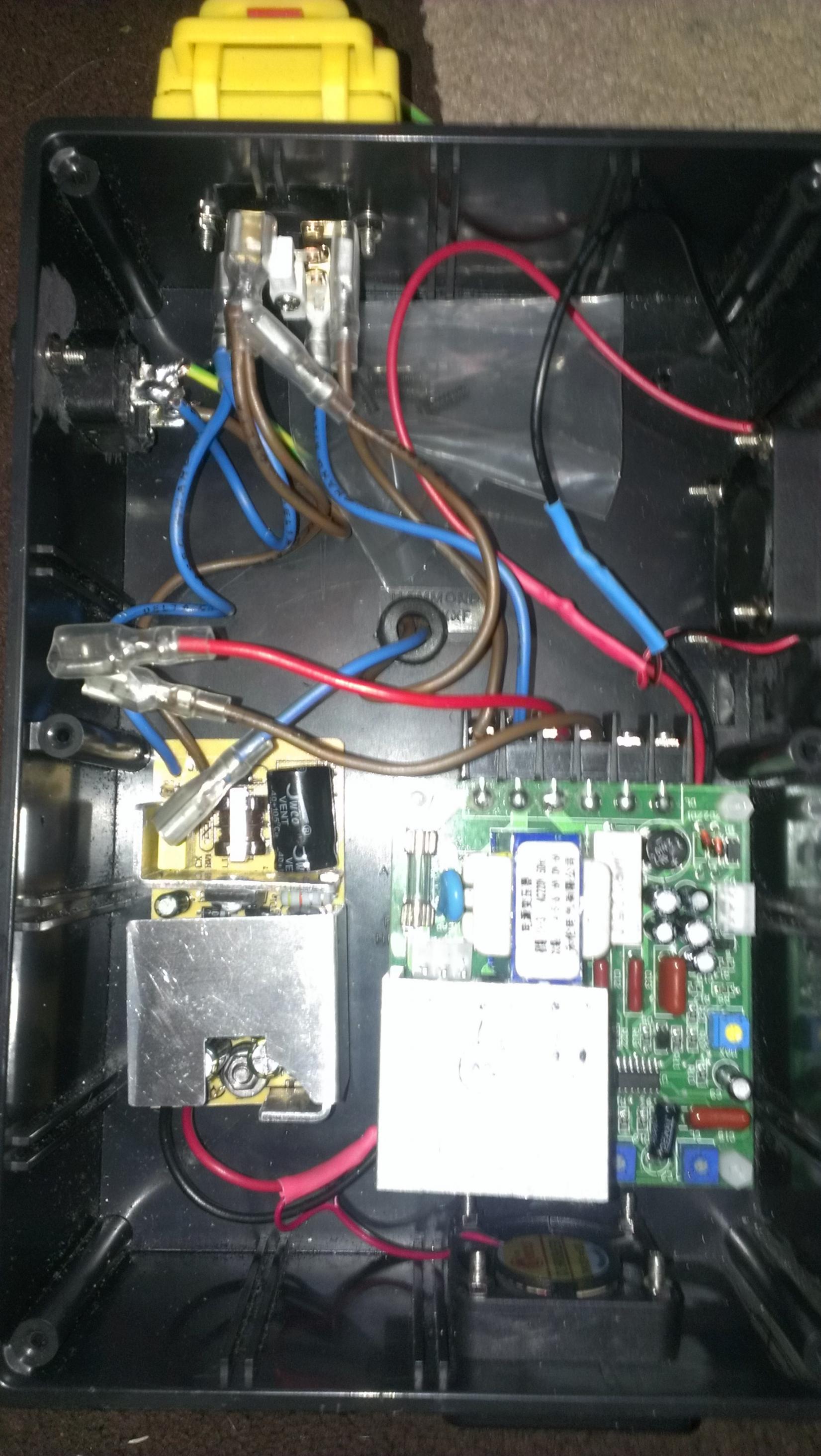

Time to redesign! I bought a second set of parts :- control box , Thump switch (emergency lock out ) Toggle switches, Tacho panel, Fans , 240Vac to 12VDC wall wart and chinese speed controller.
The first thing was to strip the P.C. board from the wall wart (power for the tacho & fans ) & did the same to the new chinese speed controller. the idea being that the control pot & on/off switch with their Bezel/face plate can be mounted remotely from the PCB allowing greater flexibility to the layout within the box.
Attachment 19845,
The LH lower cct board is the "wall wart" innards and the RH cct board is the Chinese speed controller
The speed controler board has a huge heat sink on it and since it now sat in a far larger but fully sealed case, I added two 40mm fans one mounted directly under the heat sink (when the box is mounted vertically on the lathe ) in the base of the box sucking cool air in, the second fan is almost on the top of the right hand side blows the warm air out.
Having done all that I am now far happier with the layout. (PHOTO'S to Follow ):-

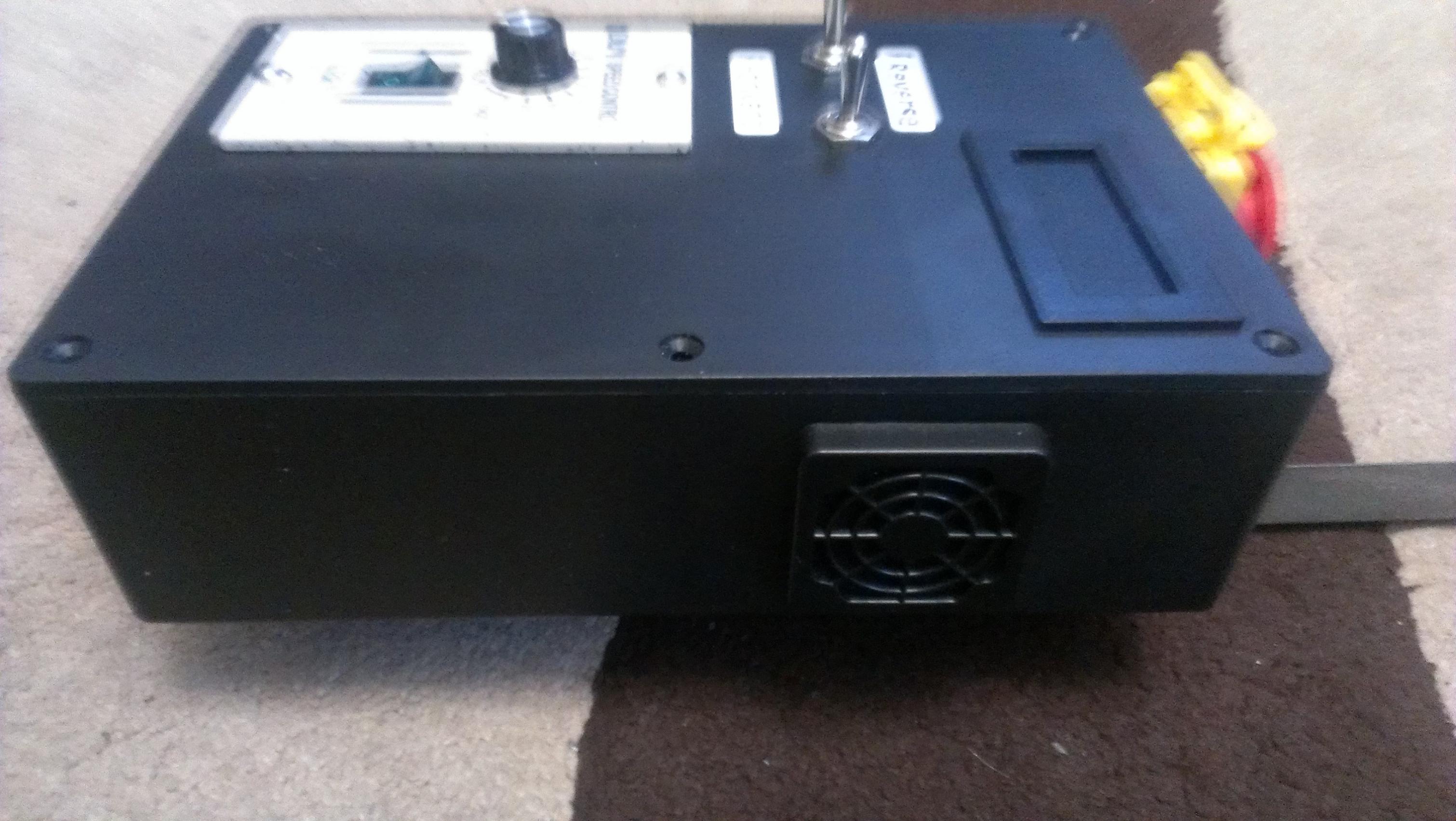

Attachment 19844,
RH side exhaust fan

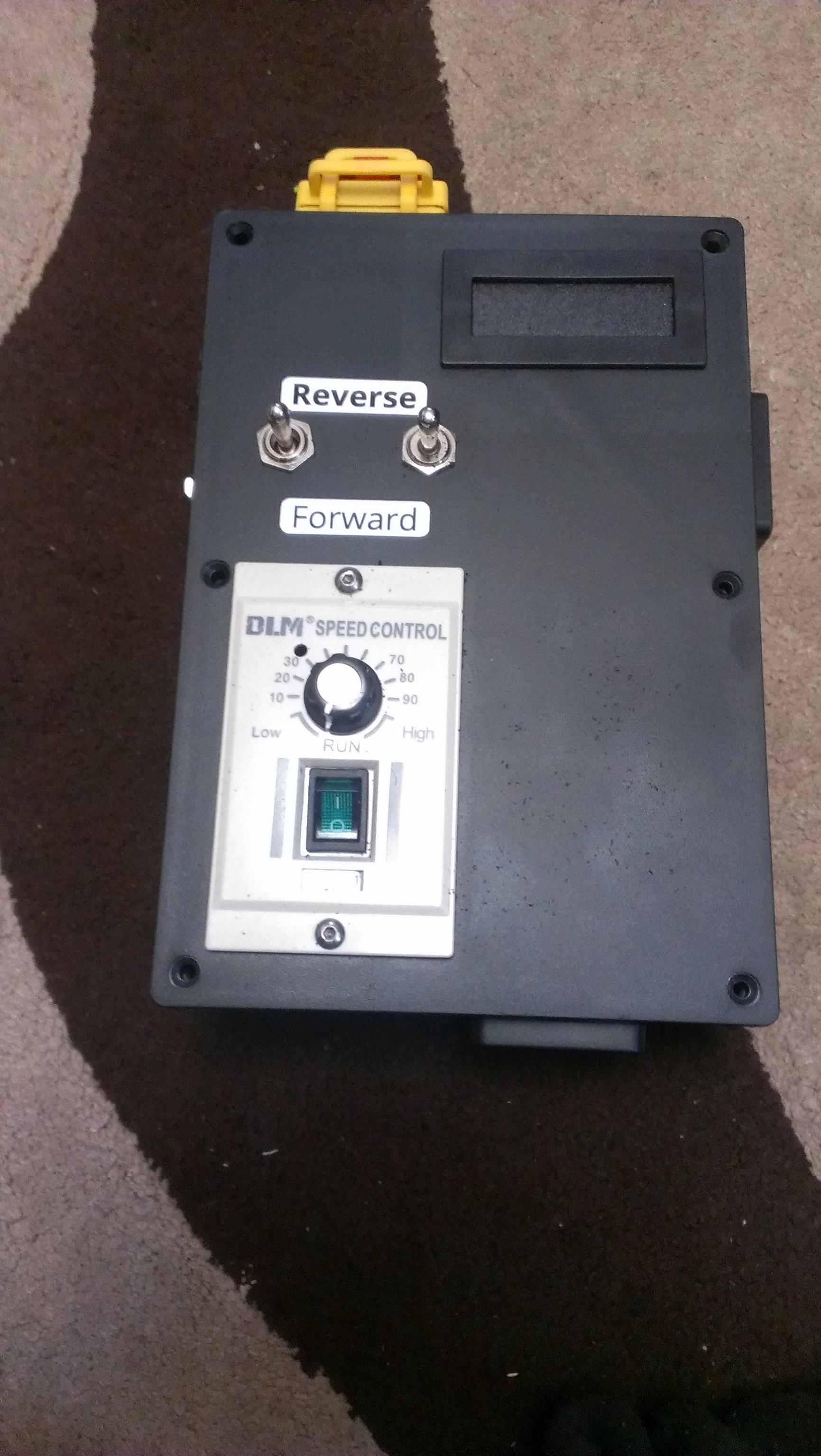

Attachment 19846,
Front facia layout (also shows the lower inlet fan filter in place )

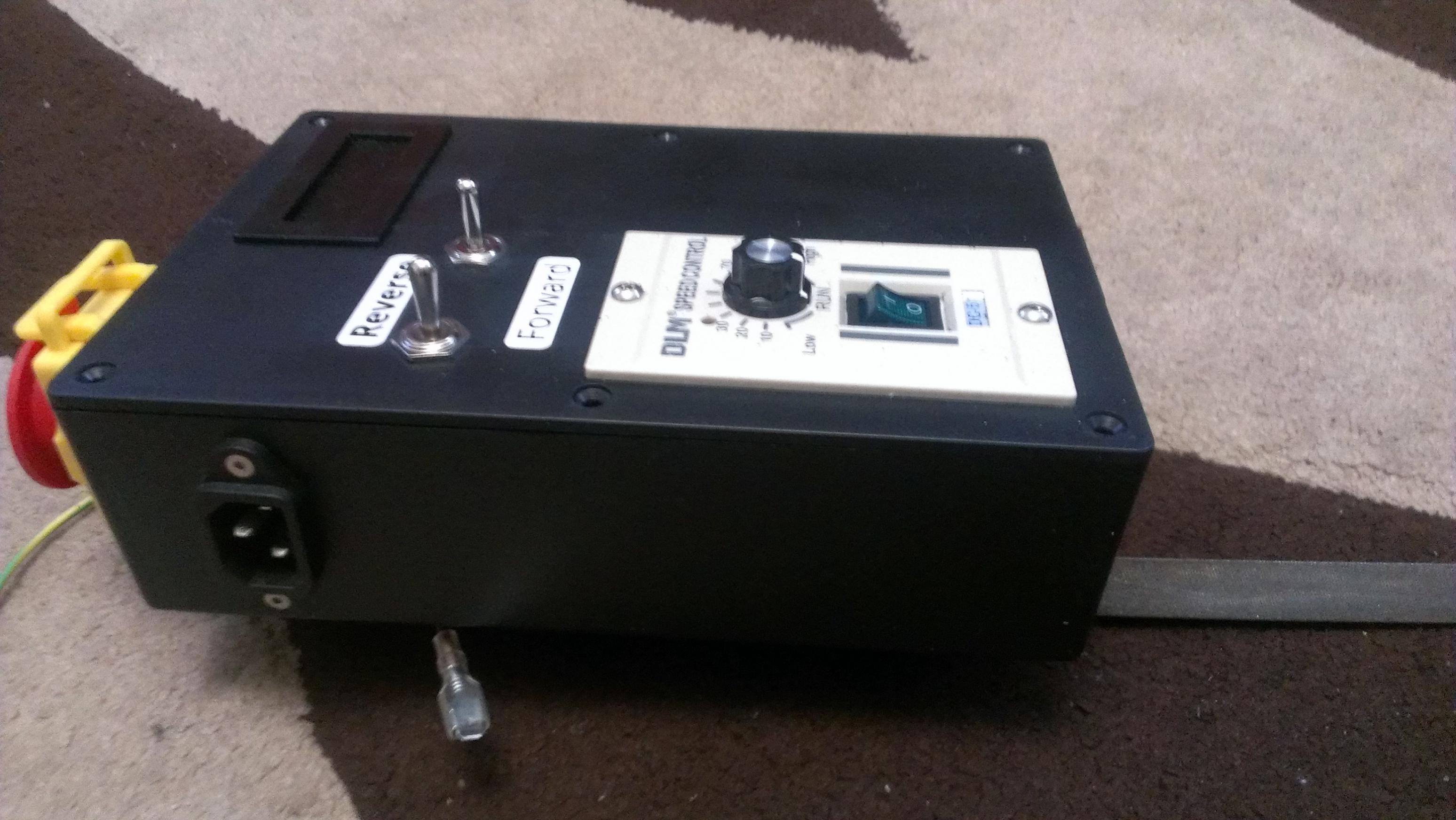

Attachment 19847
LH side mains input for "kettle lead "
