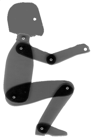

I recently had the need to physically model an hypothetical piece of furniture to a 1/10th scale.
I thought it would be nice to add to the scene a scaled human body, of average size.
I searched the internet for a CAD model or something that could be cut easily and found nothing convenient.
Then I remembered that old woodworking book I had, and found in it a drawing I decided to start from.
I decided to share that with you and I will offer the files for downloading.
First step was to scan, then to vectorize the raster image, I usually do that with Inkscape.
It represents a man sitting in a chair.
https://www.labellenote.fr/file/Wood...humain_SVG.png
==> Link to the inkscape file.
Credit : "Guide du bois, de la Menuiserie et de l'Ebenisterie", by Albert Jackon and David Day.

And here is the result :
Cut parts still linked together :
https://www.labellenote.fr/file/Wood...umain_0001.jpg
Once separated they are assembled using 3mm rivets (the ones for assembling leather, only one side used, the fit is tight enough to hold the parts correctly)
https://www.labellenote.fr/file/Wood...umain_0002.jpg
