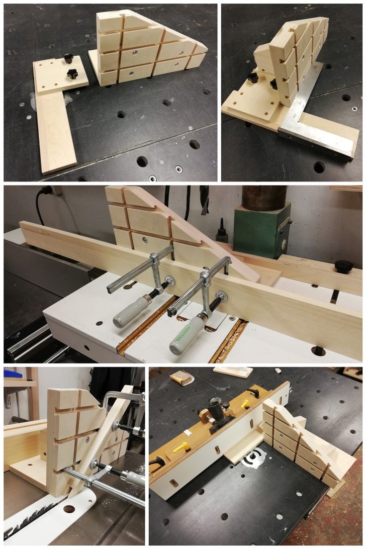

    At 3.40, I glimpsed a router template assembly behind you, to your right. May we have a picture of that, please?

    Lot of jigs behind me at 3.40 (or starting at 3.42) but only one to my right, should be the one in the picture below?. Started out as a clamping jig for drilling operations but is really useful on the router table as well as the table saw. The one lower down, visible up until 3.40 is a flattening (and juice groove) jig for cutting boards, if it's that one you mean I can take a picture of it.
