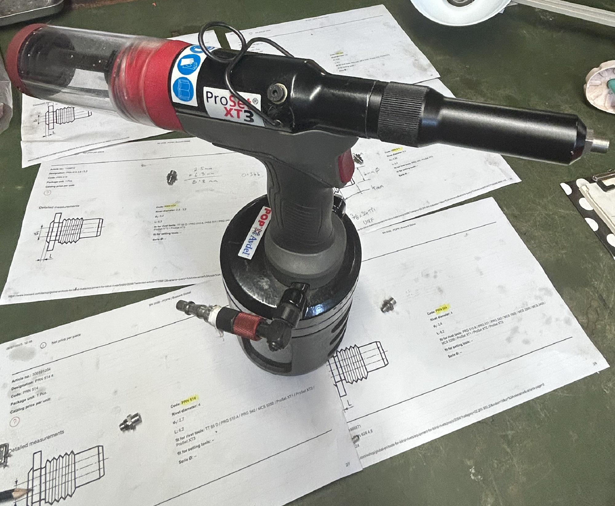

I recently picked up a bargain off eBay. An ex demonstration ProSet XT3 pneumatic Rivet tool for £50. Unfortunately it only had one nose piece for 6mm diameter pop rivets. Before making the purchase i researched the cost of the spares. So not a problem I thought :headshake: just buy the spares at £3.50 each plus postage.

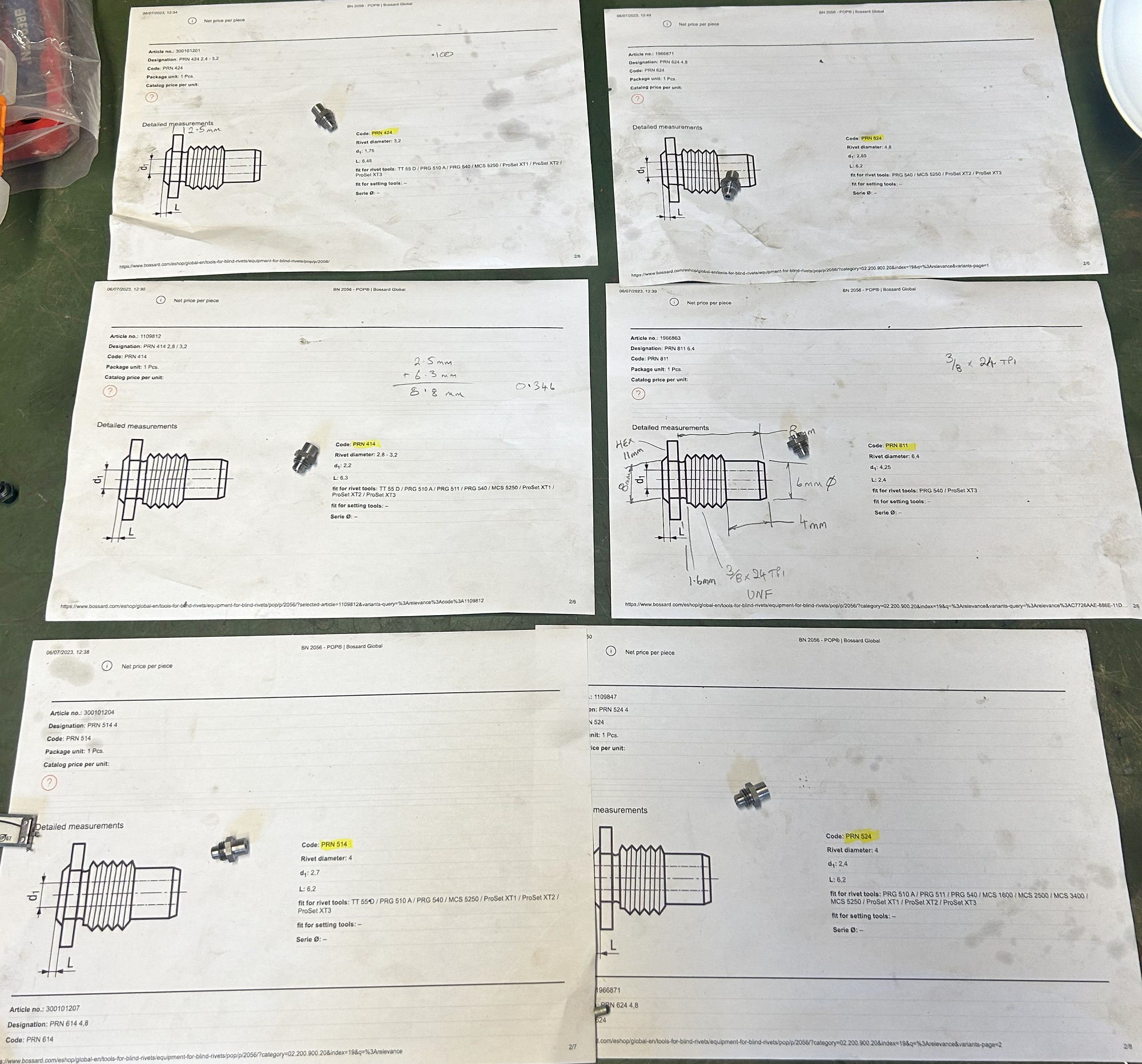

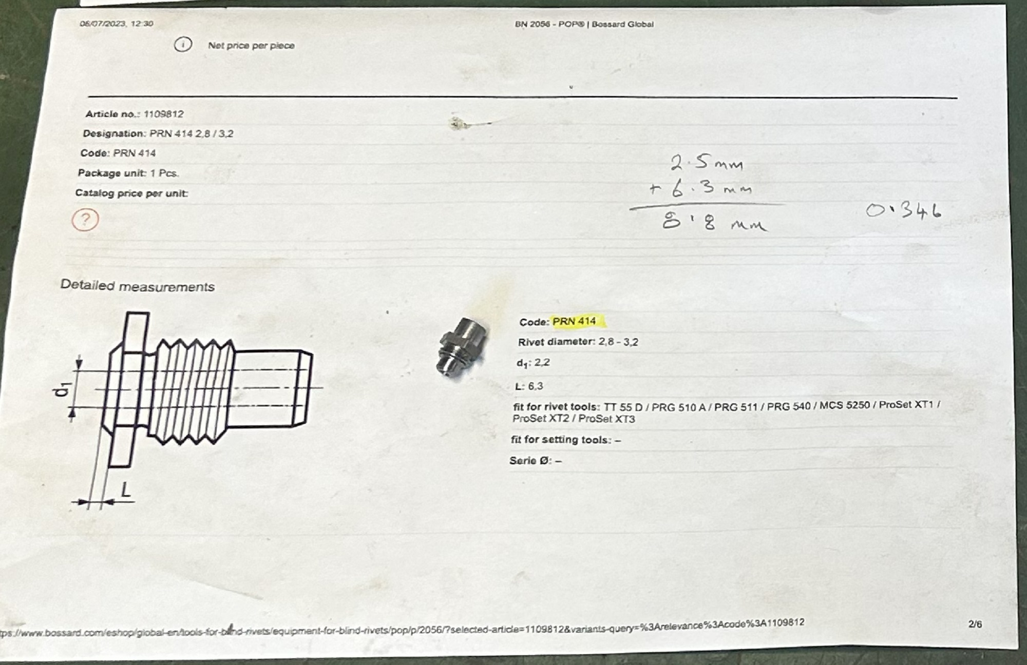

Contacted three or four Stanley agents for price even one in America and no reply. So was a bit disappointed. But never mind I thought I will make them. To my surprise there was a link to the dimensions I needed to make the nose pieces for an XT3.

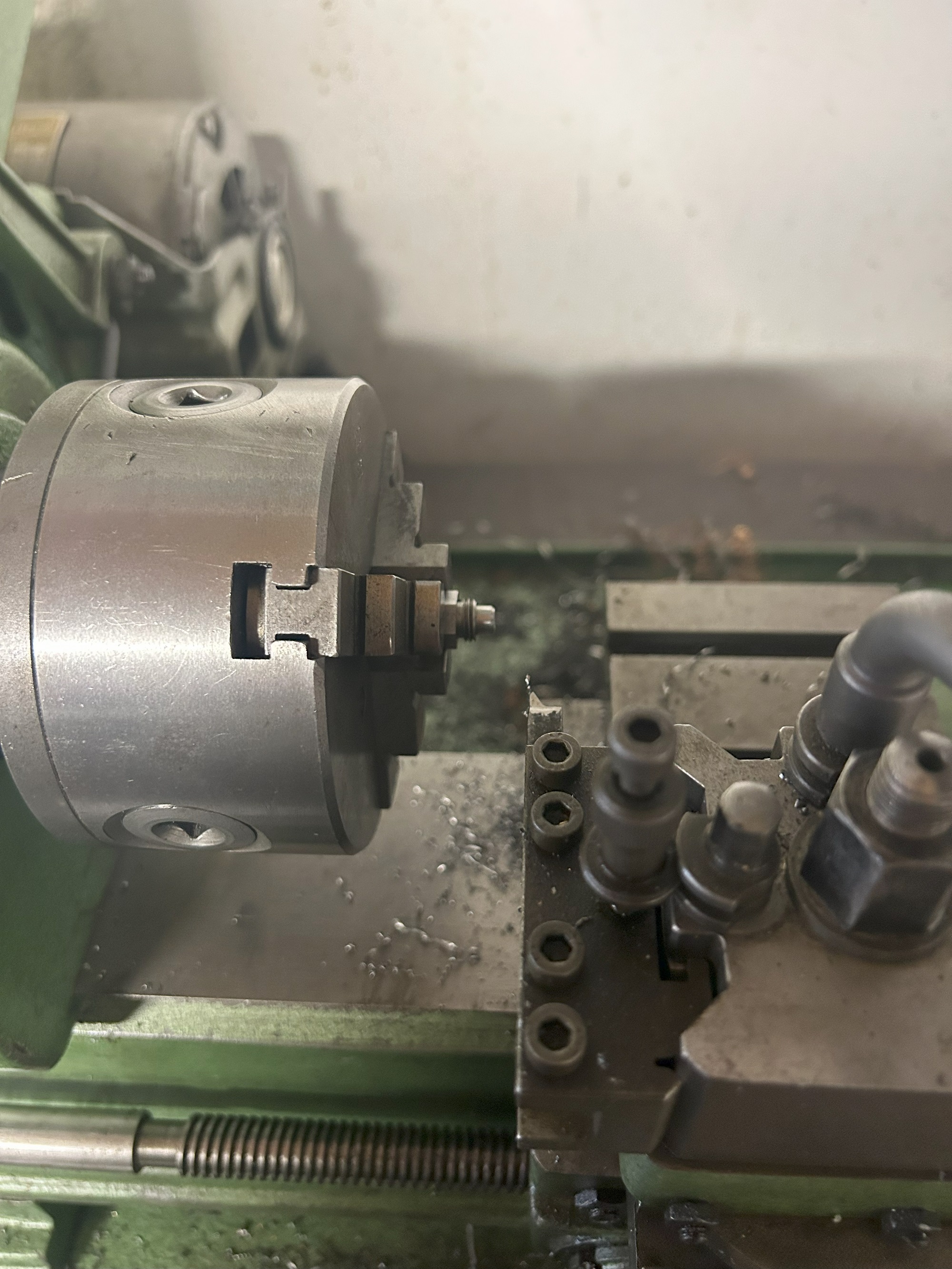

The thread was measured and found to be a UNF 3/8 x 24 TPI. So the gear train was setup and the nose pieces made.
To cut the thread I used the manual screw cutting method I shared a while back. Link to original post:
https://www.homemadetools.net/forum/...ing-hand-84512

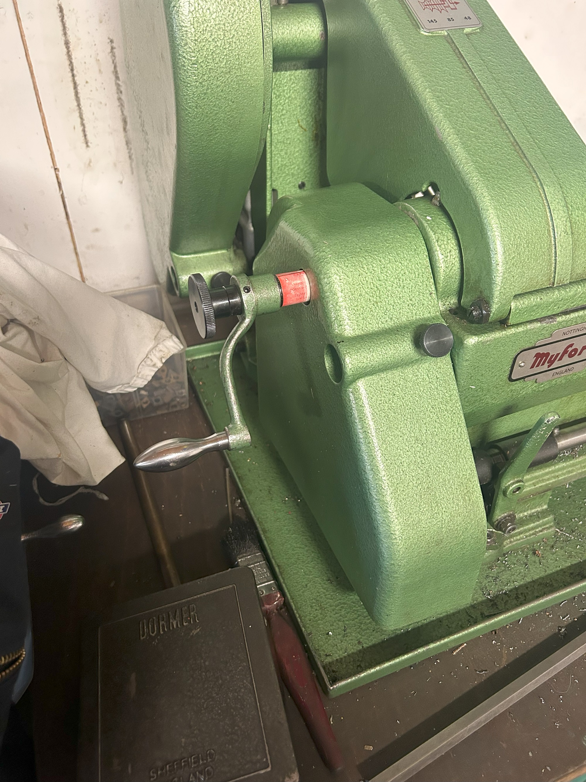

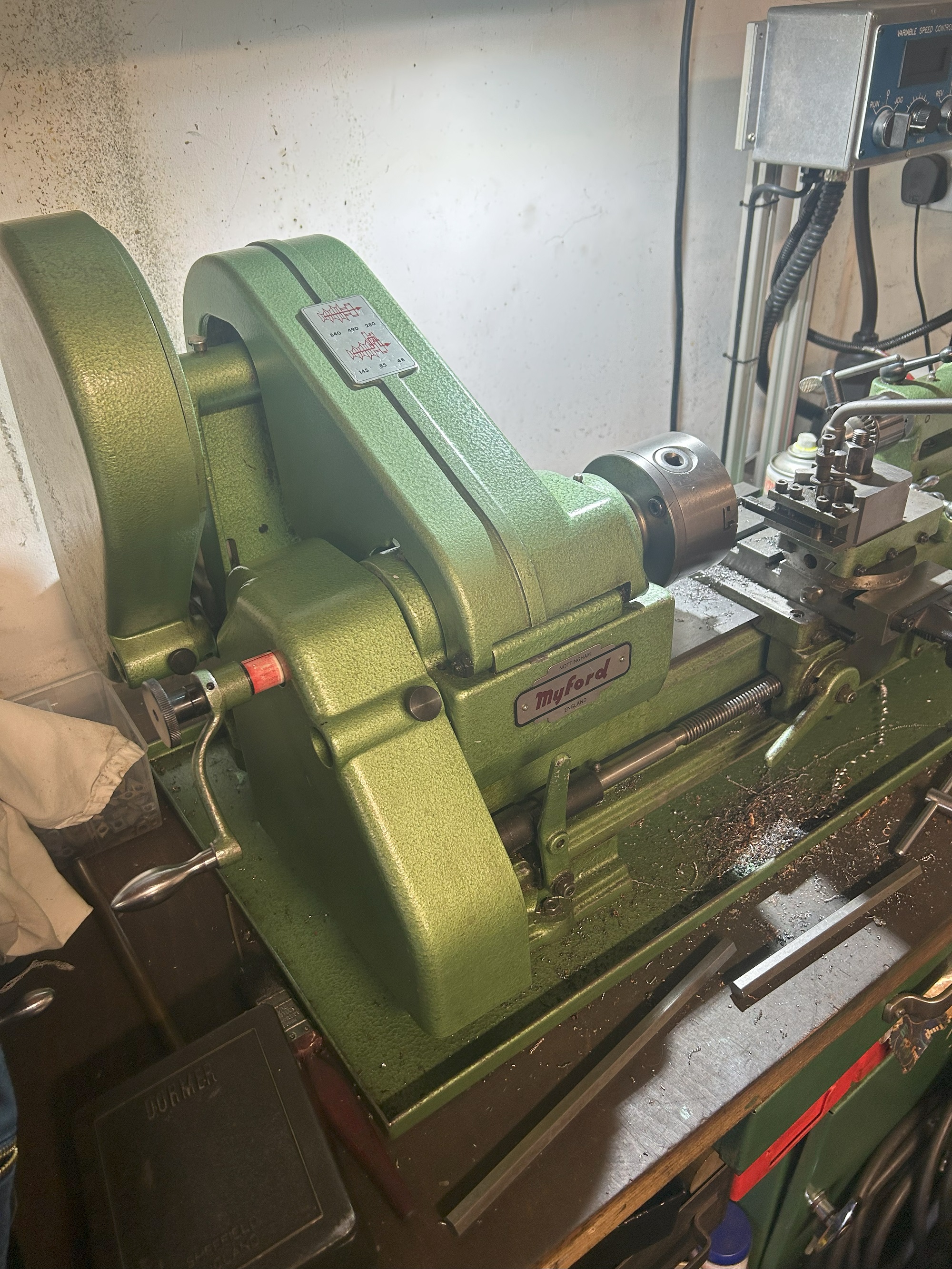

As the thread only had a narrow undercut for the tool to drop into, using the crank handle gives plenty of control when stopping in such a small undercut.
The photos below show the setup:
Attachment 45754 Attachment 45755 Crank handle located in headstock spindle bore.
Attachment 45760Screw cutting up to a shoulder into a narrow undercut. This is very easy and controlled without having the machine under power.

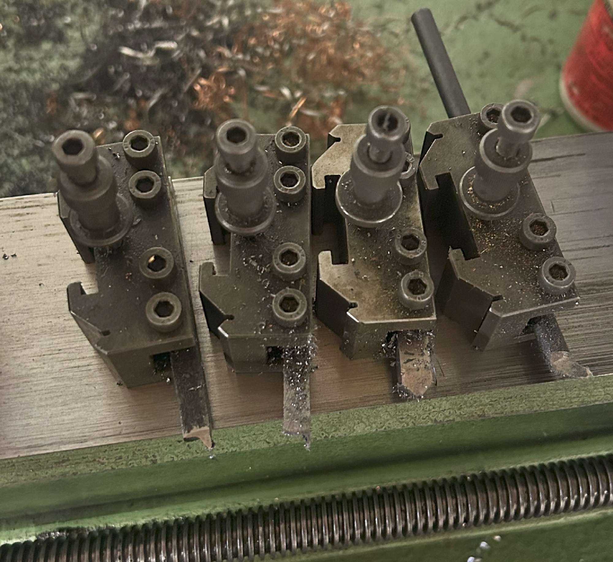

Attachment 45761 Tools used to make component
Attachment 45756 Attachment 45757 Drawings printed off and all other dimension taken from original nose piece.

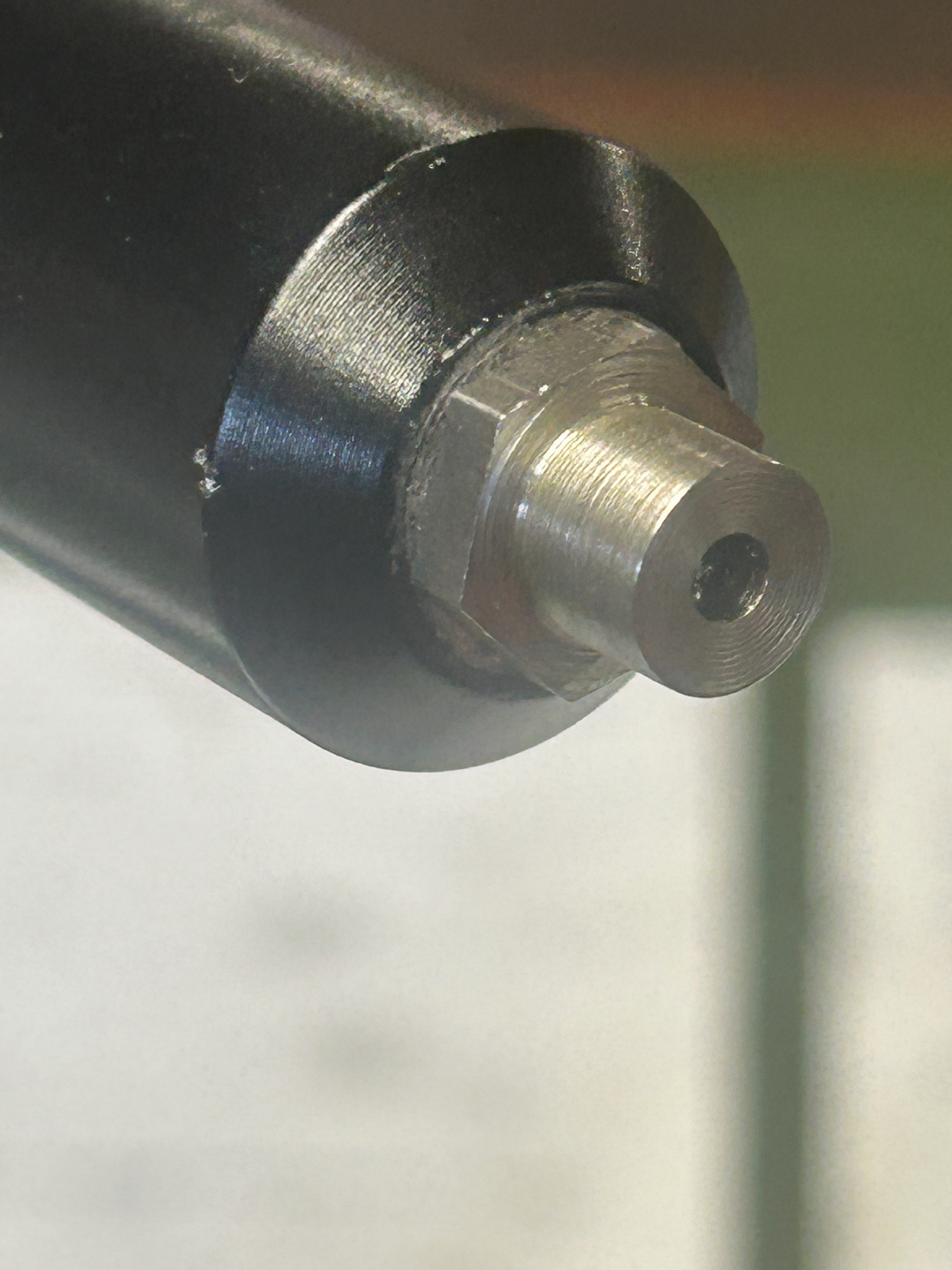

Attachment 45758 Homemade nose piece
Attachment 45759 ProSet XT3 can set 4mm (5/32") to 6.4mm (1/4") rivets
