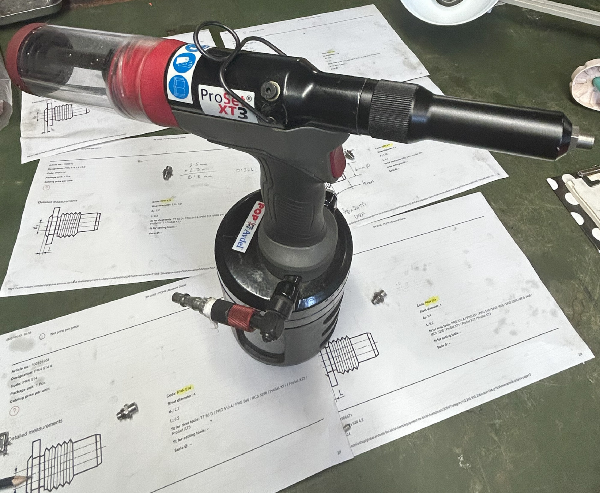

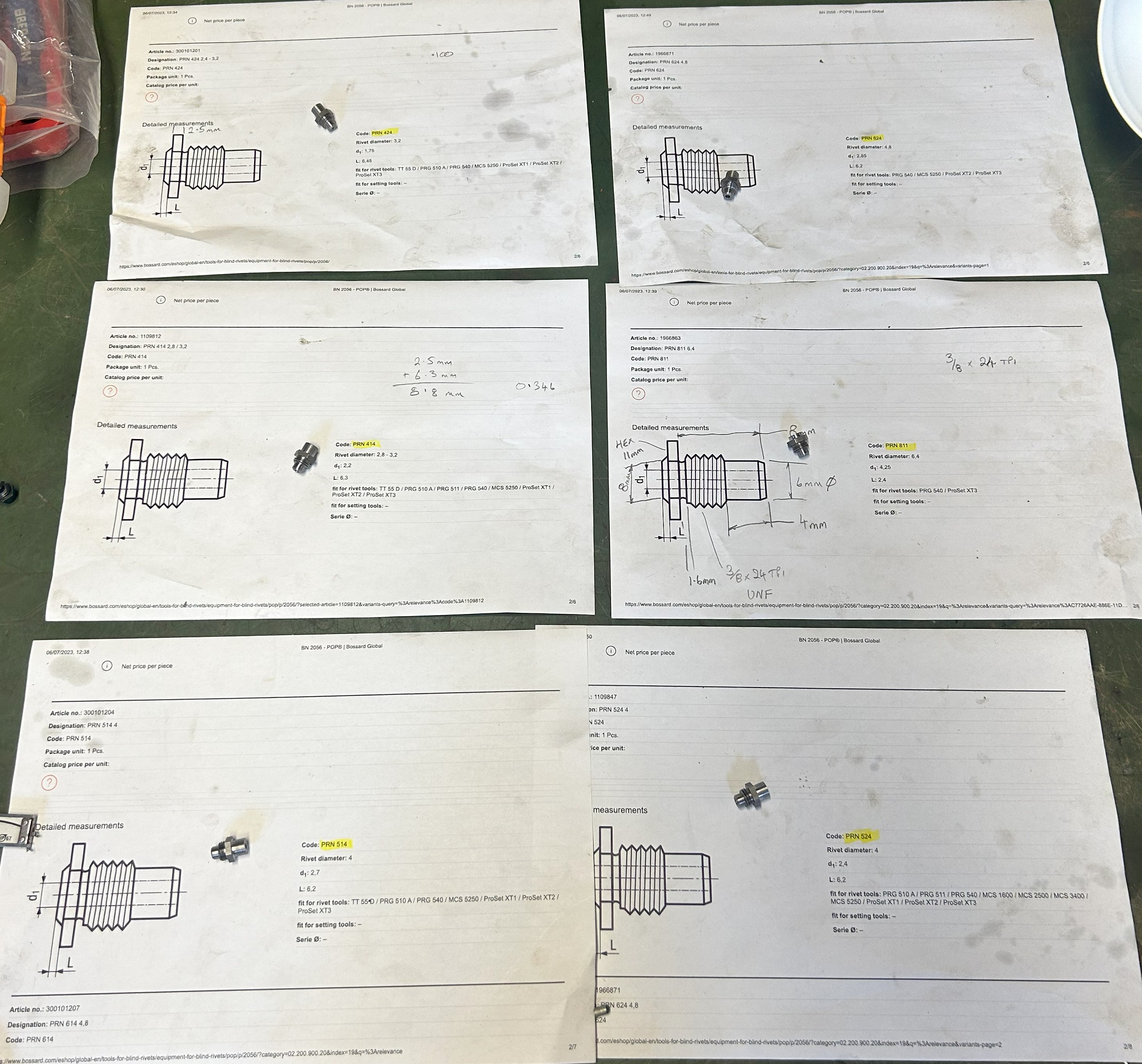

    I recently picked up a bargain off eBay. An ex demonstration ProSet XT3 pneumatic Rivet tool for £50. Unfortunately it only had one nose piece for 6mm diameter pop rivets. Before making the purchase i researched the cost of the spares. So not a problem I thought just buy the spares at £3.50 each plus postage.

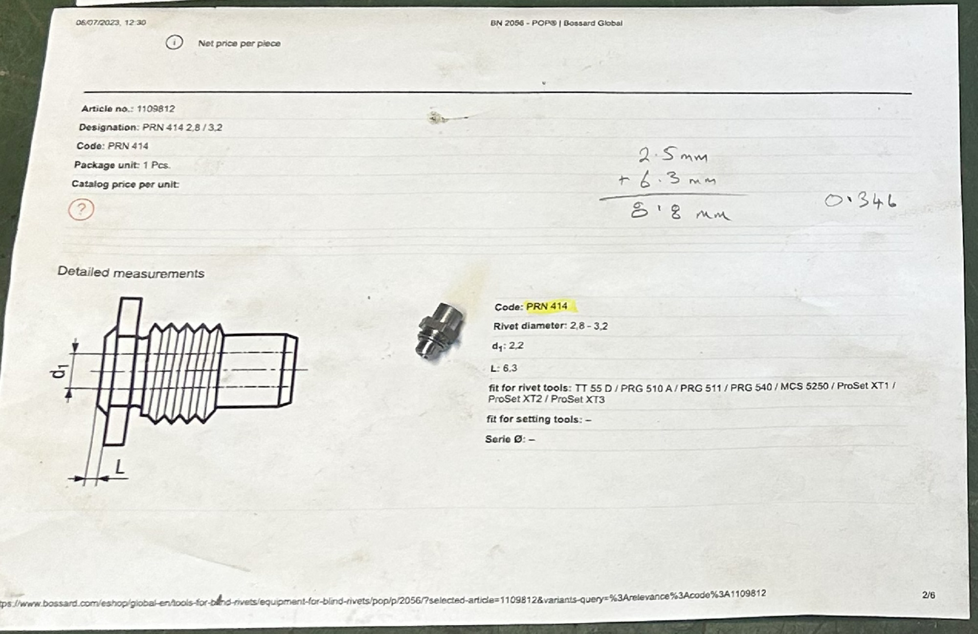

    Contacted three or four Stanley agents for price even one in America and no reply. So was a bit disappointed. But never mind I thought I will make them. To my surprise there was a link to the dimensions I needed to make the nose pieces for an XT3.

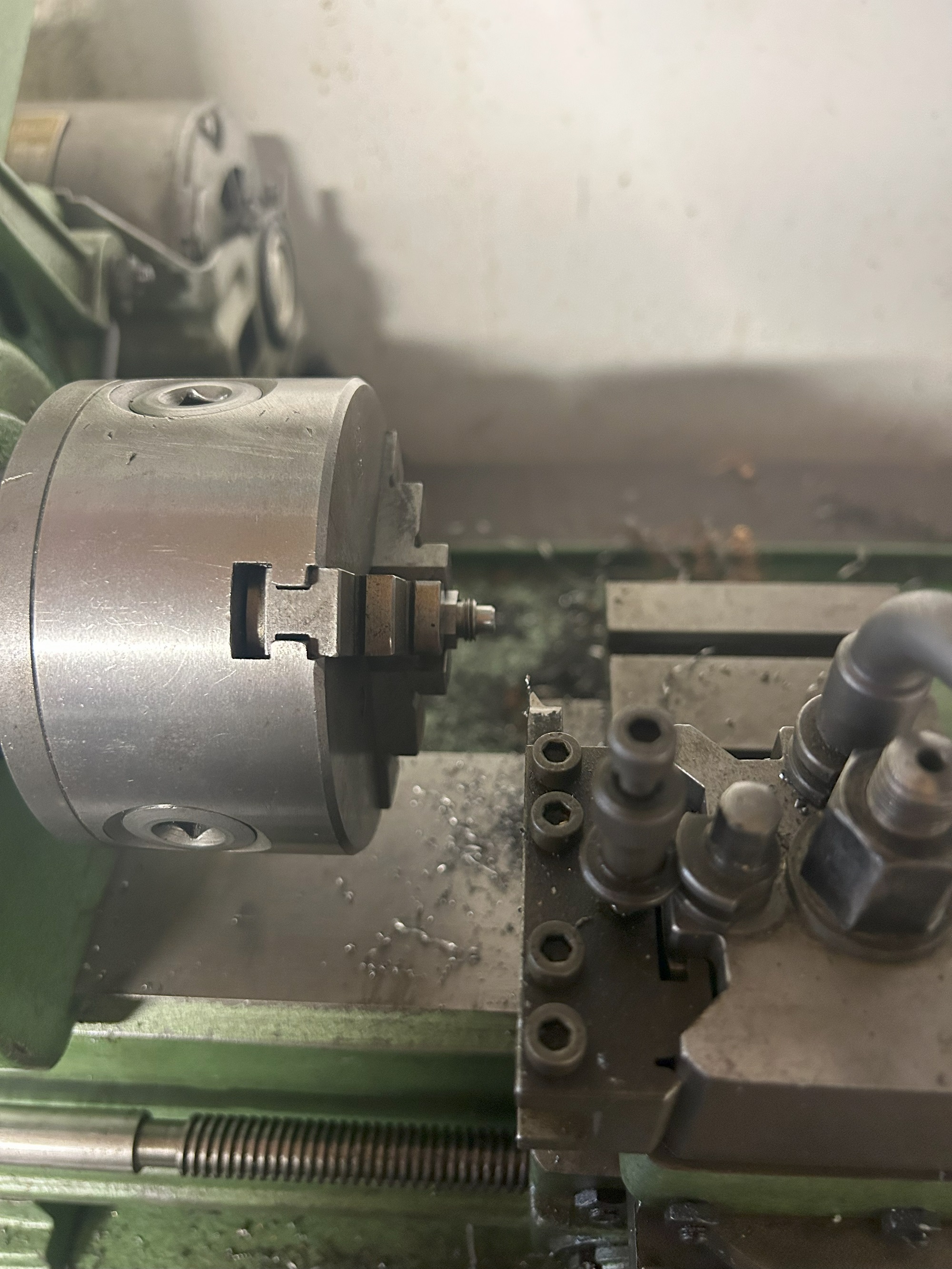

    The thread was measured and found to be a UNF 3/8 x 24 TPI. So the gear train was setup and the nose pieces made.

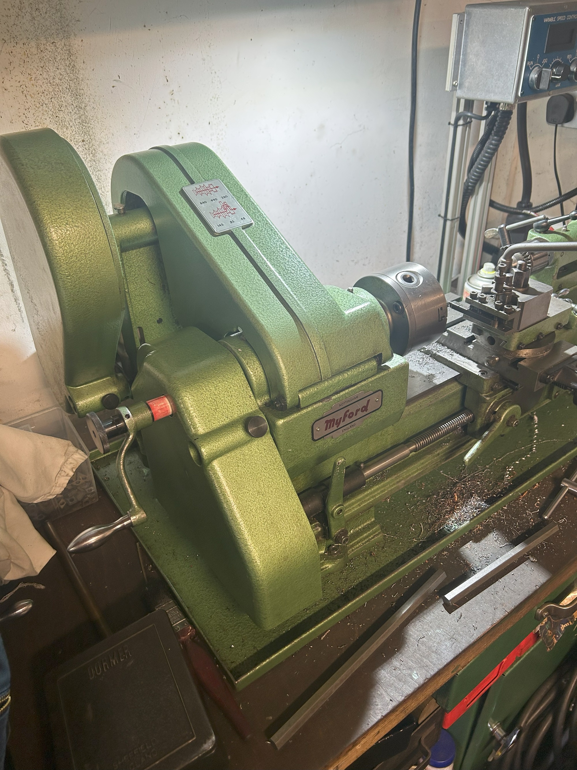

    To cut the thread I used the manual screw cutting method I shared a while back. Link to original post:
    Screw cutting by hand

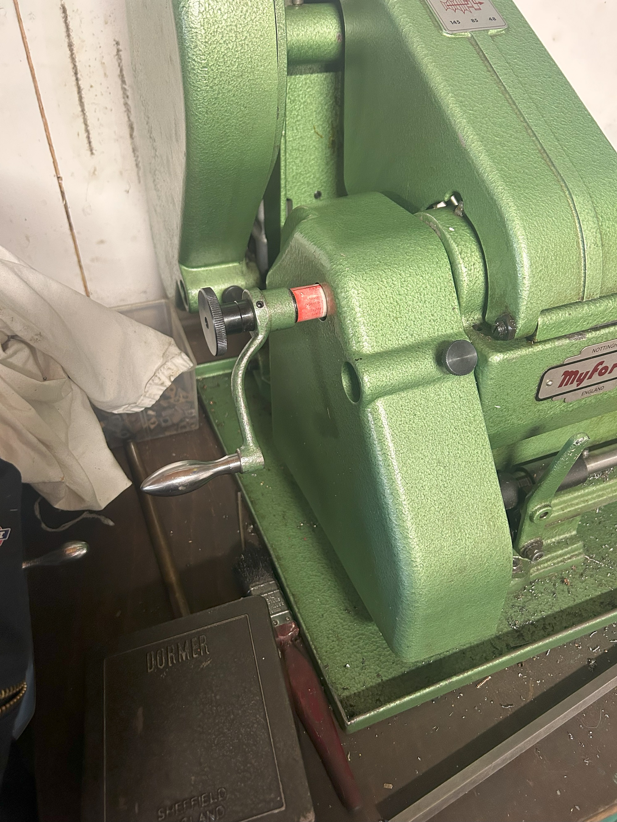

    As the thread only had a narrow undercut for the tool to drop into, using the crank handle gives plenty of control when stopping in such a small undercut.
    The photos below show the setup:
    Screw cutting short thread-crank-handle-2.jpg Screw cutting short thread-crank-handle.jpg Crank handle located in headstock spindle bore.

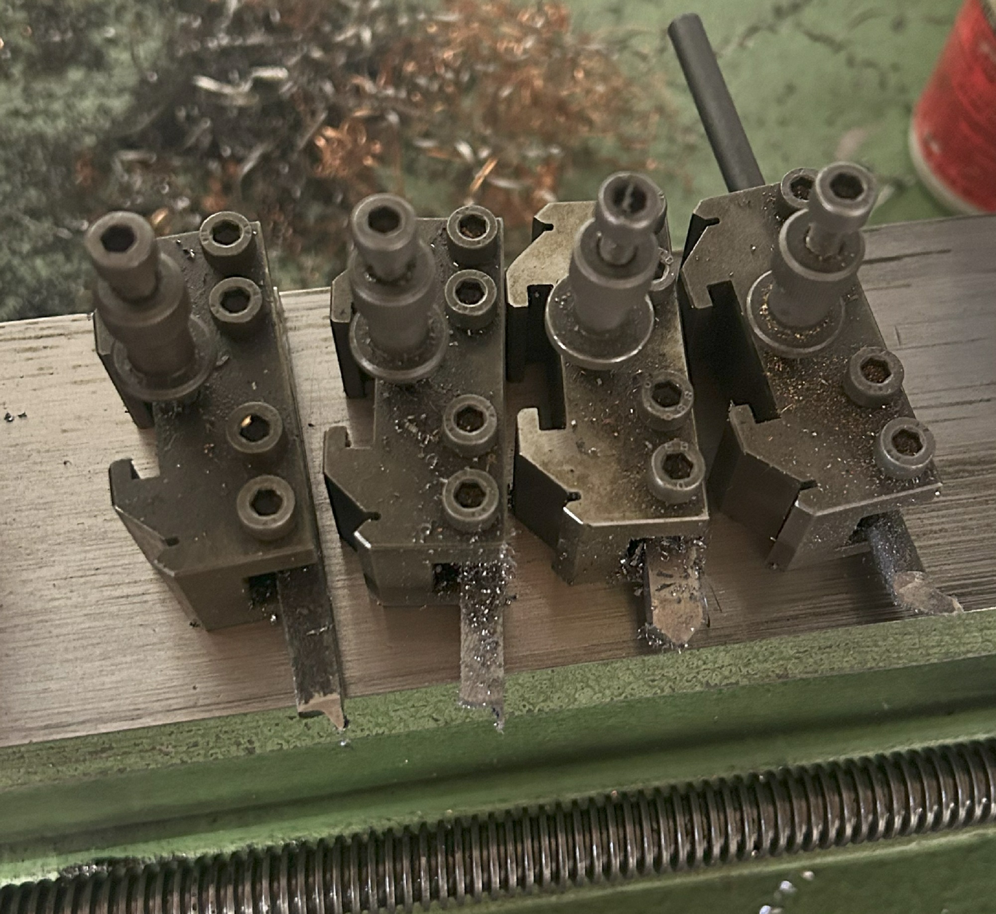

    Screw cutting short thread-screw-cutting.jpgScrew cutting up to a shoulder into a narrow undercut. This is very easy and controlled without having the machine under power.
    Screw cutting short thread-tools.jpg Tools used to make component

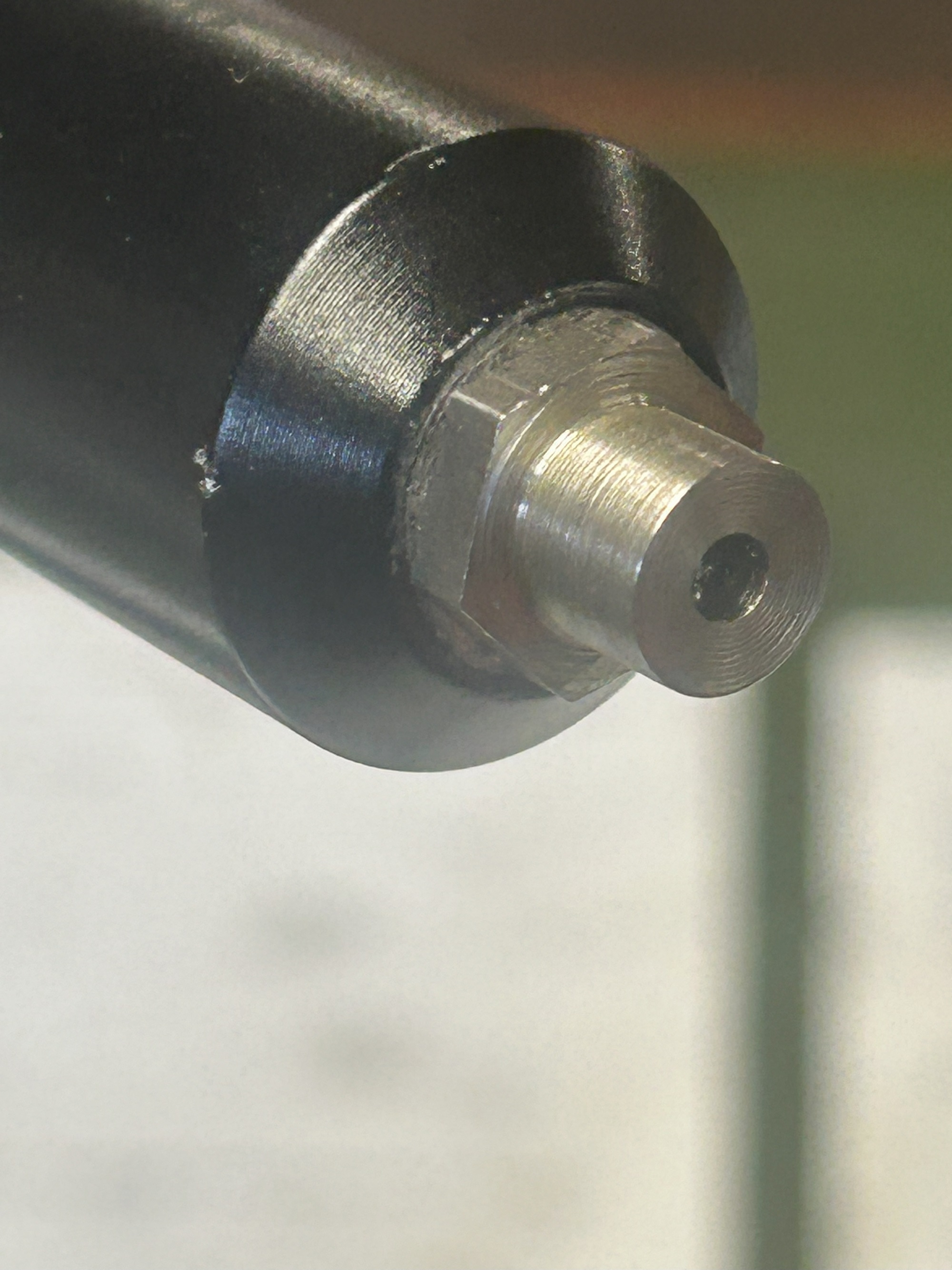

    Screw cutting short thread-drawing.jpg Screw cutting short thread-completed-nose-pieces.jpg Drawings printed off and all other dimension taken from original nose piece.
    Screw cutting short thread-nose-collet.jpg Homemade nose piece
    Screw cutting short thread-rivet-tool.jpg ProSet XT3 can set 4mm (5/32") to 6.4mm (1/4") rivets
