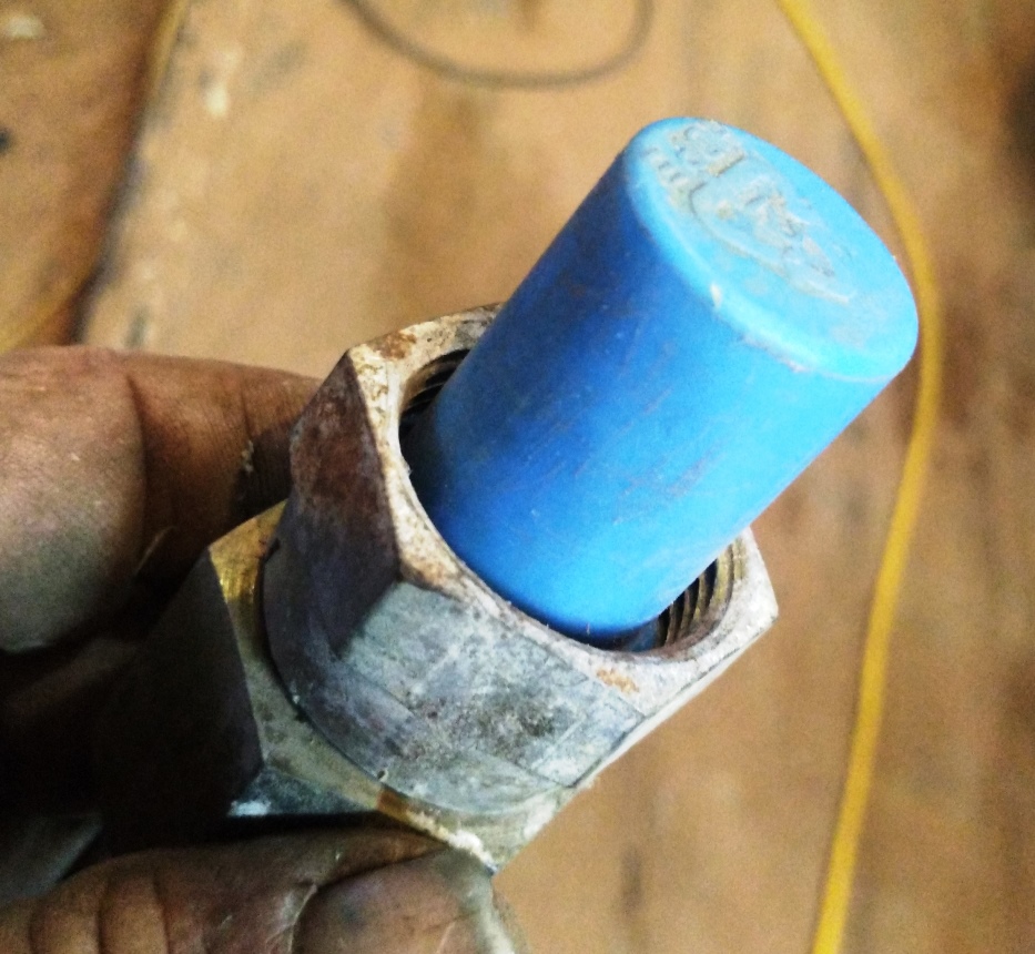

Ideally theses fittings would be used in conjunction with a hydraulic quality steel male adapter, or the black pipe would have an internal bevel turned into it, so as to have a clean machined mating surface. I hadn't thought about using this type of fitting when I made the water trap volume chamber, Thinking I would just use a standard pipe union and Teflon pipe dope or tape to make the seal
In digging through my bins of old fittings I discovered that I have about a dozen of these 1" pipe swivel adapters and zero 1" pipe unions.
Not having a way to remove or change out things in my air system without it requiring an extensive disassembly is not an option in my book.

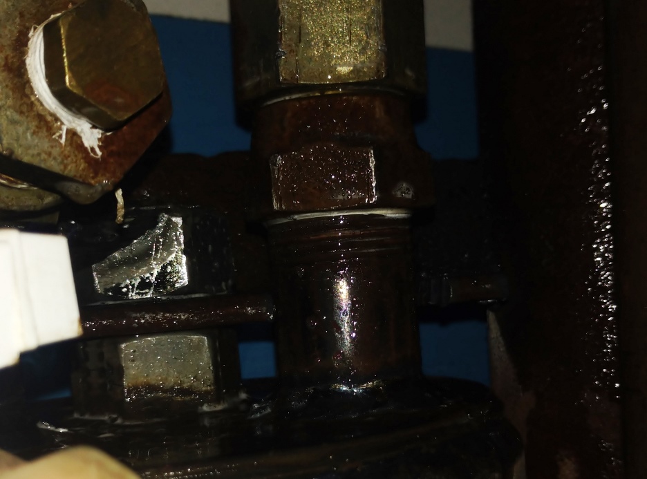

However, after assembling the system and checking for air leaks, no manor of tightening or over torquing the connection was ever going to stop the leakage I figured.
Meaning I needed a simplified solution. I quickly thought of making a nylon or plastic tapered gasket like seal to stop the leak.

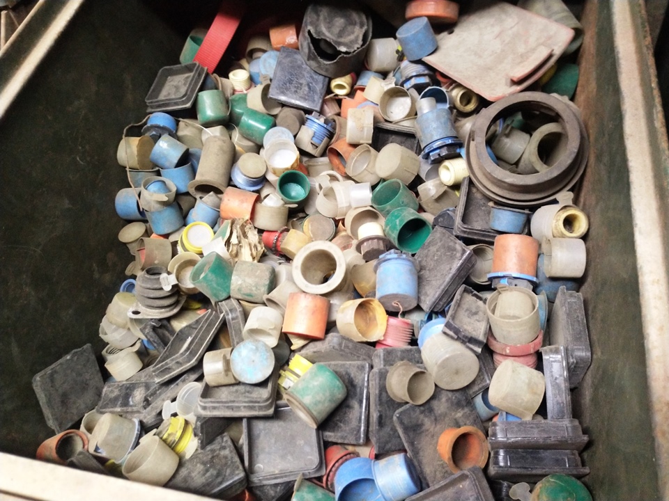

I don't know about anyone else but I save every plastic fitting cap or plug I find.
These are just the ones in 1 of my bins
Attachment 41317
After searching through I found the perfect candidate for my seal.
Attachment 41318

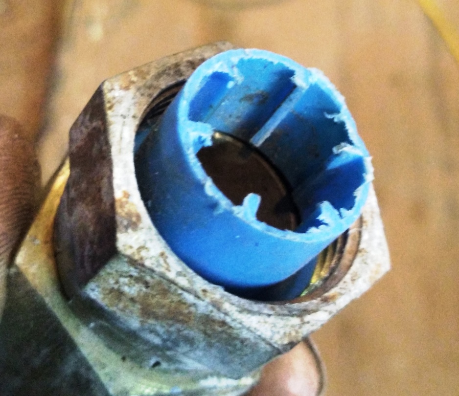

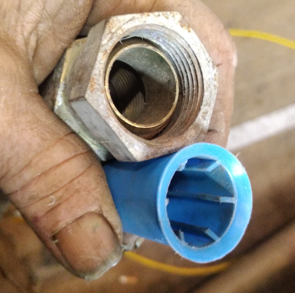

After sanding the flange down to fit in the swivel fitting and cutting off the excess length
Attachment 41319
Attachment 41320
Attachment 41321

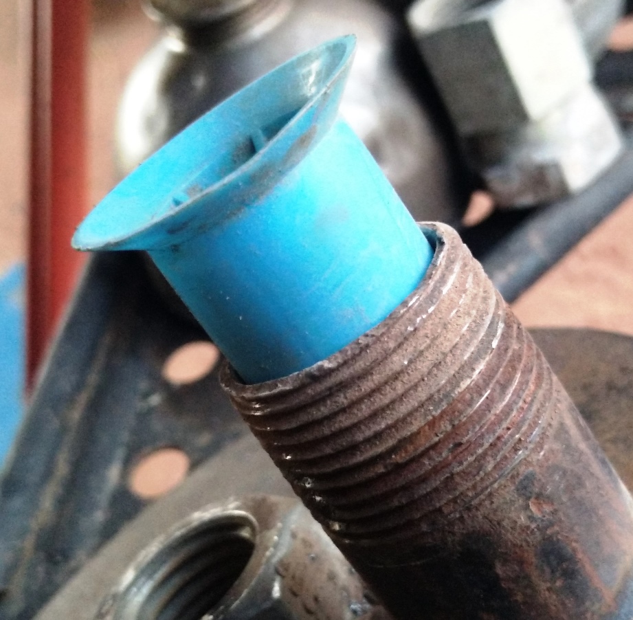

this is how it fit in the pipe
Attachment 41321
Reassembly aired up to 120PSi and doused in diluted dish soap
A little hard to see gut there are zero leaks.
