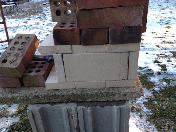

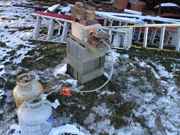

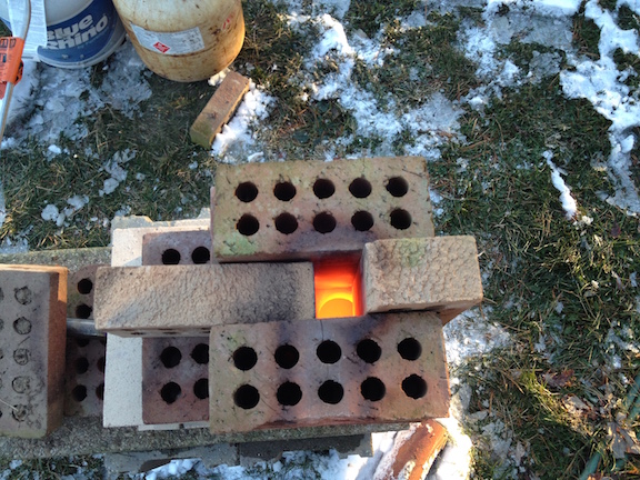

Last week, in search of a quick solution to anneal the pins, with input from ideas on this forum, I put together an atmospheric propane forge burner. Then built a chamber out of hard fire brick held in place by random clay brick I had on hand. It worked great to heat the steel. I measured the temp at over 1700˚f. But it is nearly impossible to control the cooling as required for proper annealing. So, now I have a forge, but still need a good, reliable way to heat treat, specifically anneal hardened steel.

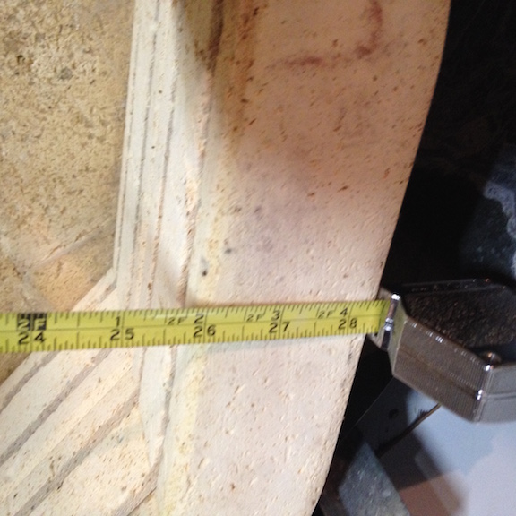

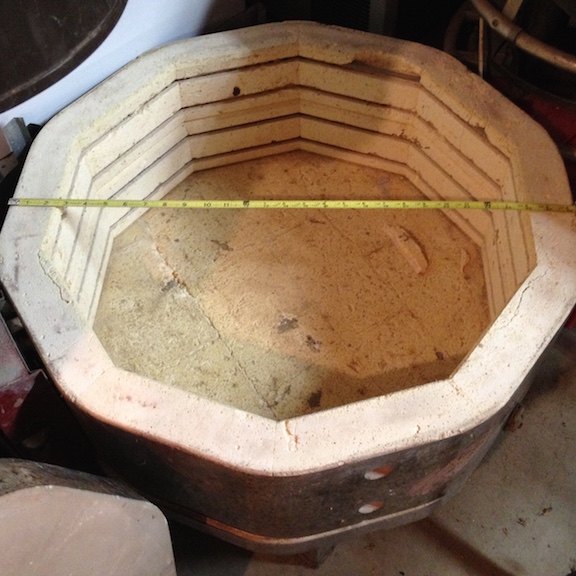

I have a section of ceramic kiln from a school where I used to teach. It was a nice Skutt kiln https://skutt.com/ceramic-kilns/ . These kilns are basically round, 10 sides, and built in sections so you can add or remove sections to make the kiln larger or smaller. Each section consists of 2 rows of 10 bricks 4 1/2” high so each section is 9” tall and about 24" inside. I have one of these sections, with the elements, along with the stand and the top and bottom from the original kiln.
Attachment 32090 Attachment 32091

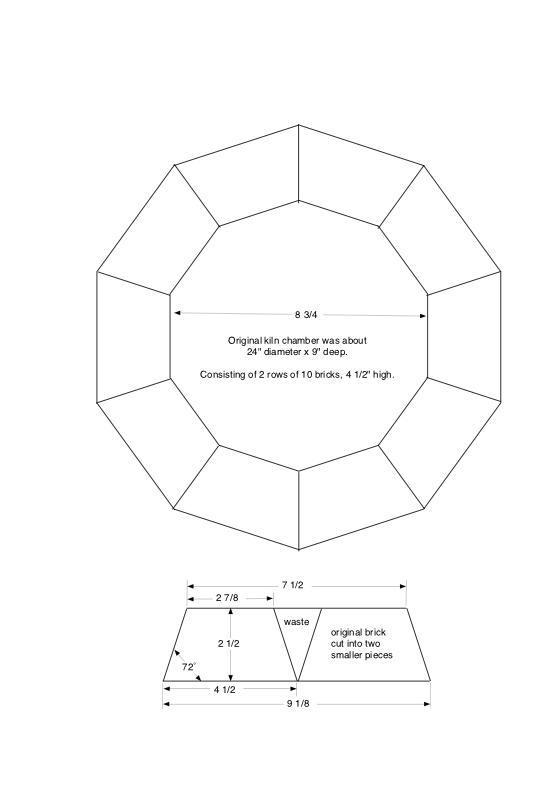

I am thinking I can cut the bricks, to make a smaller oven. I have a plan to cut the bricks so I can get two from each so I will end up with 4 rows of 10.
Attachment 32092
This would allow me to make two sections about 9” in diameter and 9” tall. I would be able to use just one section, or if necessary, put them together and have a 9” by 18” if necessary for longer parts. The bricks are held together by large stainless steel bands, much like big “hose clamps” I should be able to reuse these bands also.
Originally I was thinking of laying the oven on the side. Now I am leaning toward standing it up, like the kiln was originally built. It already have the original kiln stand I can just make smaller.
