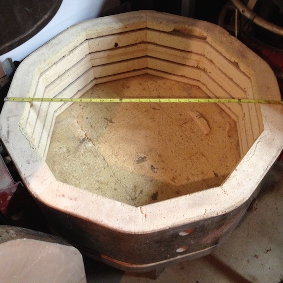

    I am looking for input from those of you who have more experience in what I am planning to try.
    I have been wanting a heat treating oven for a while now. Inspired by the recent postings here, specifically in regard to PID controllers, and the need to anneal, machine, then heat treat, some large hardened steel heavy equipment pins, I need to get moving on this project.
    Last week, in search of a quick solution to anneal the pins, with input from ideas on this forum, I put together an atmospheric propane forge burner. Then built a chamber out of hard fire brick held in place by random clay brick I had on hand. It worked great to heat the steel. I measured the temp at over 1700˚f. But it is nearly impossible to control the cooling as required for proper annealing. So, now I have a forge, but still need a good, reliable way to heat treat, specifically anneal hardened steel.

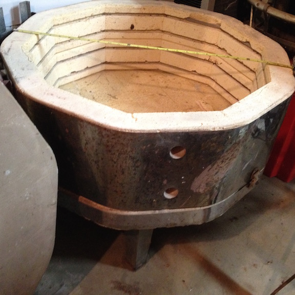

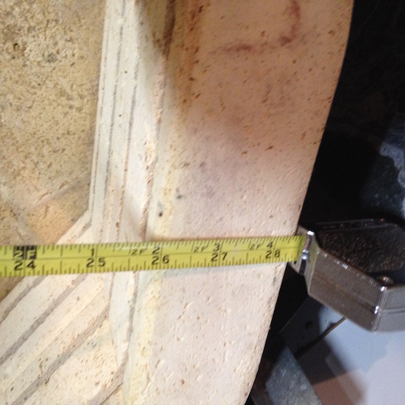

    I have a section of ceramic kiln from a school where I used to teach. It was a nice Skutt kiln https://skutt.com/ceramic-kilns/ . These kilns are basically round, 10 sides, and built in sections so you can add or remove sections to make the kiln larger or smaller. Each section consists of 2 rows of 10 bricks 4 1/2” high so each section is 9” tall and about 24" inside. I have one of these sections, with the elements, along with the stand and the top and bottom from the original kiln.
    Seeking Heat Treat oven input-kiln-size.jpg Seeking Heat Treat oven input-kiln-top.jpg

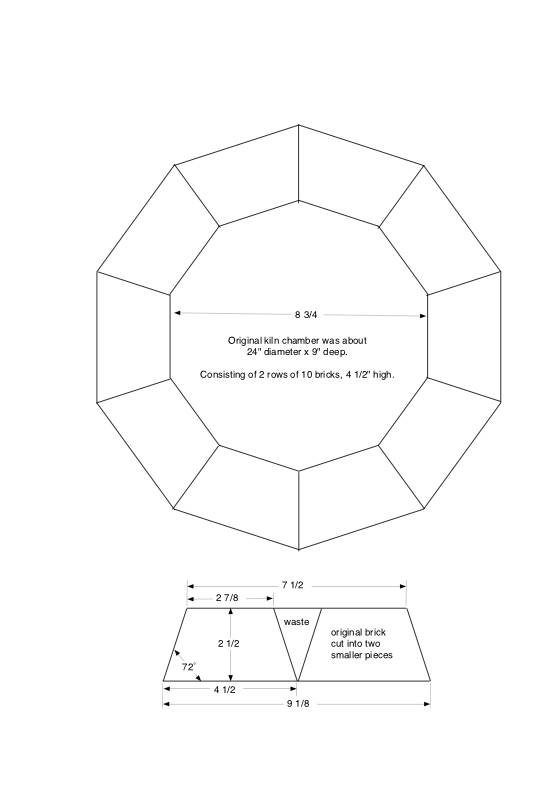

    I am thinking I can cut the bricks, to make a smaller oven. I have a plan to cut the bricks so I can get two from each so I will end up with 4 rows of 10.
    This would allow me to make two sections about 9” in diameter and 9” tall. I would be able to use just one section, or if necessary, put them together and have a 9” by 18” if necessary for longer parts. The bricks are held together by large stainless steel bands, much like big “hose clamps” I should be able to reuse these bands also.
    Originally I was thinking of laying the oven on the side. Now I am leaning toward standing it up, like the kiln was originally built. It already have the original kiln stand I can just make smaller.

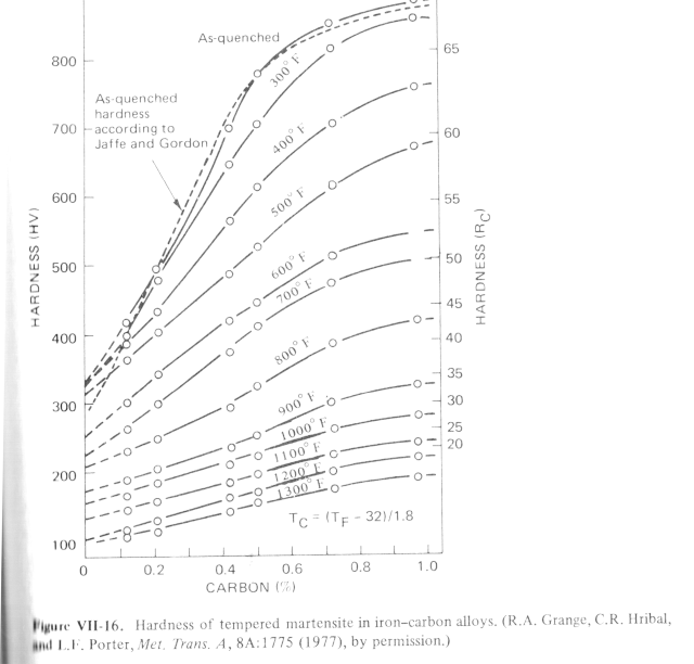

    All I can hope for here is that I have not used too much metallurgy knowledge and lost you in the process. Here is the graph on which I base my heat treatment decisions:
    What I have not discussed at all is mechanical properties, and toughness in particular. And if you want good toughness together with high strength, tolerances you are allowed to use shrink quite dramatically. Full Stop

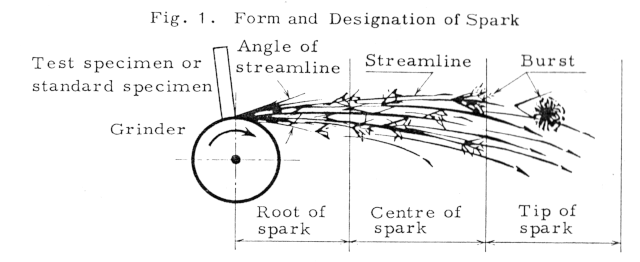

    Now you sound no longer as someone acting out of an industrial / commercial environment, and that permits me to relax standards of accuracy: I give you tips that in my experience will work, but I do not accept responsibility if something goes wrong. With that firmly understood, get yourself a copy of Japanese Industrial Standard JIS G 0566: Method of Spark Test for Steels. This standard provides a means to roughly sort steel by its chemical composition, by just observing the color and shape of the sparks produced with a grinding wheel. With that in hand, you can group your steel supply into what can be quenched and tempered successfully with primitive means, and those that cannot.
    Restrict yourself to carbon steel, i.e. steel that produces bright orange sparks and plenty of bursts. Steels producing dark red sparks are high alloy steels and not suitable for heat treatment with primitive means.
    Then, build your furnace with two or even three heating zones, zones that can be controlled individually so that you get a better temperature profile. If I read the picture of your furnace correctly, it is heated by open, uninsulated electric wires. Because they are uninsulated, safe operation mandates they are present in the walls, not in the floor or ceiling / door. With this design, ceiling and floor will be colder than the heated walls - how much requires measurements. Scale falling off your steel will otherwise cause short circuits.

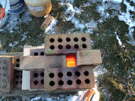

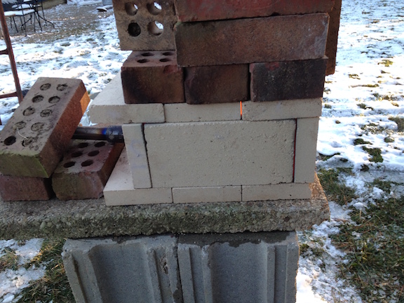

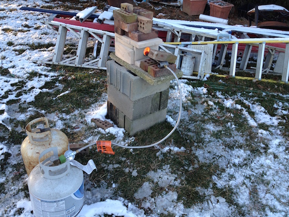

    I am looking into to the electric oven after trying to anneal with gas. I have also tried it in a large wood fire. I was easily able to get a pin up to temperature in the gas fired furnace as well as the big wood fire. I was not able to cool it down properly. My gas "forge" was crude at best. If is difficult to achieve only 70˚f of temperature loss per hour. If did not help that is was cold outside when I tried it. But that is another reason to have it be electric.
    Seeking Heat Treat oven input-crude-forge-1.jpgSeeking Heat Treat oven input-crude-forge-2.jpgSeeking Heat Treat oven input-crude-forge-3.jpg
    I switched my focus to electric as I have the old kiln. I have heavy duty contactors, I have most of the parts. The most expensive things I need to buy is the PID controller, and ceramic blanket insulation. Also, I can keep and use an electric one in the work shop in the basement. I have an exhaust hood, but it is not adequate for a gas fired forge or oven.
    In regard to uneven heating, I do realize that is an issue, but not insurmountable. If you think about it, a round oven, with the elements totally surrounding the workspace make a much more even heating device, especially for round shapes. That it the main reason that Skutt Kilns are built that way, there are no corners to prevent even heating of ceramic pieces. According to my preliminary sketches, I can get cut the existing kiln into enough smaller bricks to make a chamber about 6" diameter, and 18" long. I have not decided yet of the orientation will be vertical or horizontal, I am leaning toward vertical because of the ease of positioning parts centered between the elements.
