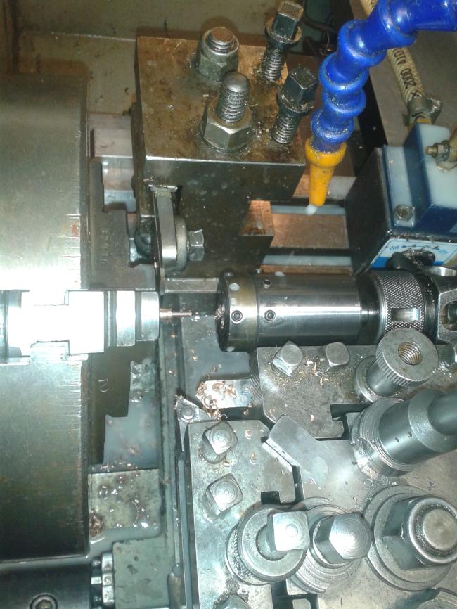

This is a short video on setting up two individual tool holders on the Dickinson tool post to face and chamfer in one operation on the lathe.
Saves a tool change or reloading each component to chamfer after facing.
