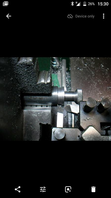

    I did this type of setup with HSS making 46 odd tool holder adjusting nuts back in 2003, for the tool holders I made.
    Attached Thumbnails Attached Thumbnails Setting two tools for facing and chamfering in one operation-screenshot_20180309-153052.jpg

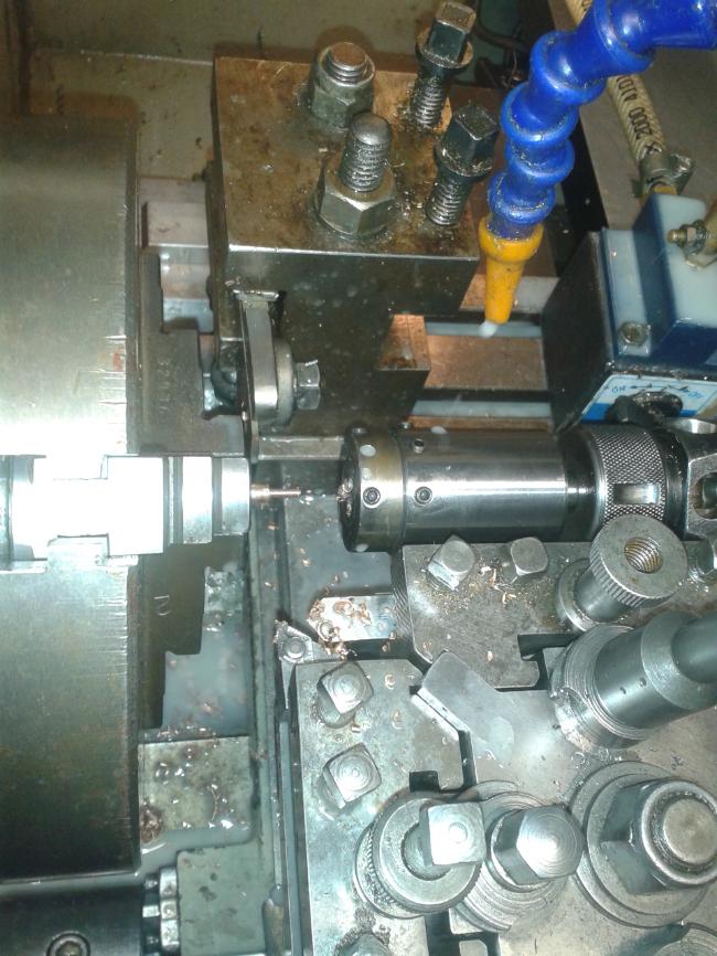

    This is the tools setup for cutting along the z-axis. A right hand lathe tool followed by the chamfer tool for sliding. For facing, I use the left hand tool as per the video. So as can be seen from the photo below, the length in this case has changed the chamfer size and the tool orientation.
    Setting two tools for facing and chamfering in one operation-twin-tool-cutting.jpg
    The photo shows one of the stages in making the phosphor bronze cylinder-block bolts for my 1” scale Traction Engine.
    Setting two tools for facing and chamfering in one operation-bronze-bolts-2.jpg Setting two tools for facing and chamfering in one operation-bronze-bolts.jpg
    Food for thought Marv
    The Home Engineer
