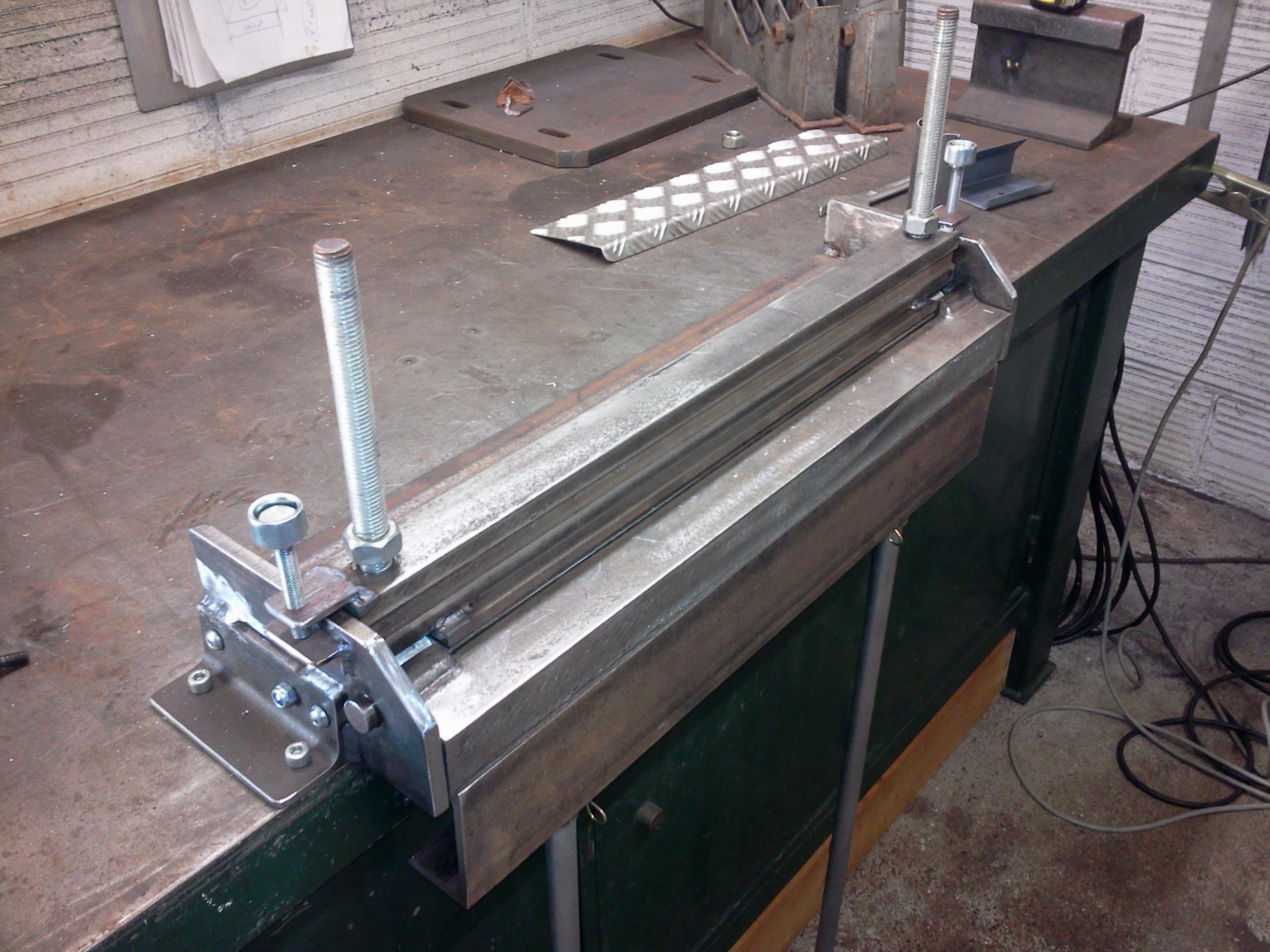

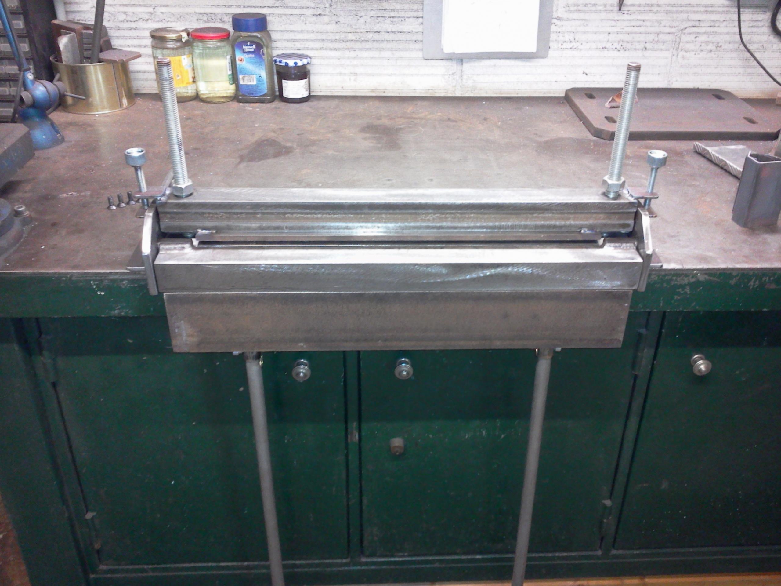

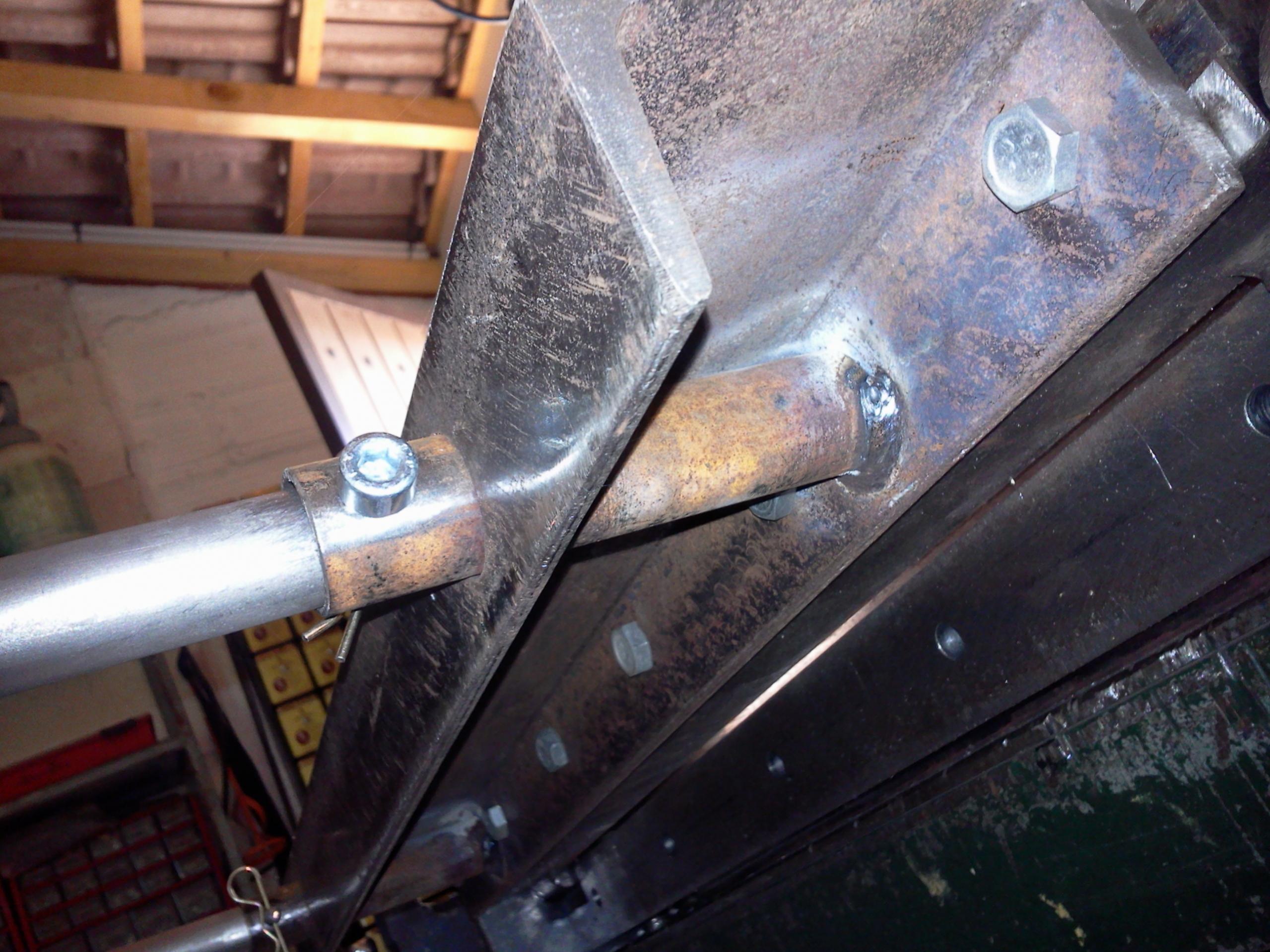

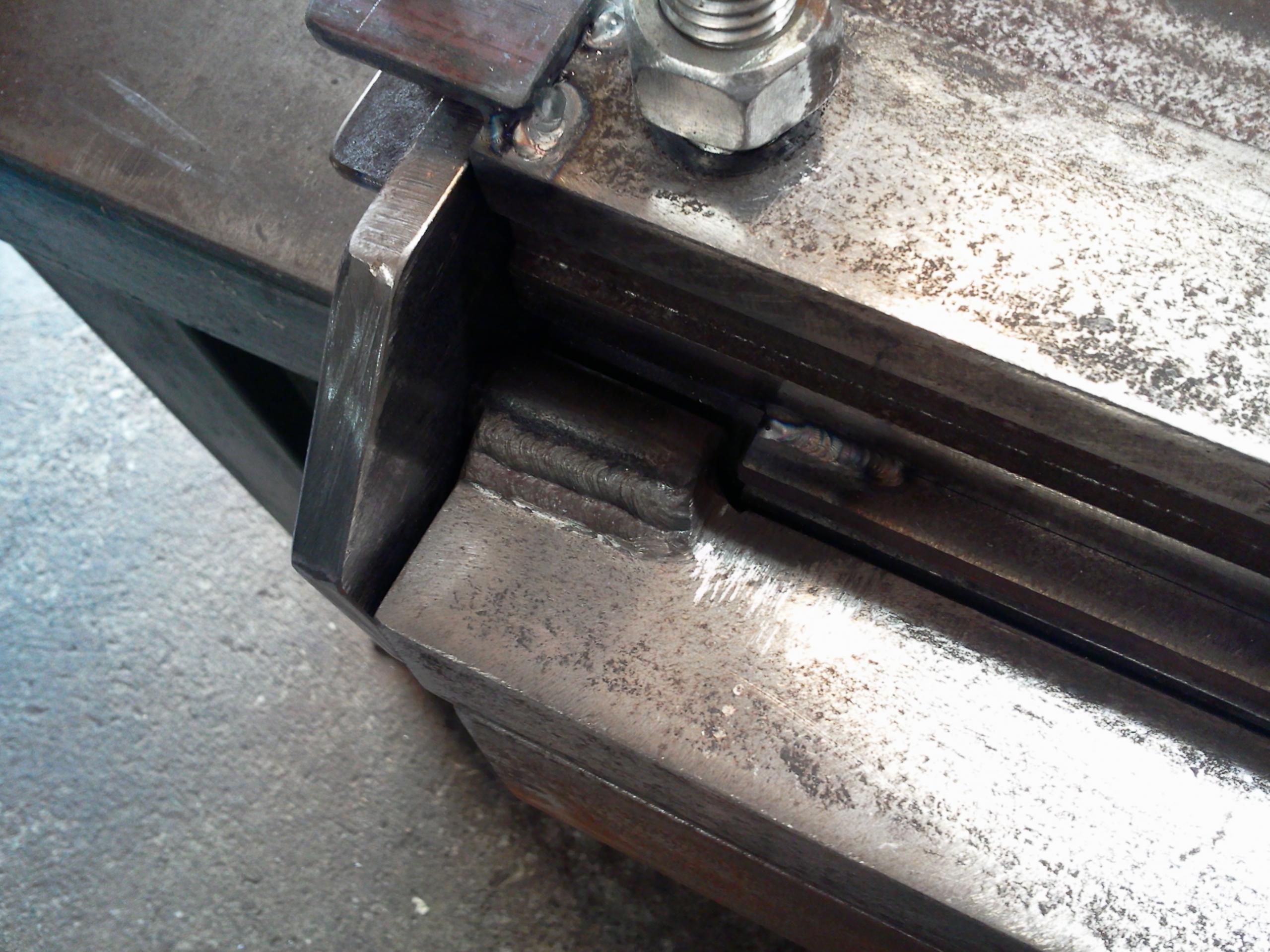

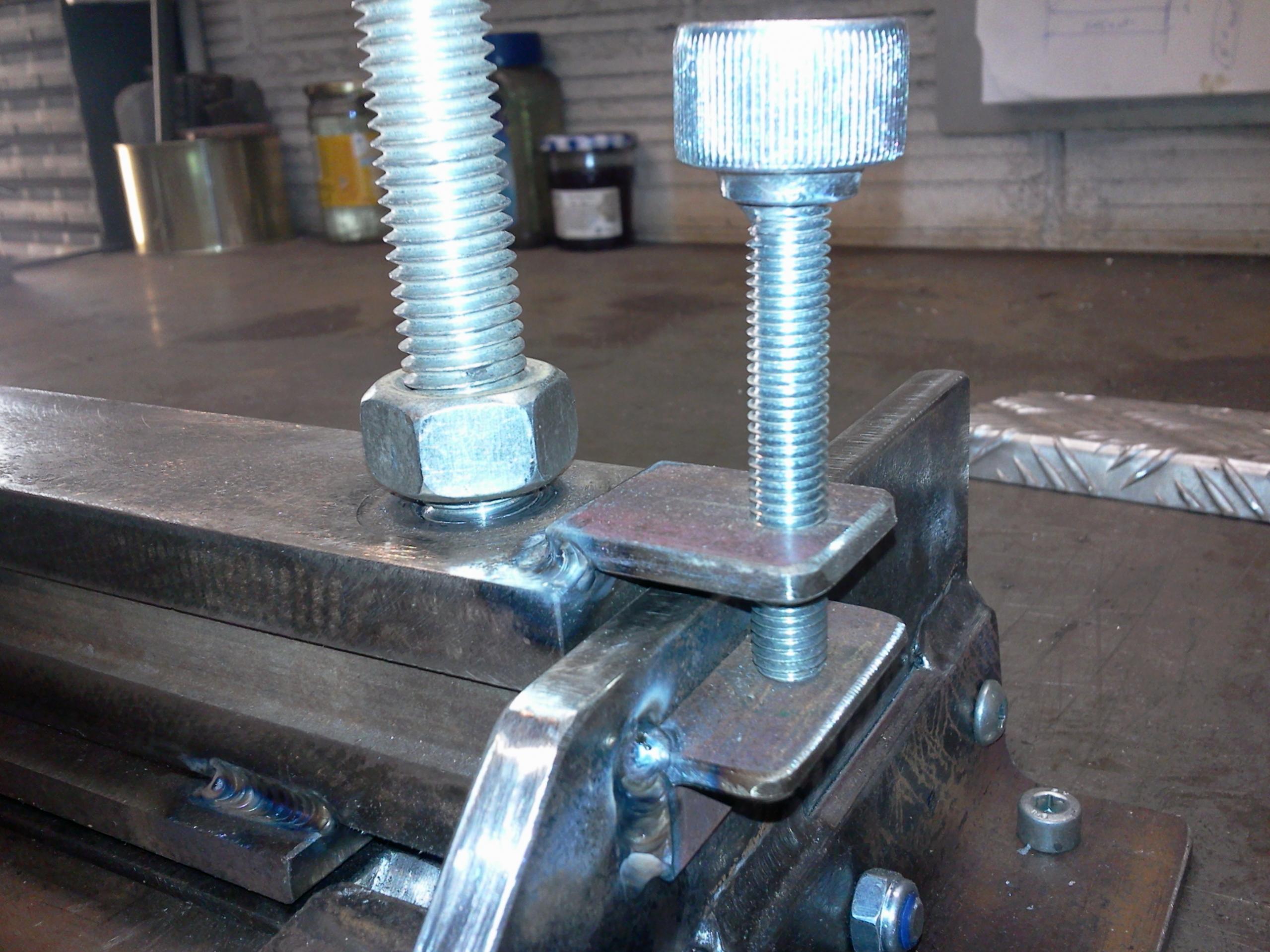

    Hello....here is a small sheet métal bender....workng lenght :550
    for sheet métal : 1.5
