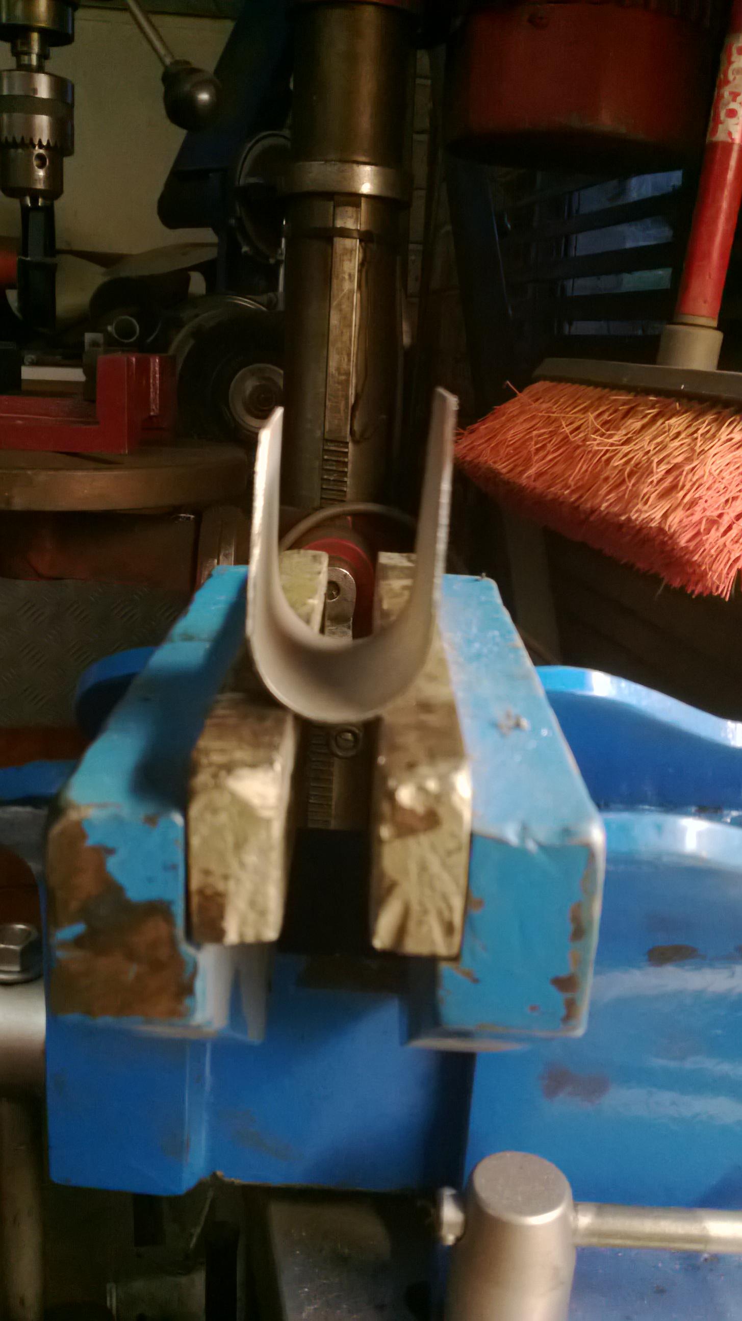

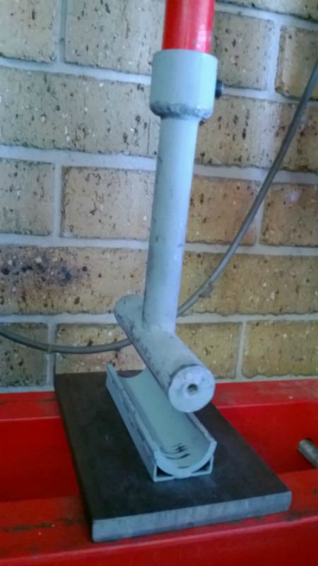

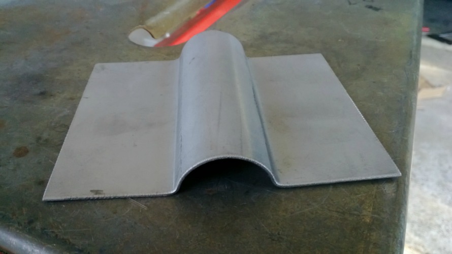

    I made this tool originally to press 1mm sheet steel into a U shape for making corner gussets in a tube frame chassis.Sheetmetal Press Tool-pt1.jpgSheetmetal Press Tool-pt2.jpg

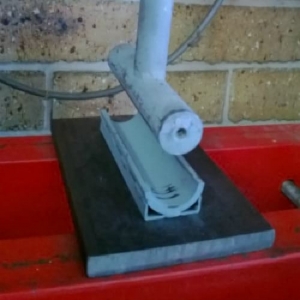

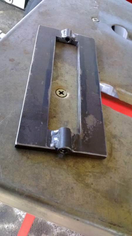

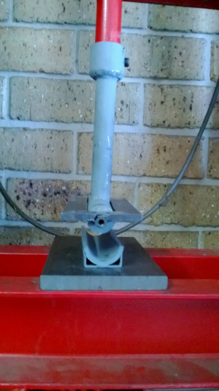

    I made it to mount in my small hydraulic shop press. After making some gussets I thought of an additional use for the tool, making brackets that clamp to chassis rails. All that was required was to make a plate which can be removed when in 'gusset mode'.Sheetmetal Press Tool-pt3.jpg The ends of the plate has grub screws which locate in the centre drilled ends of the die. This is the resulting bracket.Sheetmetal Press Tool-pt4.jpgSheetmetal Press Tool-pt5.jpg.
    One tip to remember is to allow clearance for your sheet metal when you are making your male & female dies.
    Attached Thumbnails Attached Thumbnails Sheetmetal Press Tool-wp_20151031_007.jpg
