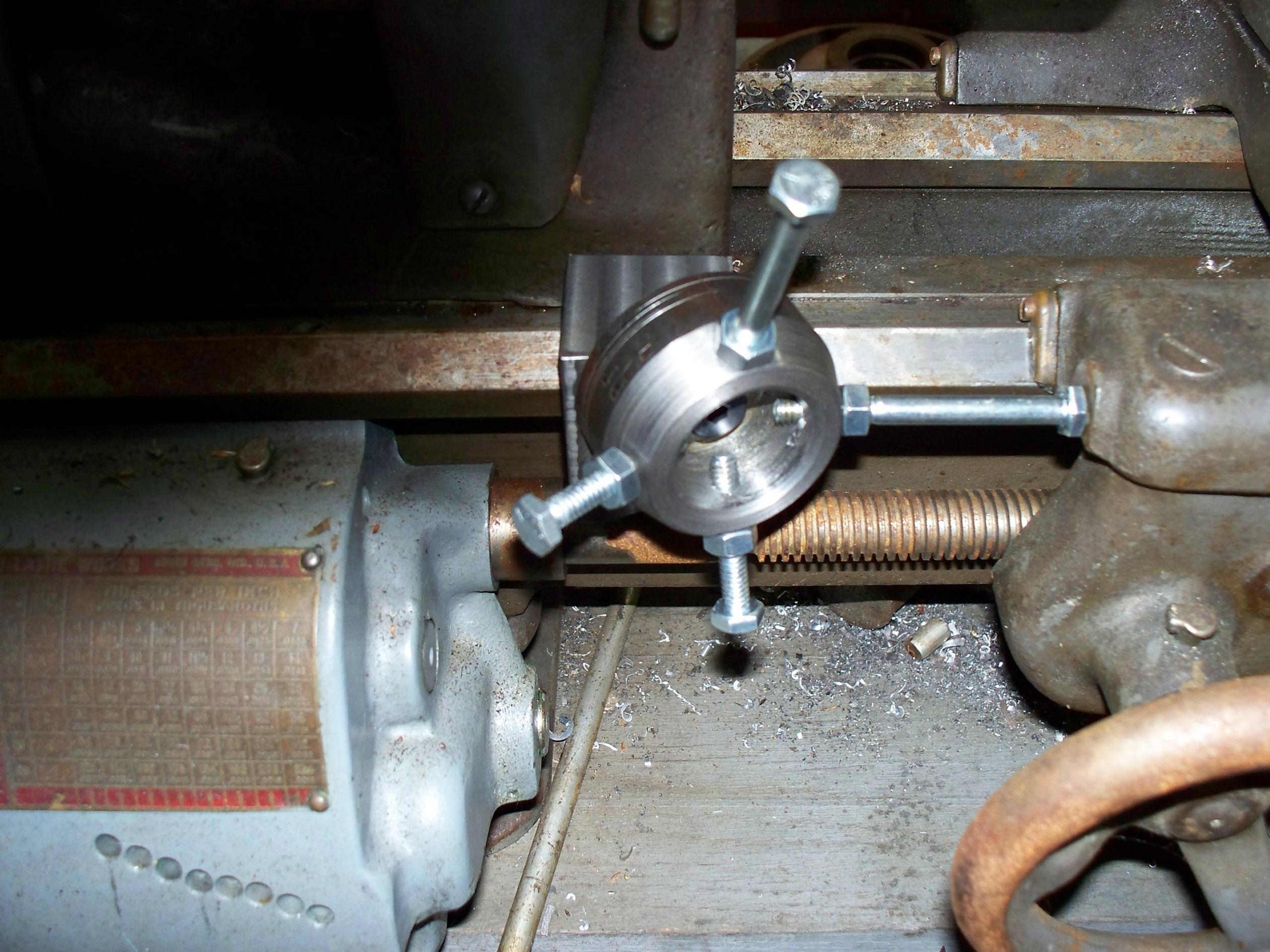

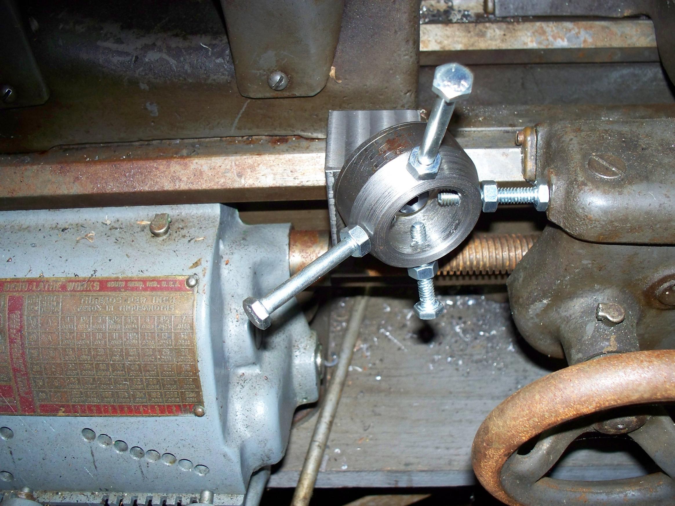

Here's a new way to make a 4 way stop for your South Bend 9 lathe. Instead of being inline, I made it to offset at a 45 degree angle. I'm using simple 1/4 20 screws as stops. Each stop has a ball and spring detent locator. It sure makes turning small parts a lot faster. Might be a good week end project.Attachment 7517Attachment 7518:clapping:
