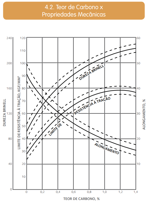

My goal is identify unknown steels and relate brinell hardness with ultimate strenght.

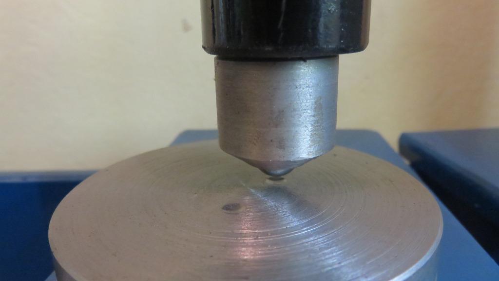

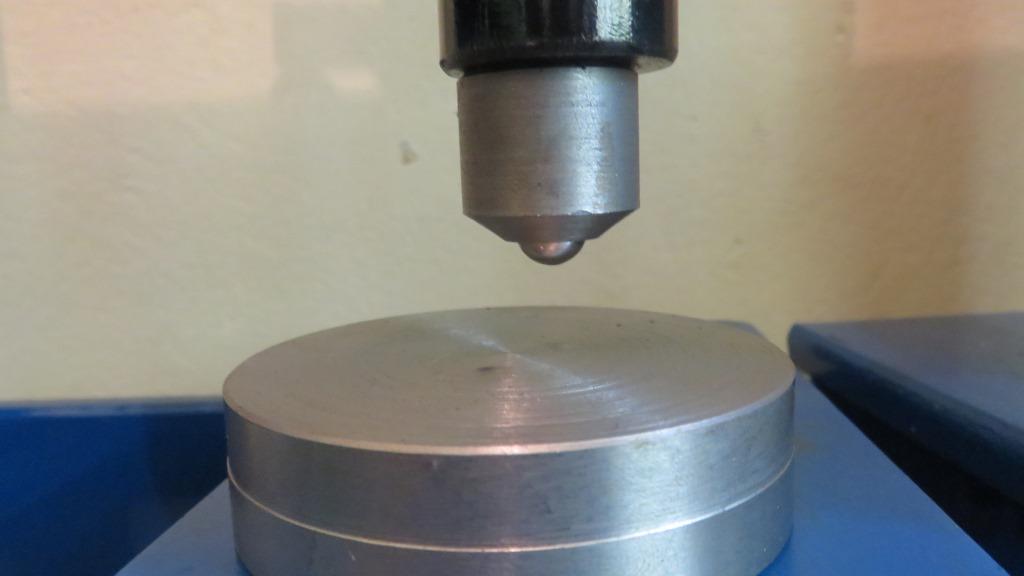

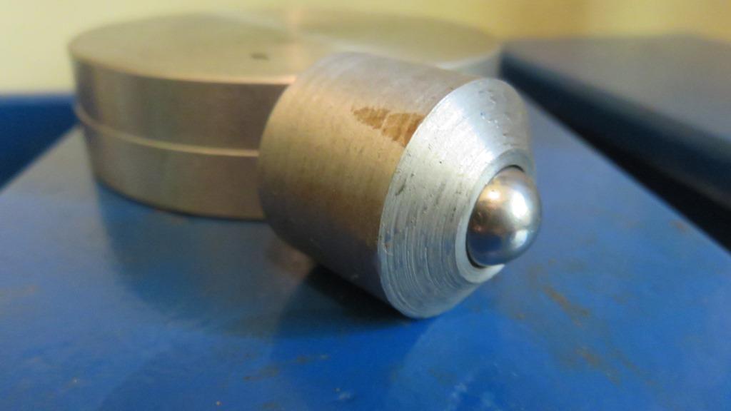

I Made the "holder" for 10mm (3/8") ball. The holder let only 3mm (1/8") of the ball exposed.
Attachment 20590
For sure the holder is a must if you doesn't want to brinell test your press ram.
Attachment 20591

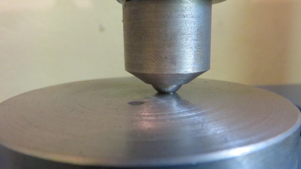

Tested some 1020, 1045, A36, SCH80 and AL 6061 I have at scrap bin.
Attachment 20592
Attachment 20593
Attachment 20594
Problems found:
* My readings ended being a bit off expected numbers. Had a tough time taking precise measurements with a paquimeter. I Had read that there is a dedicated microscopes for this....maybe a good photo and convert pixel to mm....this will be my next try.
