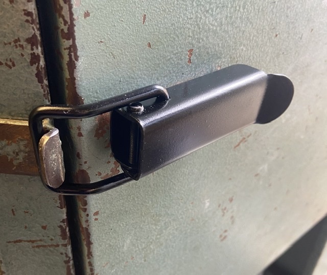

On closing the door of my shot blast cabinet the door latch fell apart from wear and tear. My first thought was to just buy a replacement but trying to get an exact match was impossible and I didn’t really want to drill additional holes. So the only option was to make a new one.

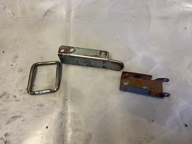

Attachment 34340 Old worn out latch

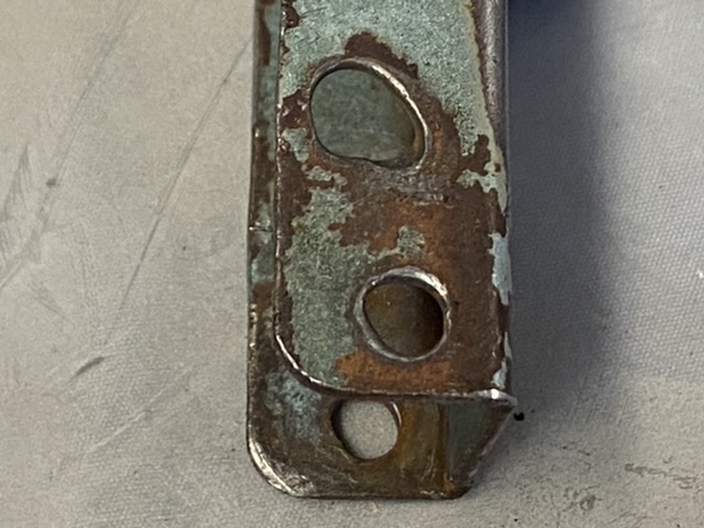

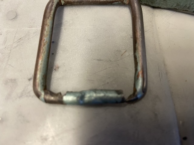

Attachment 34341Attachment 34342Photos showing excessive wear.

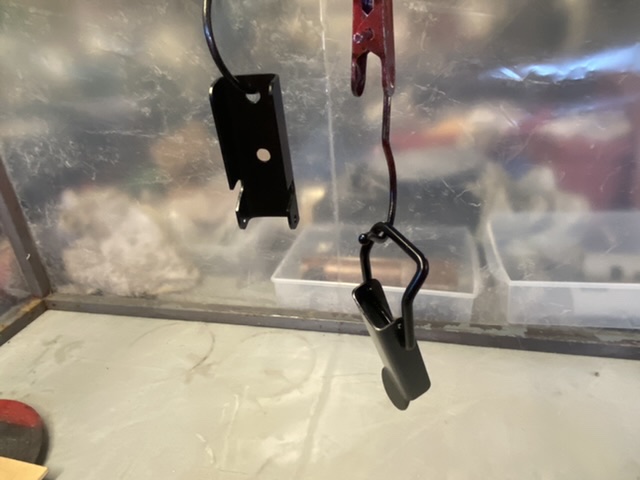

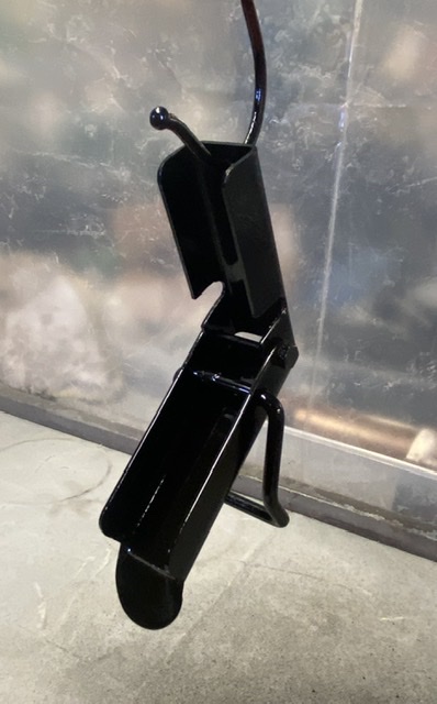

Attachment 34343 Attachment 34345 New latch painted

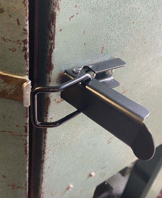

Attachment 34347 Attachment 34348 In place and works really well
This only took a hour and half to make so pleased with the result.
