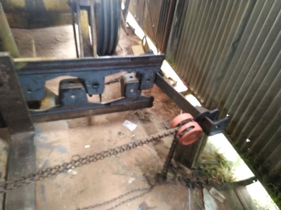

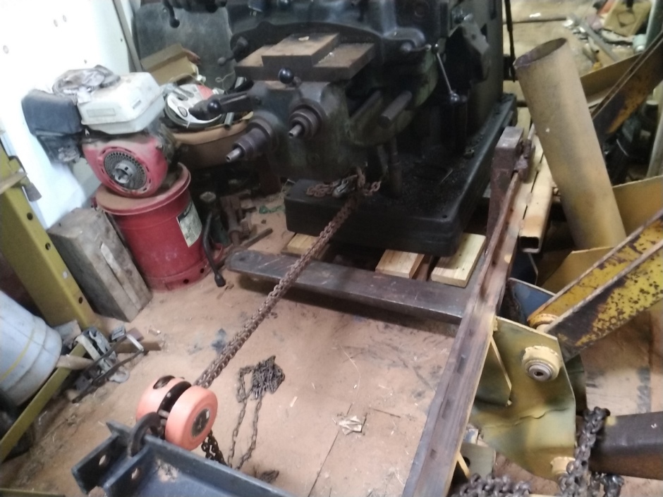

    In draging my Horizontal mill out of the container I needed a way to transition it onto the forks of my backhoe loader
    So I simply chained a scrap piece of heavy angle iron tot eh carriage and pulled with a chain hoist
