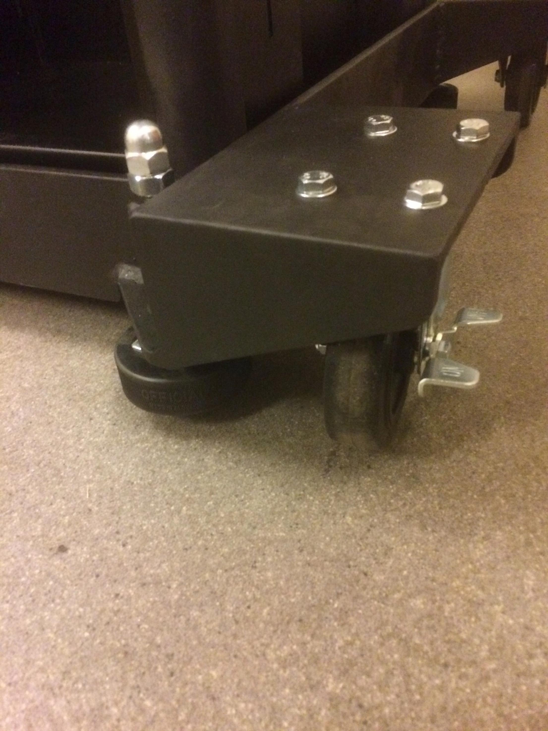

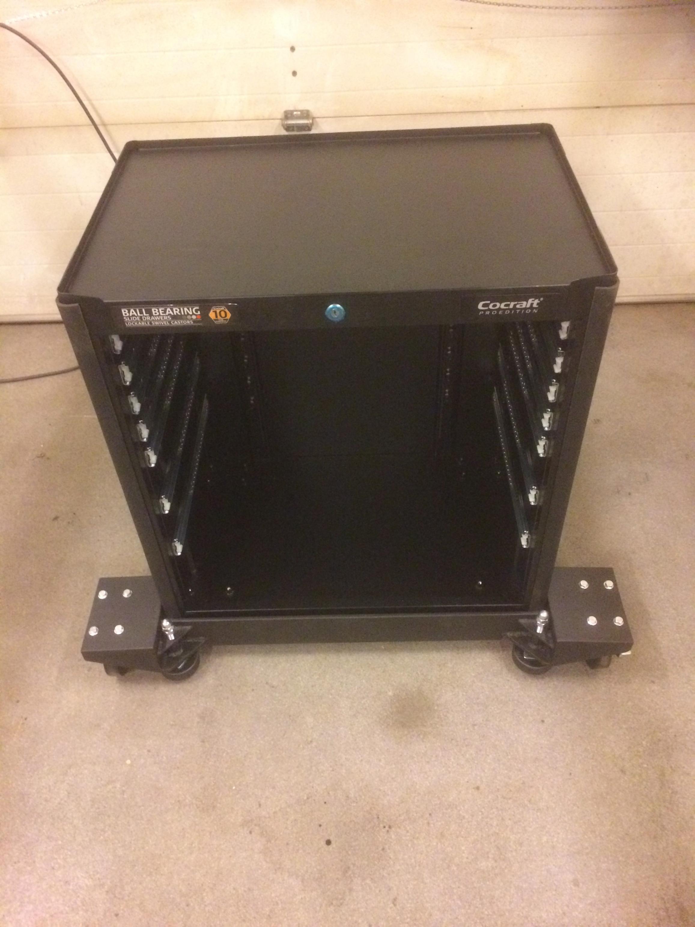

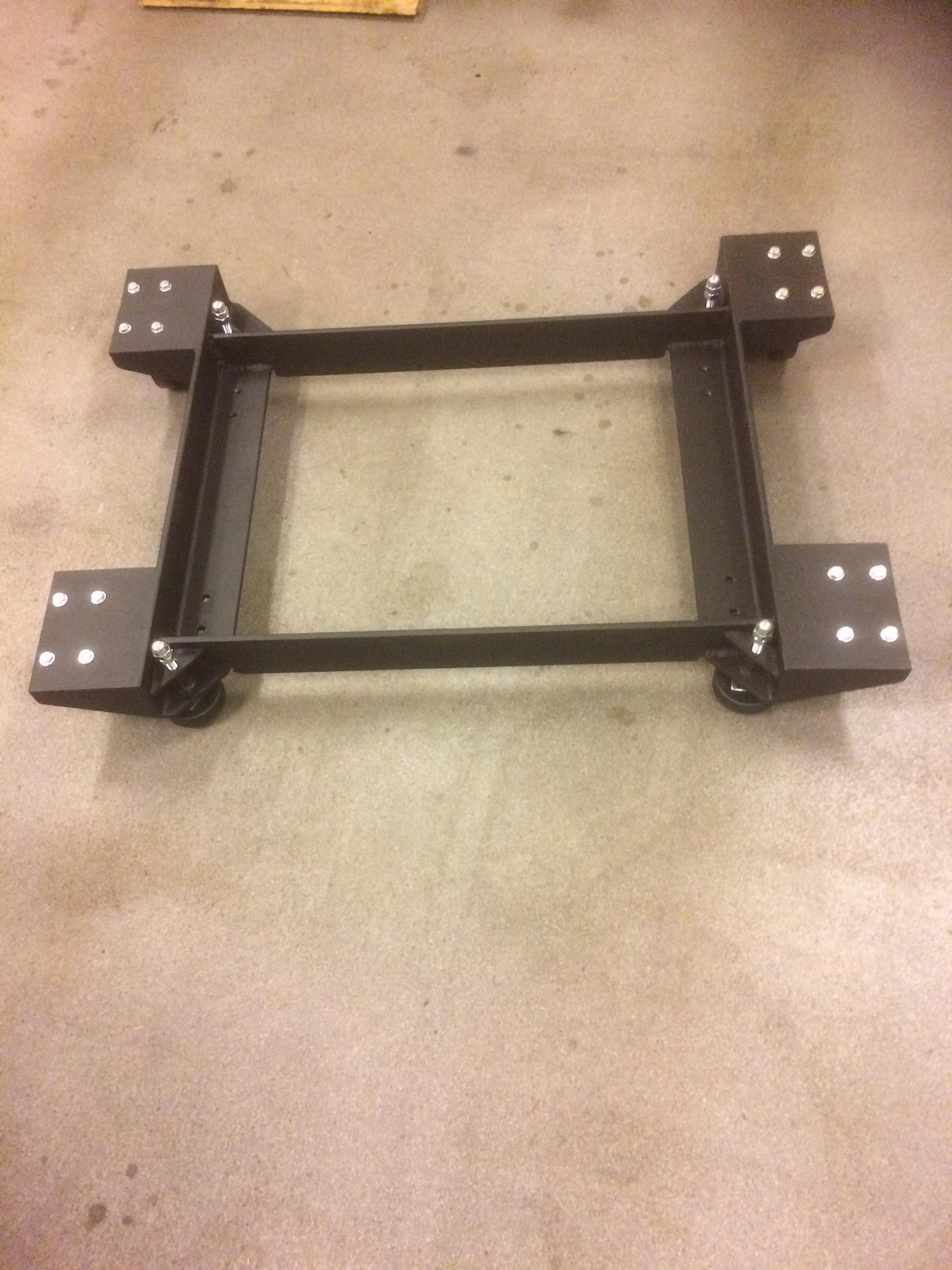

    As a base for the stand I purchased a CoCraft tool cabinet that can carry a weight of around 380 kg. The caster wheels were however too near one another for the cabinet to be stable enough and the final milling table height would also have been slightly too high. To overcome these small issues I made a frame of 80 x 80 mm angle bar and 80 mm flat bar that extended the castor wheel positions and also lowered the cabinet by around 50 mm.
    SIEG SX3L Milling Machine Stand-img_1717.jpg SIEG SX3L Milling Machine Stand-img_1722.jpg

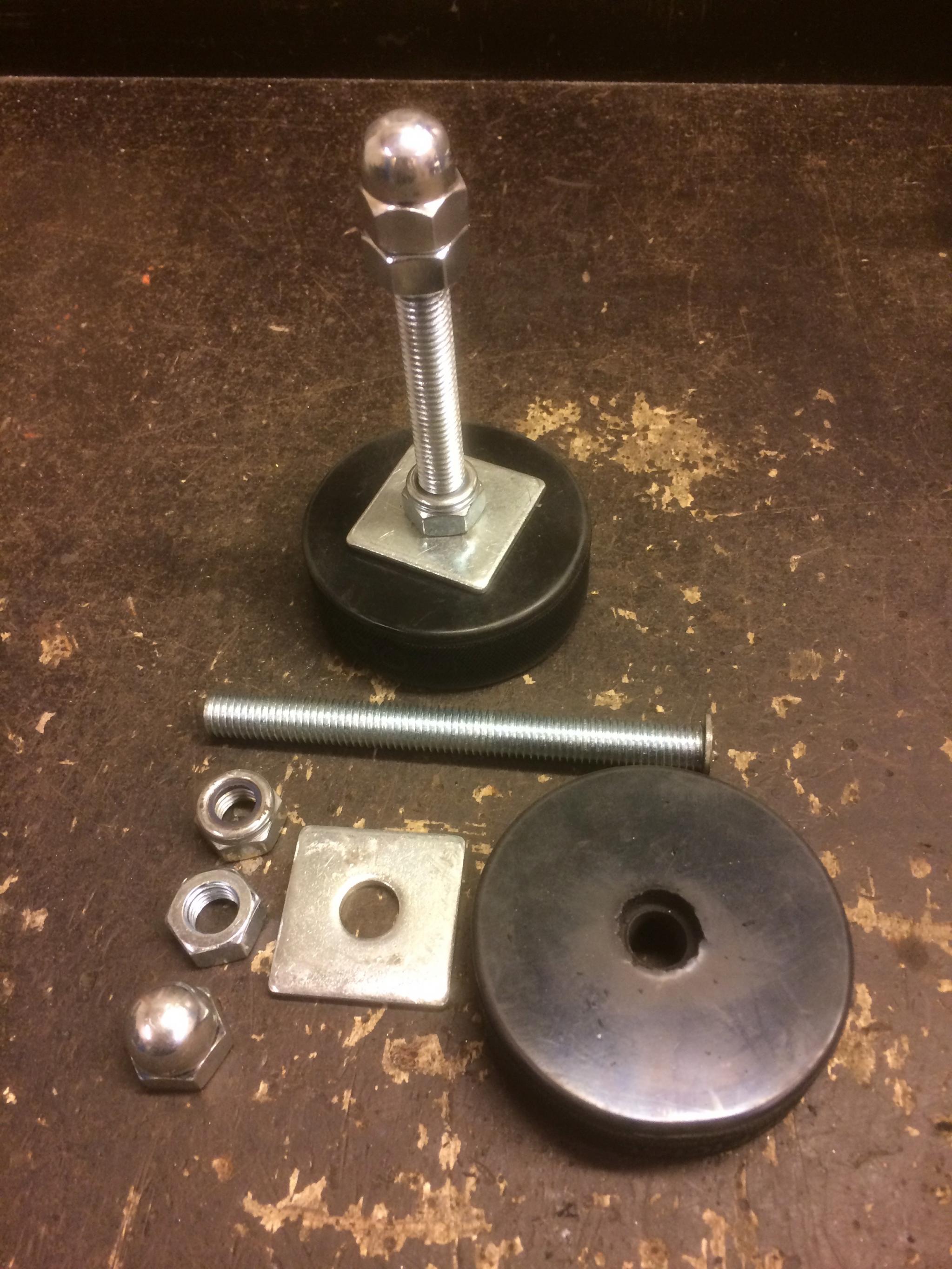

    For final levelling I also needed four adjustable machine feets. As ready made were quite expensive I made them of M12 threaded rod and ice hockey pucks.
    SIEG SX3L Milling Machine Stand-img_1724.jpg SIEG SX3L Milling Machine Stand-img_1716.jpg

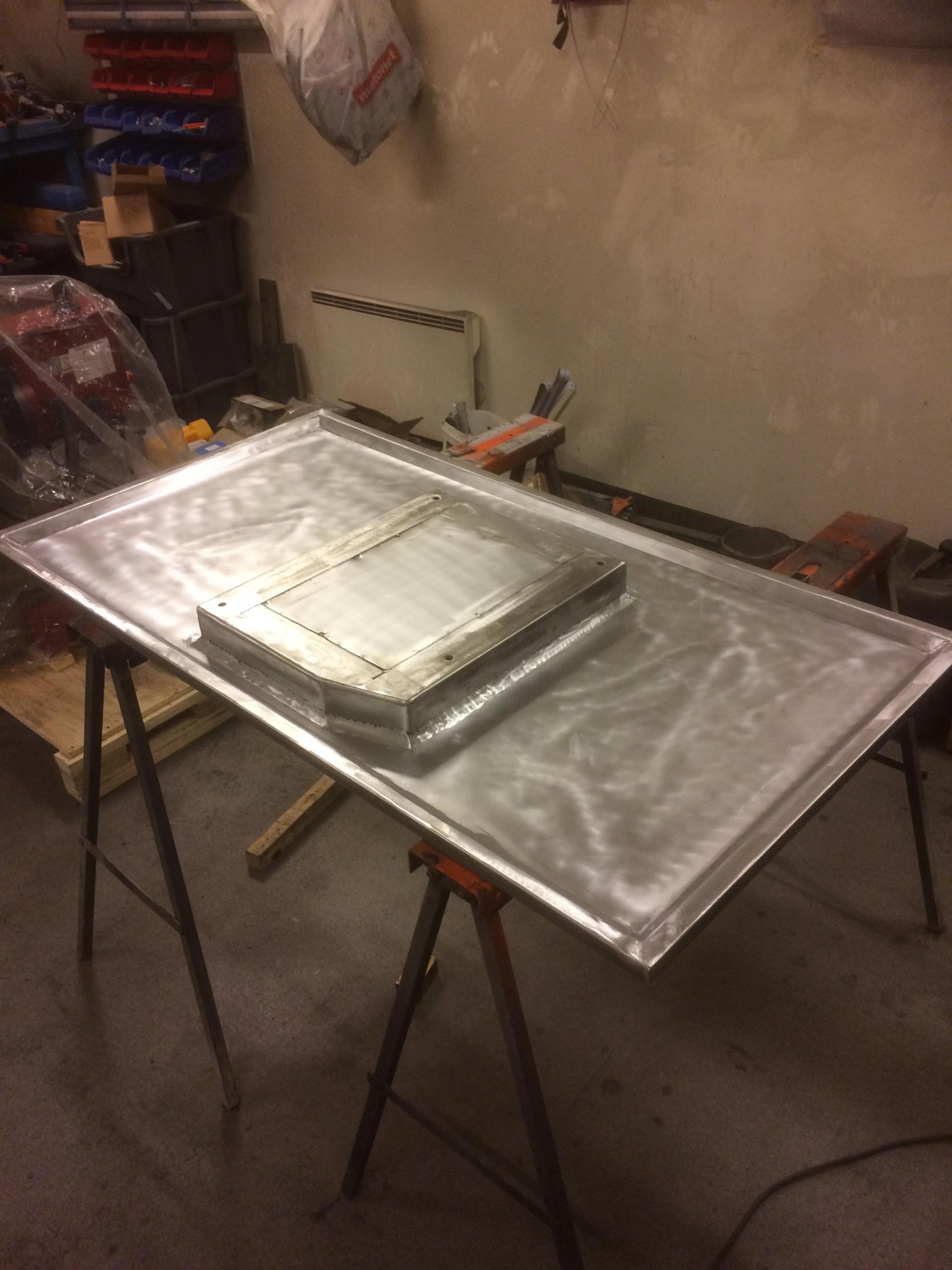

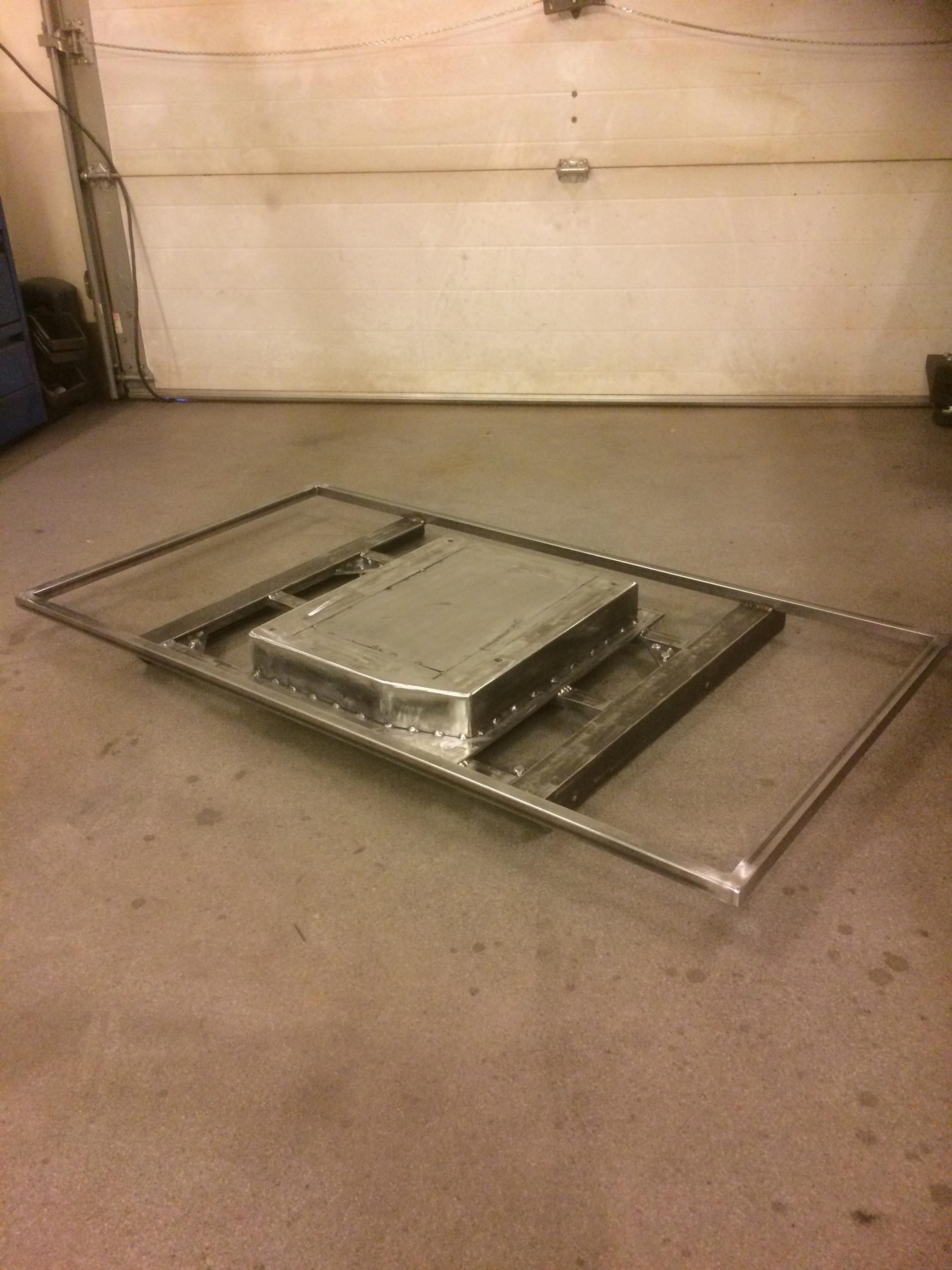

    Because of the Z-axle hand wheel position on the Sieg mill the swarf tray top was a little bit complicated to make as it needed a 60 mm high frame for mounting of the mill.
    SIEG SX3L Milling Machine Stand-img_1726.jpg SIEG SX3L Milling Machine Stand-img_1737.jpg

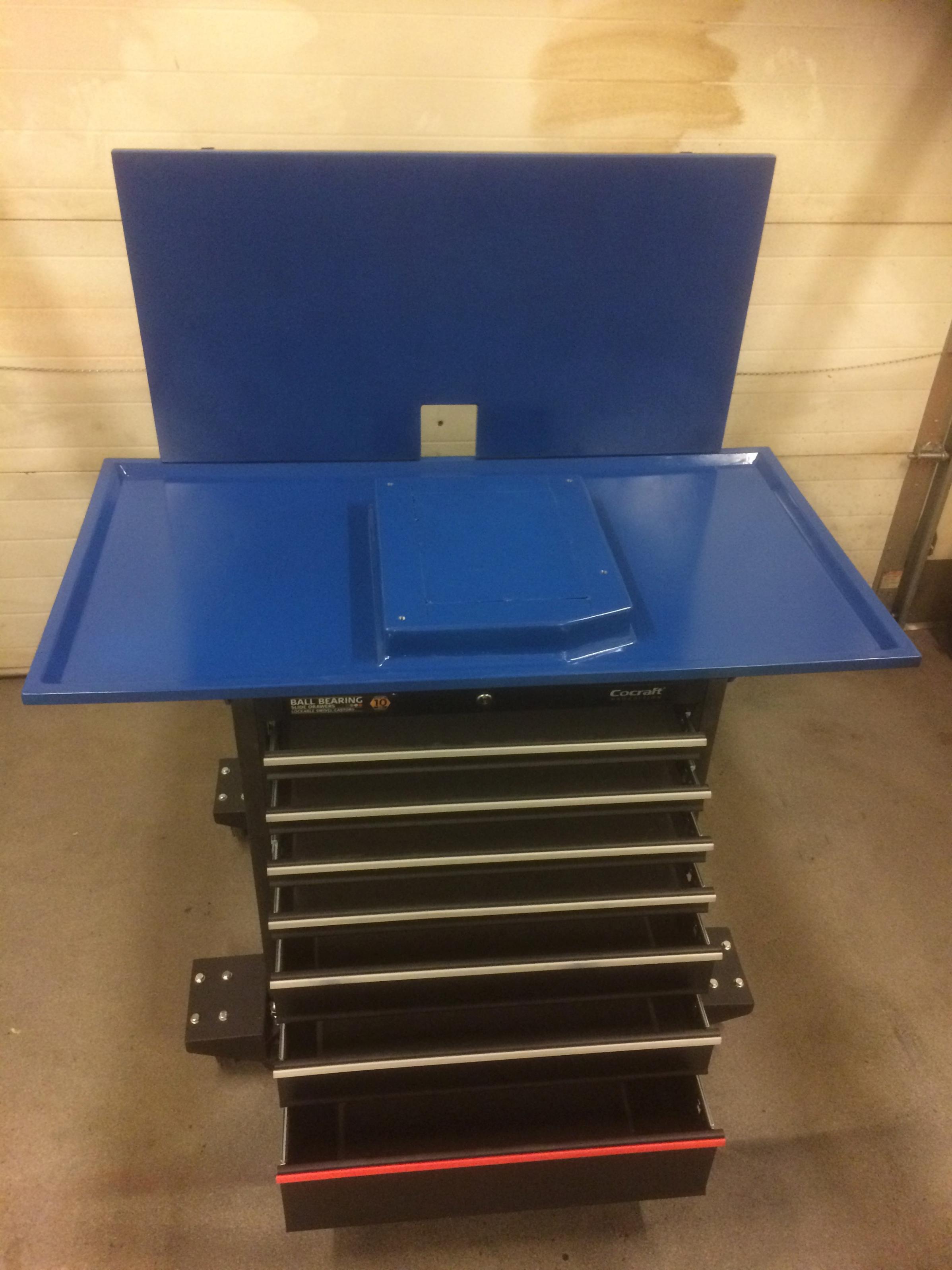

    To save space in my garage I made the tabletop only 650 mm deep. In order to still be able to access the electric cabinet of the mill I made the back splash guard removable and with a cabling opening.

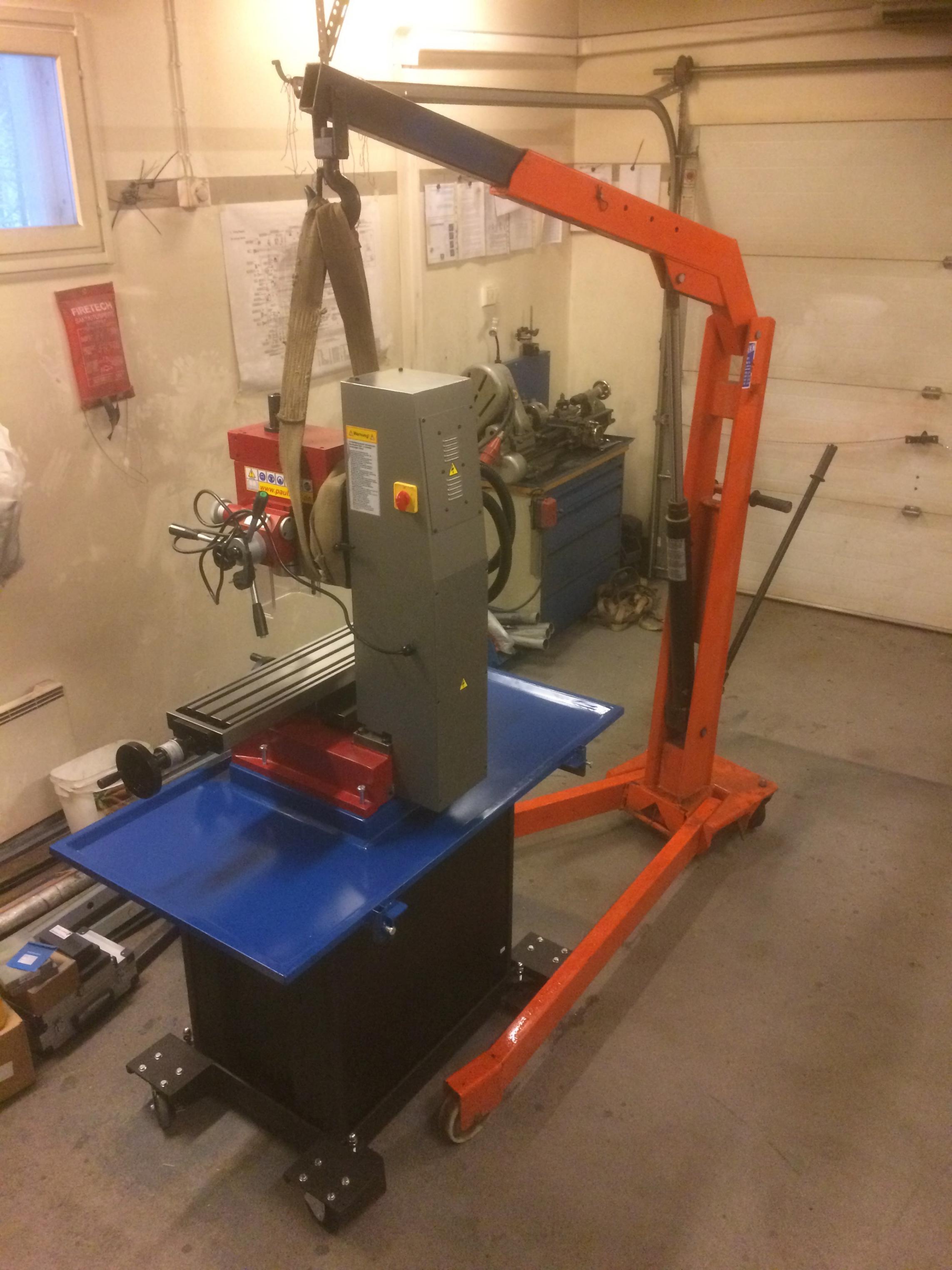

    Today I borrowed an engine hoist from a nearby car repair shop and lifted the milling machine from the transport pallet onto the machine stand. The hardest part was to get the heavy duty hoist down from my trailer and back on again - lifting and bolting the mill itself was a piece of cake.

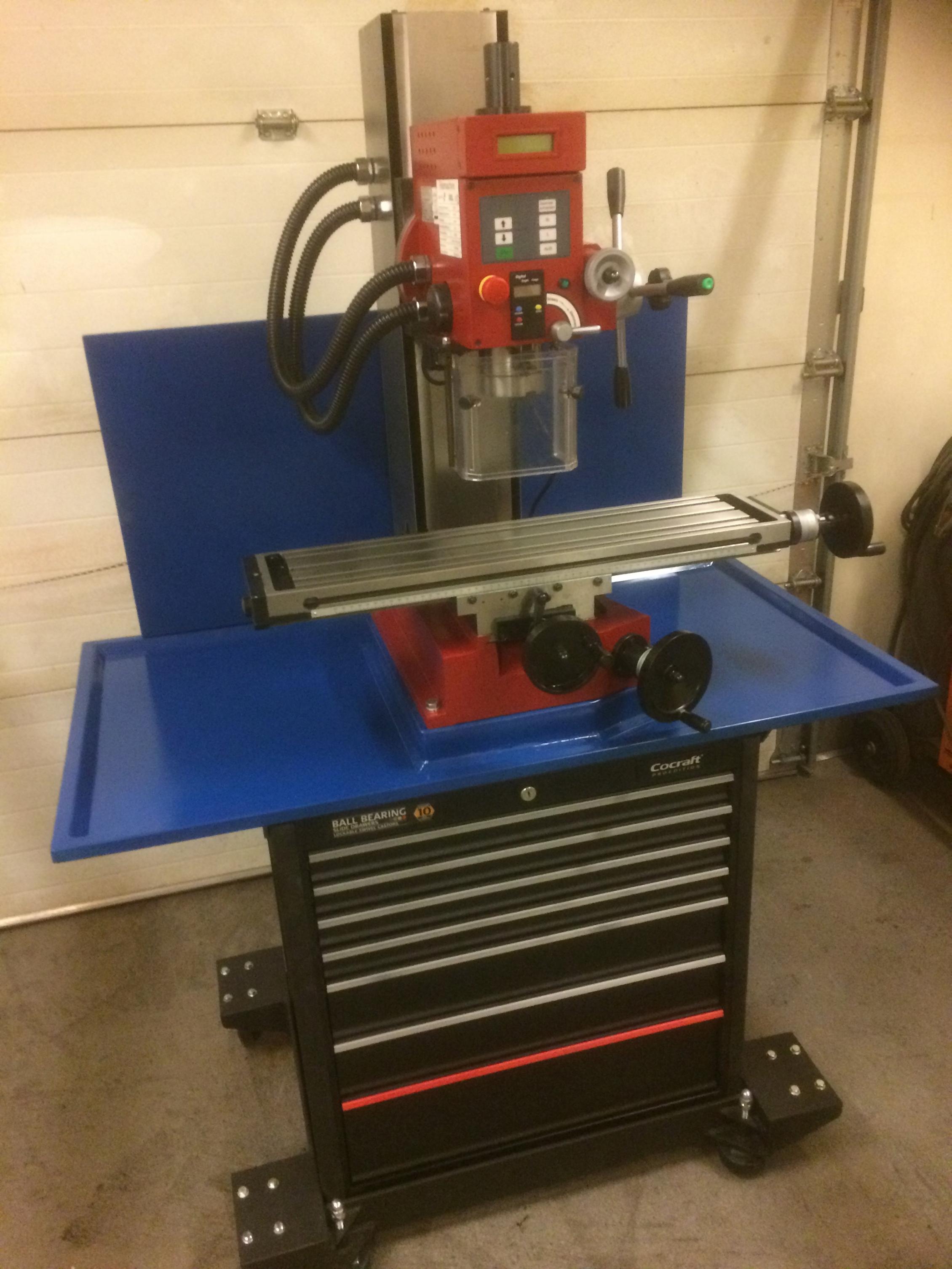

    So now I have the mill ready for fitting of the X-axle power feed and storing of some accessories in the drawers. I only bought the most needed accessories and intend to learn milling by making some accessories myself. As I am new to “real” milling I will start with some simple projects - e.g. some workpiece clamping devices. Maybe make some useful projects from Harold Hall's books. Then when I am comfortable enough with milling I probably start a sheet metal bender project...

    you may find making some side guards that clamp on or magnetic are handy for containing the flying chips to keep them out of your lunch and other things. eazy to do. plastic /aluminum, even vynel siding works great. and some small trays that fit your traywill be handy to empty and hold stuff instead of trying to keep the big non removable main tray you made nice and clean. it realy helps a lot and saves time with cleanups. and to hold all the needed tools right there when needed.

    Like someone said you might want to make some detachable sides and possibly a partial front side or eventually you will have a milling job that you would rather take the mill outside to do since the crazy things can toss the cuttings up to 10 feet a good machinist apron is a must at the very least
    I like your tray and back splash looks to be made for real easy clean up I might have gone with m 20 or larger for the feet adjusters but that is just me its not about the load strength but more about rigidity
