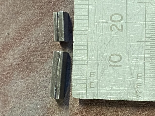

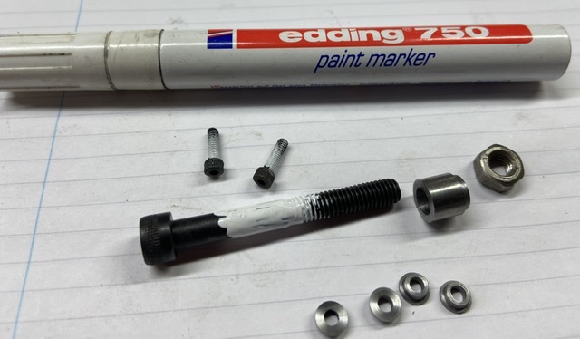

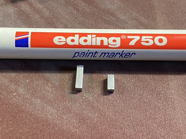

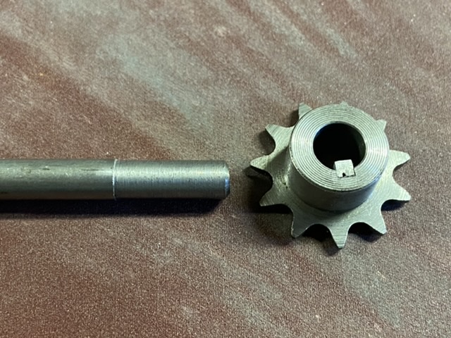

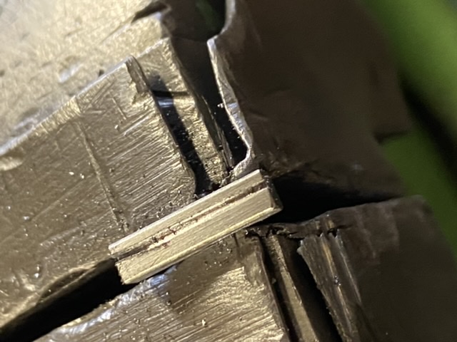

The first example is a key in a keyway. As the key is tight fit the the keyway the underside of the key is simply gouged in this case with a junior hacksaw so the solder can flow into and under the tight joint. To stop solder attaching itself to areas I don’t want it to be I use a paint pen to cover the areas to be protected as the solder will only capillary to clean surfaces.
Flux is a key component to obtaining a good joint. I mix the powder with clean water until it is slightly runnier than toothpaste. Adding a little water at a time.

Junior Hacksaw groove.
Attachment 34790
surfaces painted with pen to protect from unwanted solder.
Attachment 34791
key in place and a sacrificial bar also painted to hold the key in place.

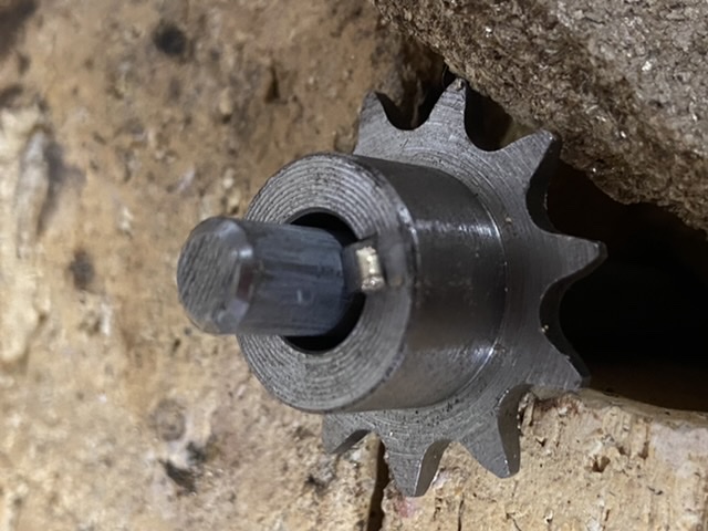

Attachment 34792

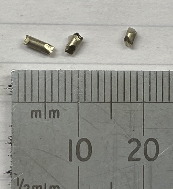

Ready for soldering flux has been added to joint. (note the small price of solder cut from a stick)

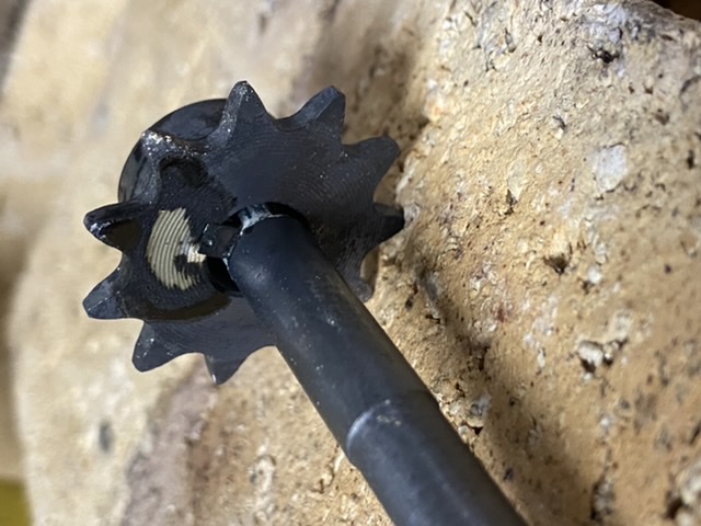

Attachment 34793 Attachment 34794
The solder has penetrated through the joint.
Attachment 34795
Sacrificial bar removed.
To clean in this case I use my shot blast cabinet but if it was a pressure fitting it would go into a acid bath. (Water and Sulphuric acid: Safety note add acid to water)

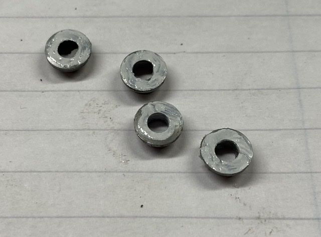

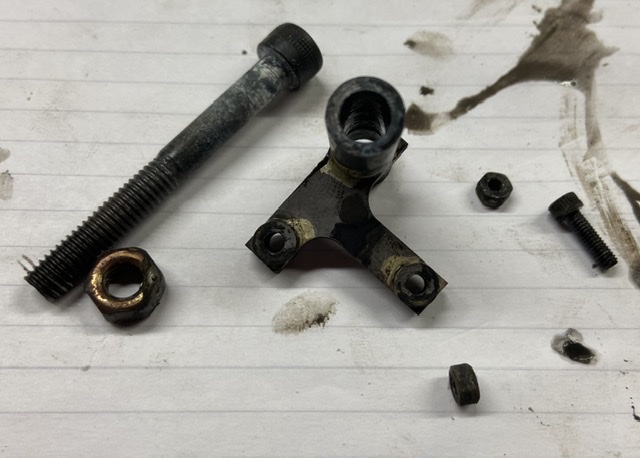

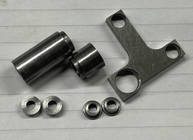

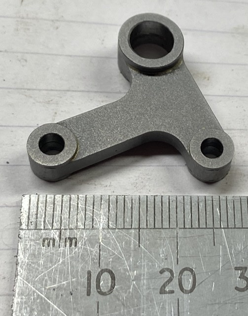

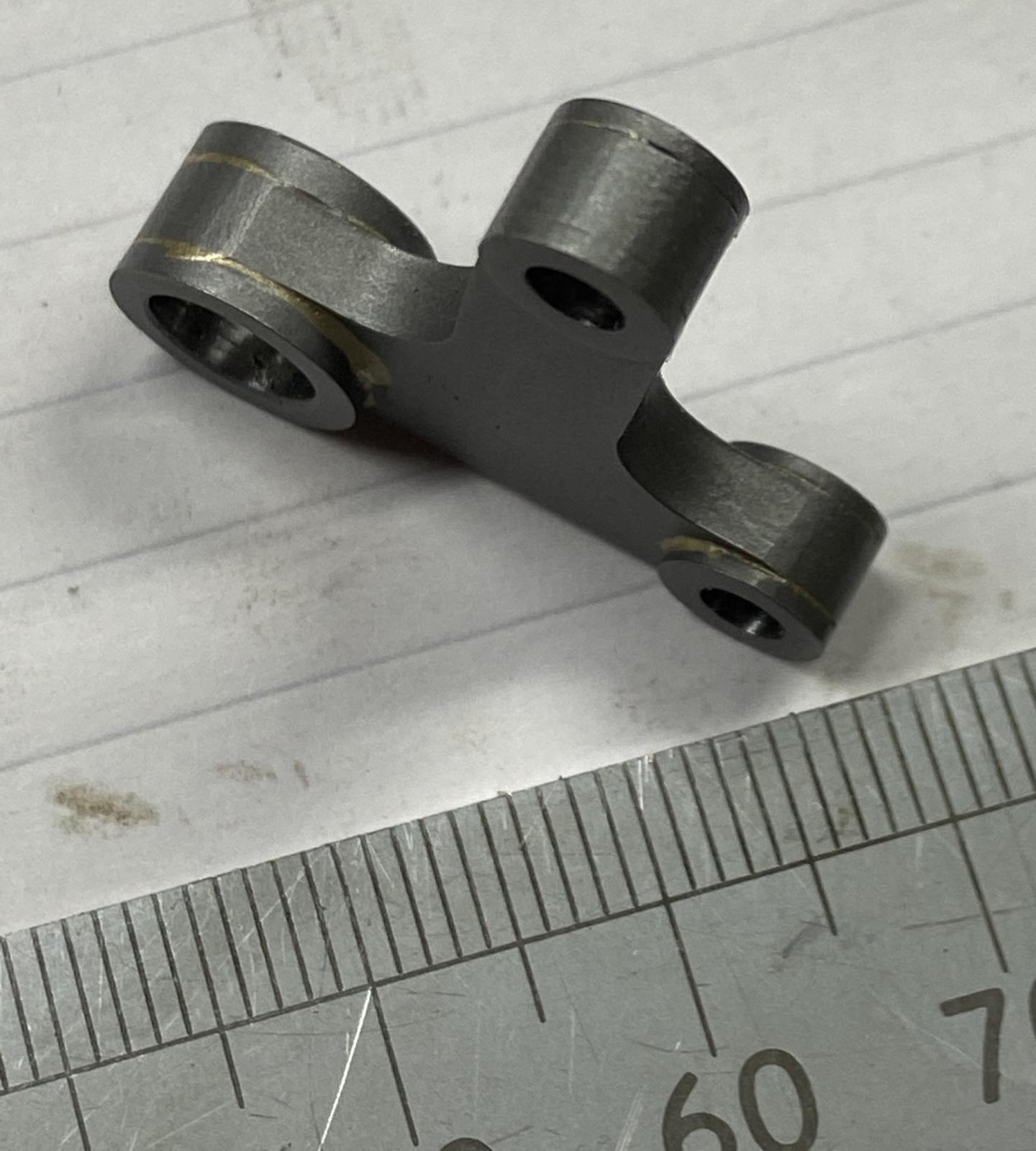

I have made a bell crank and held the pieces together with screw. Remembering to leave a gap. The bushes are made slightly wider than the mating plate so when clamped leave a small gap. The bushes are a slide fit. The screws holding the pieces together are again painted so any chance of solder bonding these in place is eliminated.
Attachment 34797
components tone soldered
Attachment 34798 Attachment 34799
Both clamping bolts and components painted.
Attachment 34800 Attachment 34801
fluxed up and solder in place. No such thing as to much flux!
Attachment 34802
soldered am screws removed.
Attachment 34803 Attachment 34804

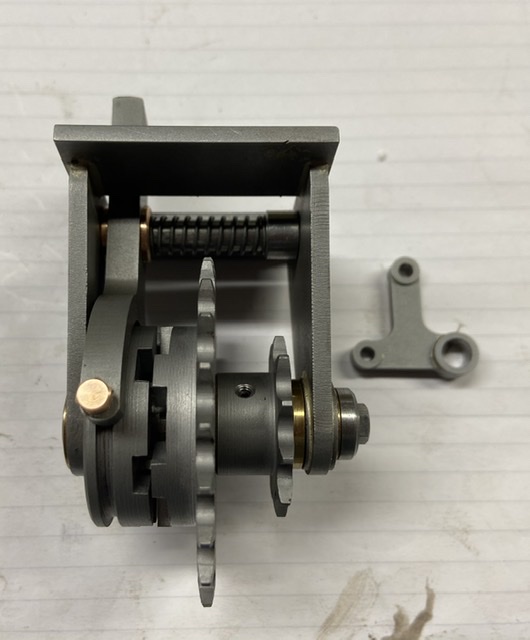

completed bell crank.
Attachment 34805
Dog clutch and bell crank.

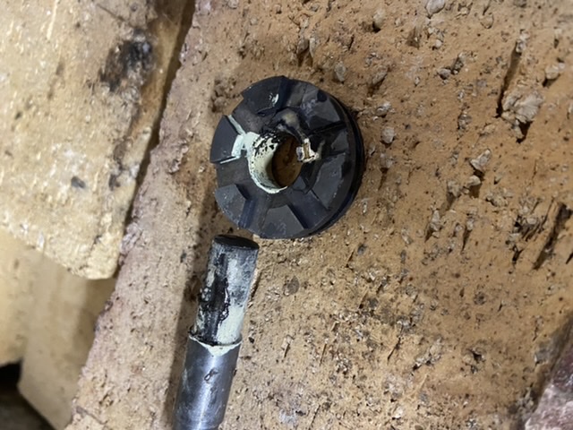

As this requires a flanged section this is rough turned over size and silver soldered in place. The shaft and the flange section can then be placed in a collet and turned true to each other and to size. The shaft is 3/16”diameter and the flanged section drilled 0.004” (0.1mm) bigger to create the gap for the capillary action.
Attachment 35027 Shaft and flange
Attachment 35028 Again to stop the solder flowing we’re it is not needed the paint pen is used.
Attachment 35029Attachment 35030 A silver soldering ring is bent up and placed on the joint and fluxed.
Attachment 35031 Heat is applied to the largest section and the heat draws the solder into the joint.
Attachment 35032 Completed shaft awaiting top bearing and locknuts.

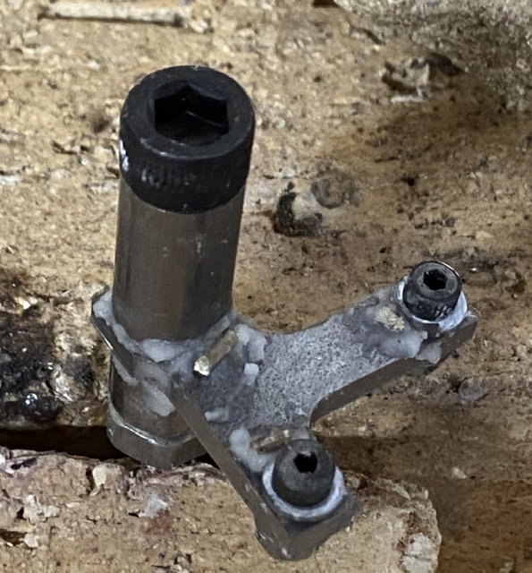

Nearly on the final stretch of the clutch linkage. The last of the fabricated parts are the two dog bone links which again are a silver soldered fabrication. The most important thing is that the links have both the same hole centres (pitch). To achieve this a scrap piece of material is drilled and tapped at the correct pitch and the ends of the dog bone linkage are held in position with countersunk screws and the tie bar fitted into drilled through holes. The fabrication is completed by soldering the joints.
Attachment 35041 One dog bone link machined ready for soldering.
Attachment 35042 Soldering jig
Attachment 35043 Screws painted to prevent solder contact.
Attachment 35044 Soldering completed.
