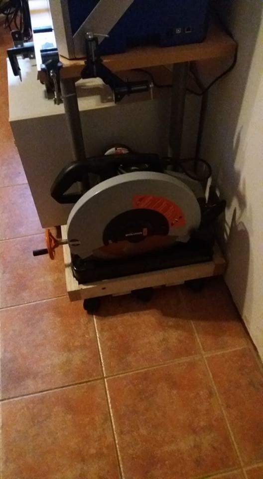

Made a simple caddy for my chop saw.
Now its easier to move and store under the table.

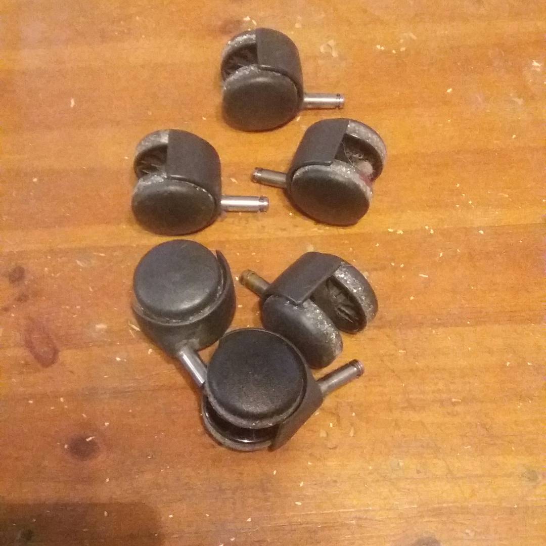

Casters are from old office chair.
Axles we're with 10mm diameter.
Drilled 20mm deep 9.8mm holes for them. Tight fit keeps them firmly on their position.

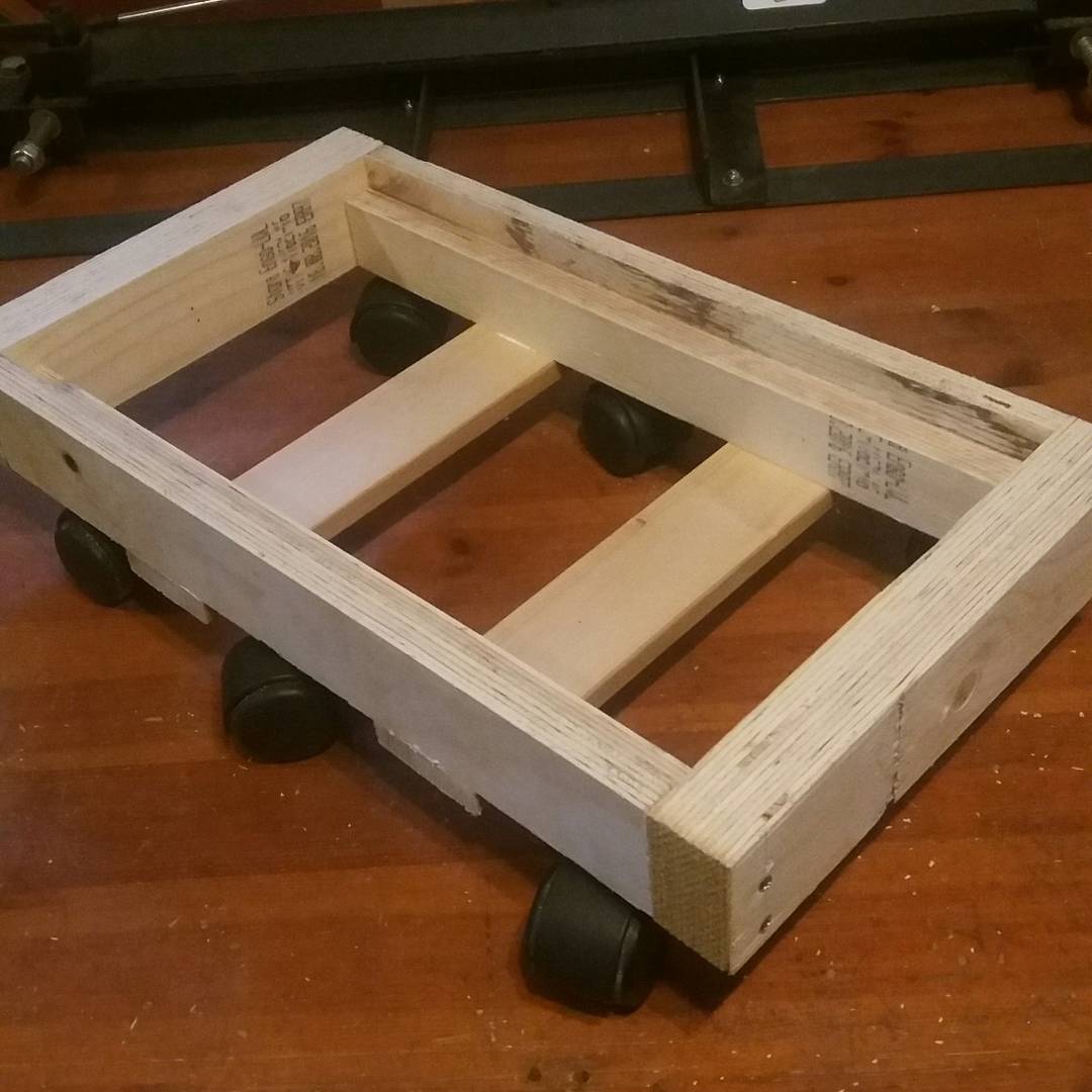

Chop saws rubber feets lays on the grooves on the side bars.
Left over 38 x 46mm plywood pole. Some board salvaged from old bed. Assembled with screws and glue.
