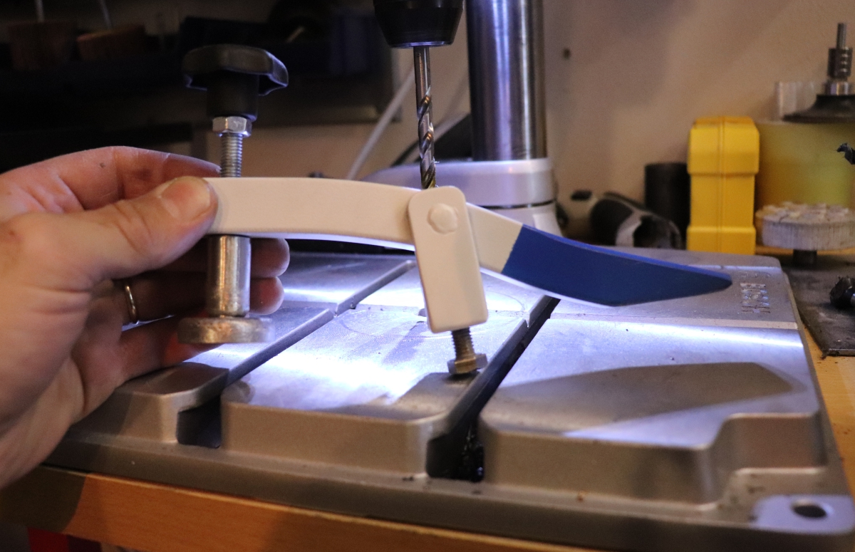

Simple drill press clamp.

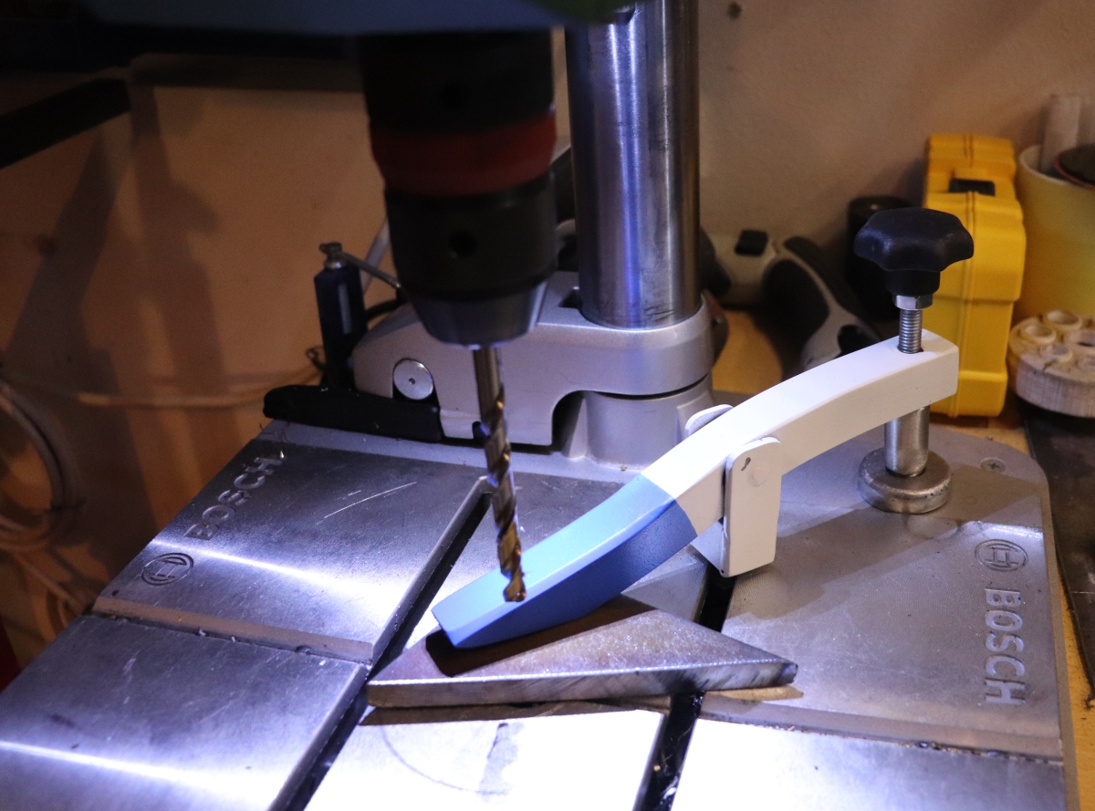

Made this simple clamp from 25 mm x 25 mm square.
Bends i did with my hydraulic press.
Attachment 31803
Attachment 31804

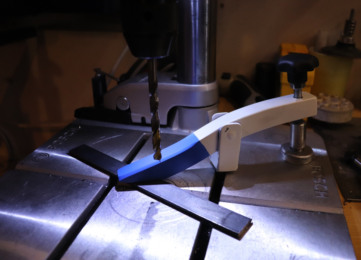

Screw head goes to T-groove.
Attachment 31805

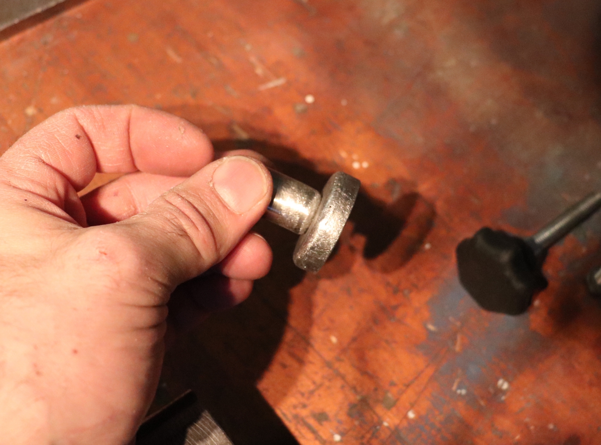

It has a swivel on the middle so, when finger screw is tightened it presses other end against the work piece.

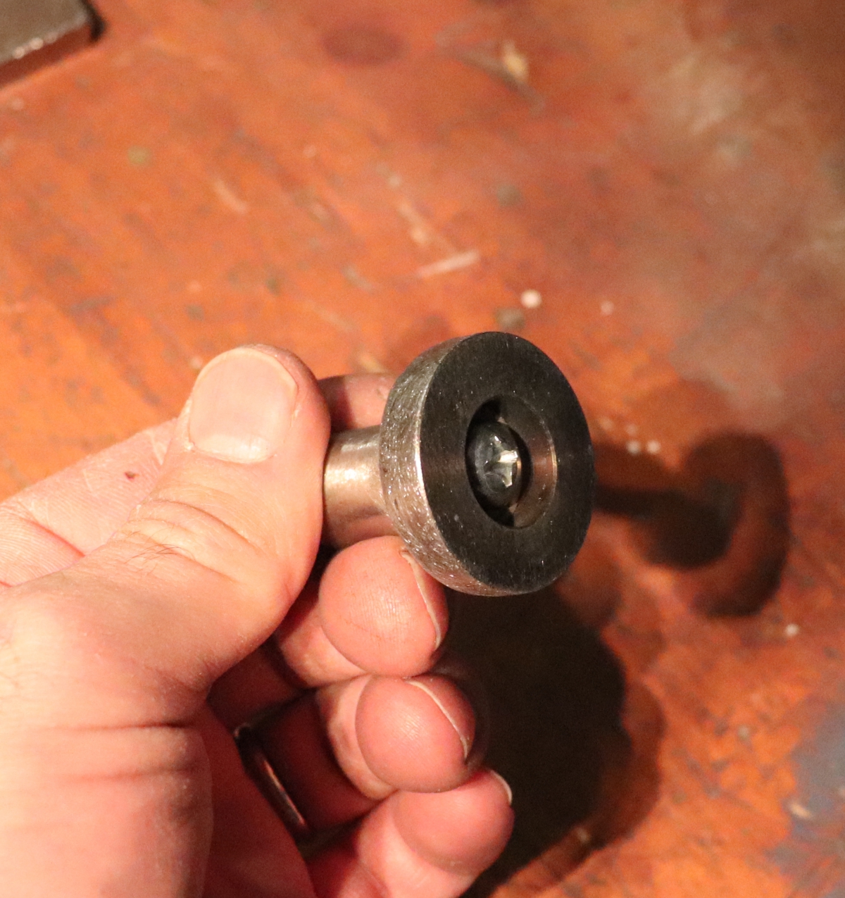

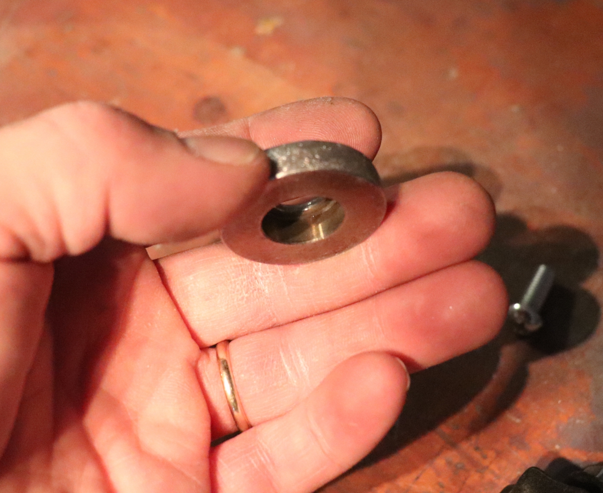

Movable jaw is made from two same sized washers, with different sized holes that are weld together around the outer edge.
Attachment 31806
Both ends of the pipe is nuts, that are pressed inside it, and then weld together.
Attachment 31807 Attachment 31808
Tightening screw, and the one that connects washers to the pipe. Are tightened against each other inside the pipe, and secured with loctite 243.

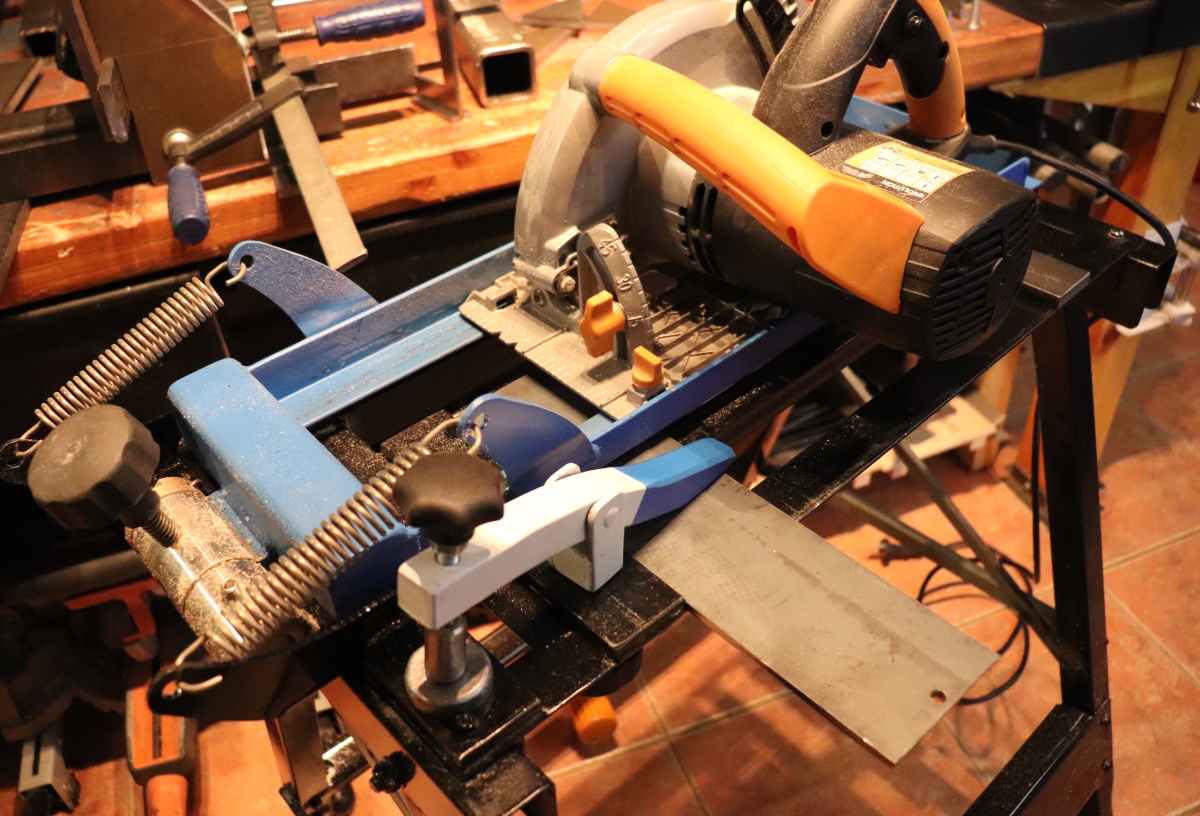

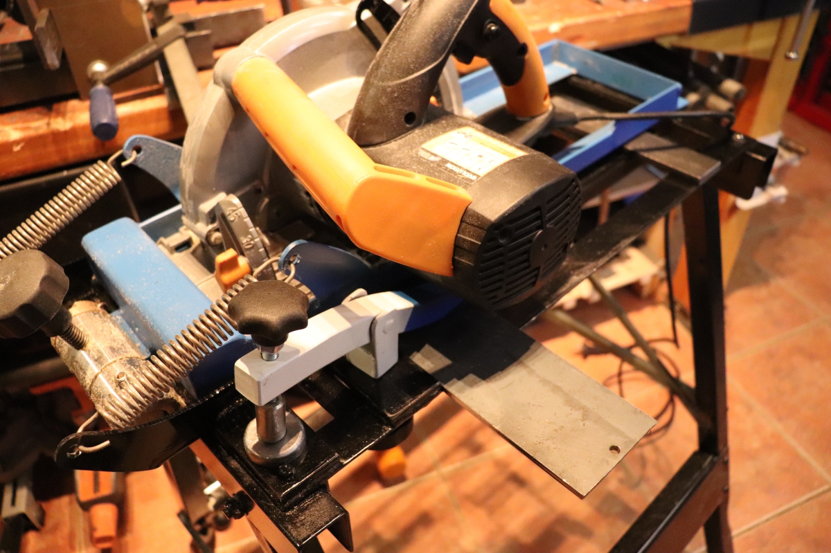

It can be used with my track- chop saw too.
Attachment 31809
Its shape doesn't block any uses of the saw.
