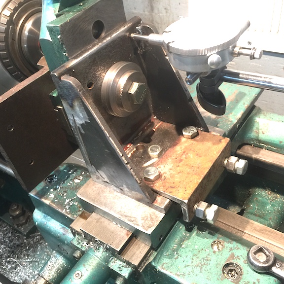

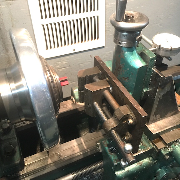

It is very simple. Remove the compound slide, Attach an angle plate. Mount the compound slide on the angle plate. Attach a vise to the slide.
Fig 01
Attachment 47406
The compound slide is mounted to the angle plate with a bolt and spacers.
Fig 02
Attachment 47407

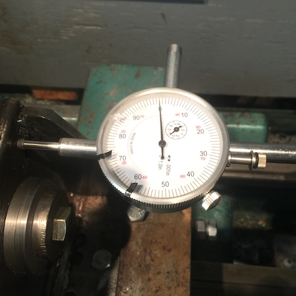

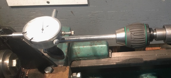

The carriage hand wheel is not graduated. A dial indicator touching the back side of the angle plate is used to measure carriage movement. The indicator is mounted in the tailstock drill chuck.

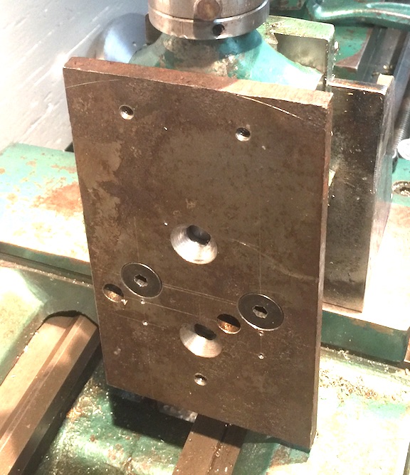

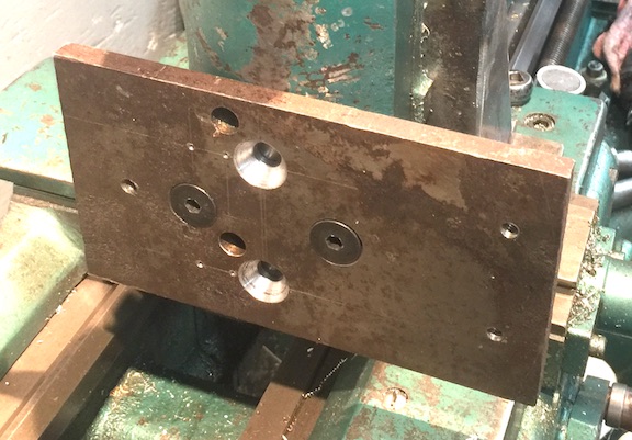

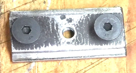

My drill press vise is mounted on a 1/2 steel plate for ease of clamping to the table. That plate was drilled to bolt into the T-nut groove on the slide. It can be mounted either horizontal or vertical. Originally, it was attached using hex bolts. The bolt heads interfered with the movement of the vise jaw. The most recent modification was to counter sink the vise plate to accept flat socket head bolts.
Figs 05, 06
Attachment 47410
Attachment 47411
Initially a piece of 1/4” thick bar stock was used in place of a proper T-nut. The threads in that thin material did not seem adequate. The 1/2” thick T-nut below is the first part made with the mill adapter.
Fig 07
Attachment 47412

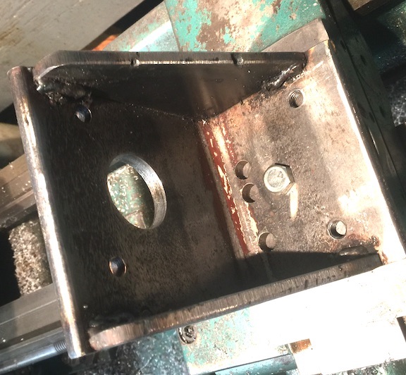

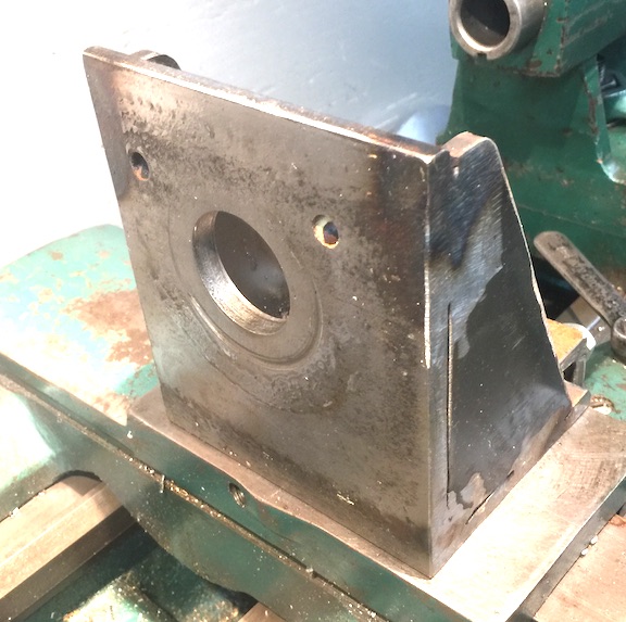

The angle plate is simply a piece of angle iron bored to accept the mounting boss from the compound slide. Reinforcements are welded on each side. It is attached to the cross slide with a single bolt
Fig 08, 09
Attachment 47413
Attachment 47414

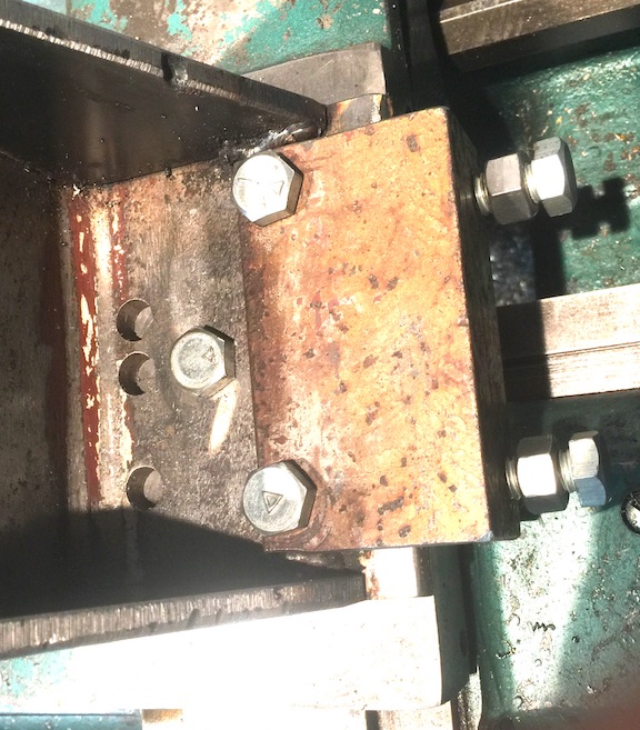

The singe bolt is not adequate to keep the angle plate from rotating. It was necessary to make an adjuster to assist when properly aligning the angle plate to the spindle axis. The adjuster also prevents rotation after the set up is complete.
Fig 10

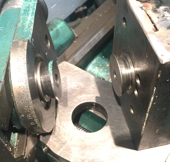

The boss on the compound slide was copied and bolted to the angle plate. The boss on the slide is longer than the thickness of the angle plate, this requires the use of a spacer to tighten against the plate.
Fig 11

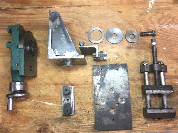

The individual parts are shown here. None of the parts are complex. For small light duty milling jobs, anyone should be able to create an adapter for their lathe. I have not provided any dimensions as very few people will have the same lathe of the same materials laying around to use.
Fig 12

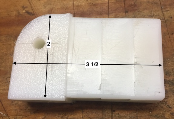

The most recent part is just a piece of high density polyethylene to fit another tool I have been working on. It was necessary to cut 0.062 from each of the 4 sides to make a tight fit into a piece of rectangular steel tubing. I considered using a router, but thought milling would be a better option. The router bit was held in a collet chuck. If you notice the lines in the milled surface are about 0.004 steps where the part was set over for each pass. This is the first time I have milled a surface that required more than one pass. For now it works.
Fig 13
