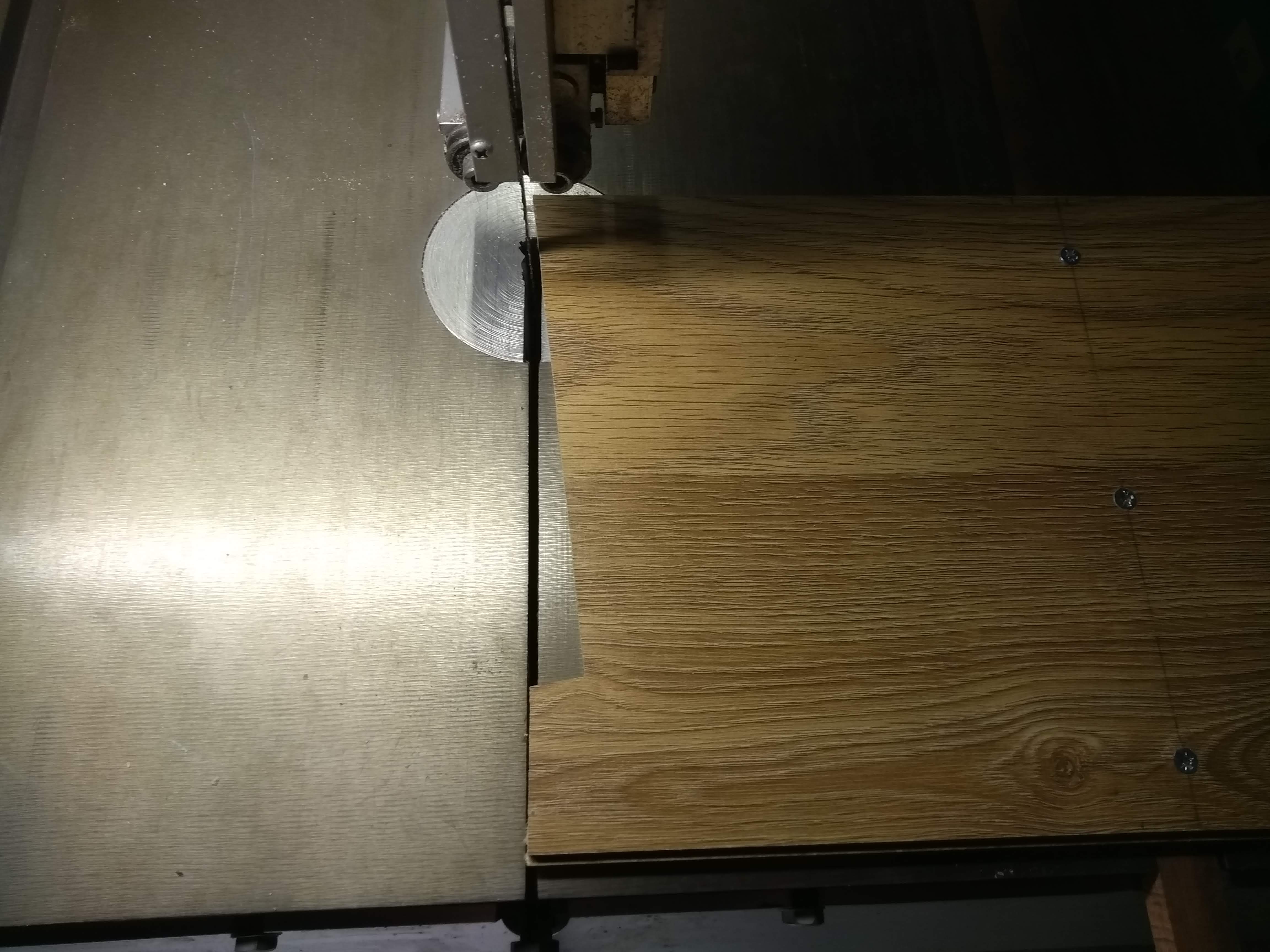

    Doing a cabinet install next week and wanted some shims. Wooden shims are not commercially available here, only plastic and usually not tapered so I cut my own. When at home I just cut them to suit the job but since I will be off site I wanted to make a stack of them.
    Simply made from a runner of hardwood to fit the mitre slot and the top piece is a scrap of laminate flooring. Tacked in place with CA glue and then a few screws added. The edge is trued using the bandsaw and then I marked out a 5deg wedge for the shims. I make my shims from offcuts and the jig works great, made 2 dozen shims in a couple of minutes. Jig itself took less than 10minutes to make.

    Often when I need a wedge for a hammer handle I will use 2" long end cut off of a hardwood board set the vice in my horizontal band was to a slight angle then after the first cut merely turn the board over and cut another. Longer end cut pieces make longer wedges.
    A 1 by 12 or 2 by 12 will yield several wedges before the piece of wood becomes too short to safely hold
    Rorschach's simple jig does the same thing only his jig insures all shims/ wedges are uniform providing he has a fence set up so his jig becomes what some have called a boat.
    I have found that if I cut a mesquite log into board shaped chunks they make excellent handle wedges

    No need for a fence with this jig.
