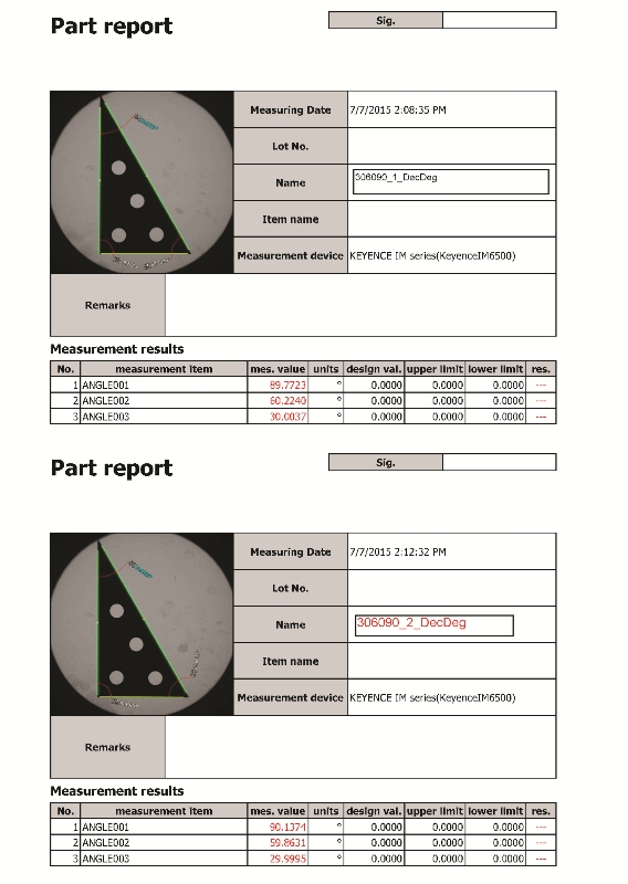

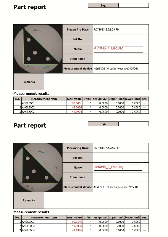

I had an experience last year where I picked up an across the pond variety of Angle blocks (45-45-90 & 30-60-90) for set up and granite work on my meager budget. The specs said, "back then" that they were good to ±20 arc second and for $30, even if they were ±50 arc seconds I would be thrilled. First thing I did was set them against a known good 123 block and checked for daylight...Oh My. Was able to put a 6 thou feeler gauge on the far end of most sides. I contacted them and they sent me another pair...and ask if I would change my initial review of them because they didn't respond to my contacting them. When I checked the new ones they were only slightly better on one angle and worse on the others. The 45 was the best but the 30-60-90 was something on the order of ~400 arc seconds. And worse was the two sets were different in size fairly significantly. The difficult thing was the Obliqueness of the triangles and trying with my meager tools to measure and calculate the real error.
Had lunch with my son a week after and he said to give them to him and he'd measure them on their Hi-End Keyance IM-620 visual measuring system good to <.5µm...and calibrated regularly. Here are the print outs from his test.
Attachment 9817Attachment 9818
Basically these show that the 30-60-90 were out of spec by 25-41 times the spec, but the 45-45-90's were only out by 1-2.5 times. Obviously the 45's were Very usable for my meager shop but the lopsidedness of the 30-60-90 were pretty much paper weights (or maybe a chip scraper as Paul suggests)...unless I could use Marv's idea of compensation. It would mean needing to mark them permanently some how and having a way to use them with some method of compensation. Would love to hear your thoughts on this Marv.

Perhaps there is a way to lap the surface by clamping the 30-60-90 to the correct angle (kind of a catch 22 but can be done) and systematically remove the taper. There are ways to set up the lapping so the part (the 30-60-90 angle block) is lapped but not the reference surface.

Thanks Paul. I have considered lapping them by holding the long side (hypotenuse) as a reference and work on the 90, but feels difficult to adjust the obliqueness with any thing I have to accurately hold the correct angle and allow the slow whittling away till I get there. The other thing is my height gauge only measures to 3 places plus a floater half, and the long side of 30-60-90 is just slightly bigger than my 3" 10'th mic, which is my largest. It would be difficult to check to any accuracy as I go along and wouldn't want to bug my son. Need to crunch some numbers to see what I "could" hit with 3 decimals and how I might hold it to get there. I'd love to salvage them as the 30-60-90 is the one I really wanted but just couldn't justify sending them out or much more time on them.
Interestingly, both sets of these have one side that is ground perpendicular to the plane and the other two are ground in the run. Definitely Friday units while the QA people were out to lunch.
