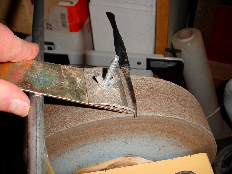

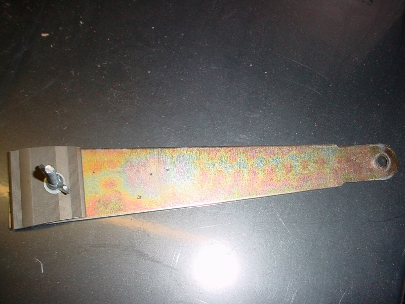

    Here is a very slim jig designed to hold small blades that must be sharpened with a very low angle :
    So the long bottom part is a leftover cut of a garden door hinge, and the top jaw is a piece of aluminium door threshold.
    The bolt is stuck with metal epoxy.
    Cheers !
    Christophe
