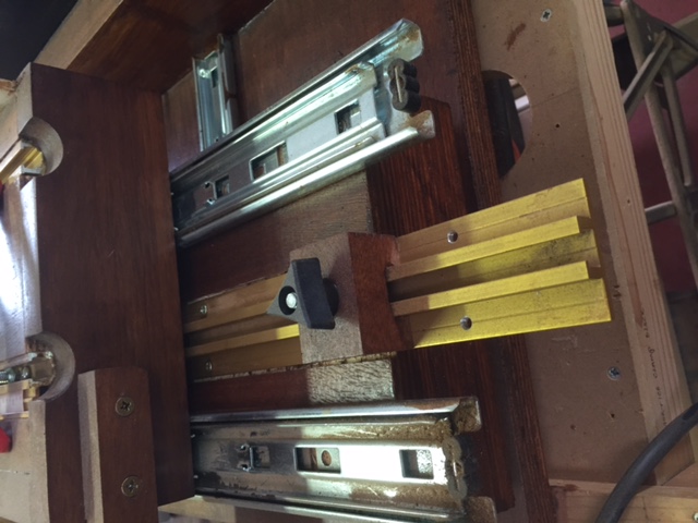

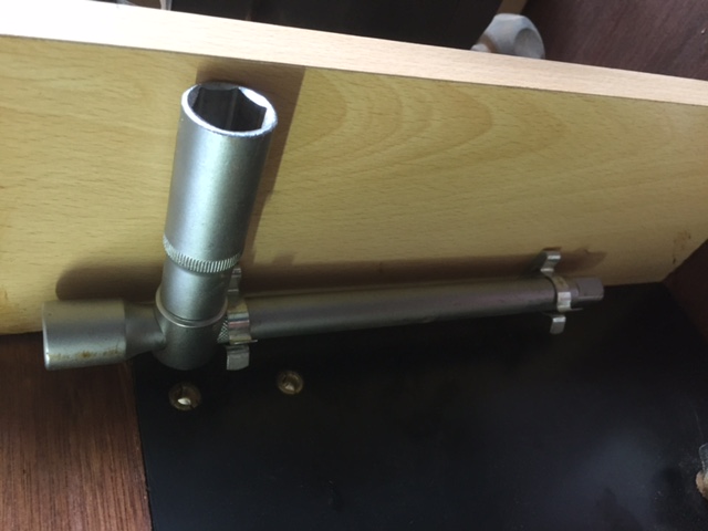

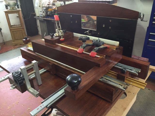

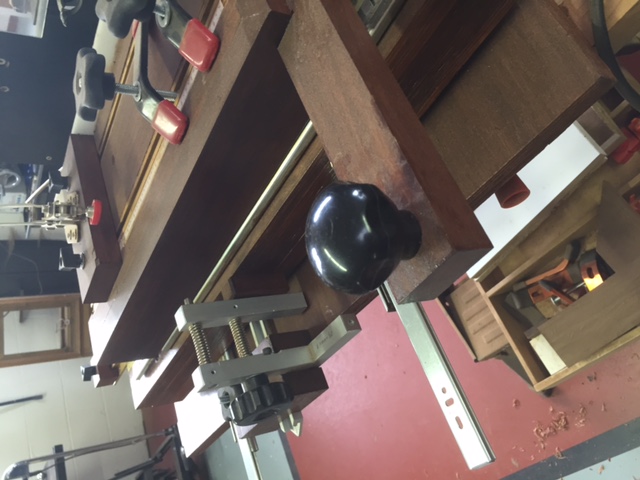

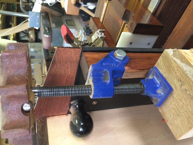

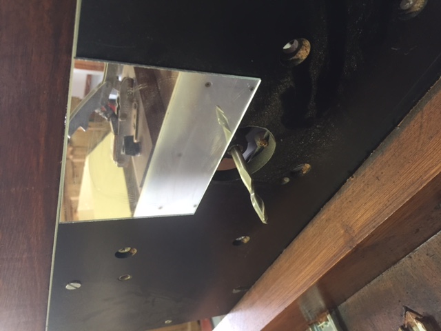

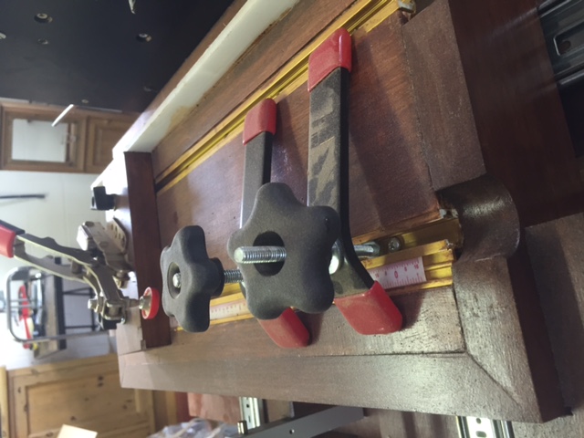

Here are a few more pics.Attachment 4487Attachment 4488Attachment 4489Attachment 4490Attachment 4491.
The first one shows the clamping system; I have other attachments that I use for miter cuts etc. the 2nd pic shows the operating handle with the gizmo that controls depth of pass in the background. This is my favorite aspect of the machine as it allows me to control the depth of each pass down to 1/32" if necessary. The 3rd pic shows one of the stops. 4th pic shows the router cutter protruding through the back-plate and the handy mirror for viewing the blind side of everything. The last pic shows a useful spanner that I keep clipped to the machine; it is used for unlocking the collet when changing cutters.

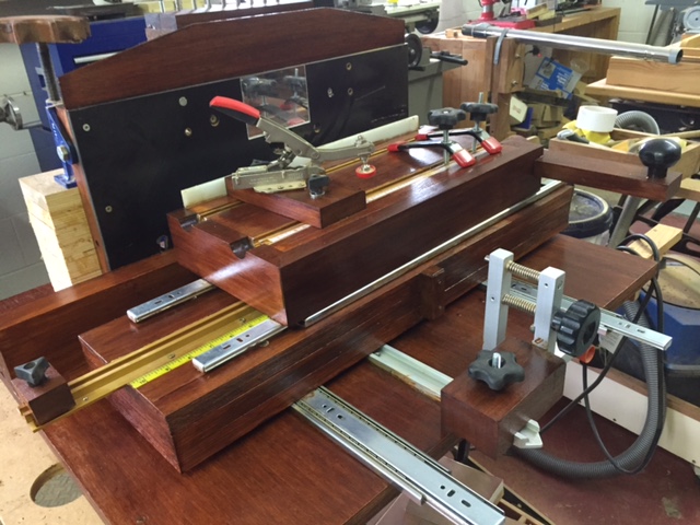

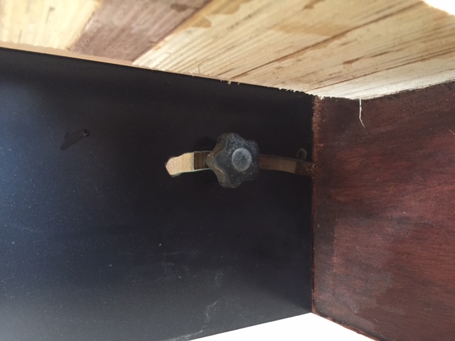

Height adjustment to Slot Morticing Machine
Hi Toller,
Height is adjusted by first loosening a knob at the rear that locks the router support plate
and then adjusting the height by turning the adjuster that is made from an old Record
clamp head. See pics. This cannot be seen from the front-view pictures.
Attachment 4503 Attachment 4504
