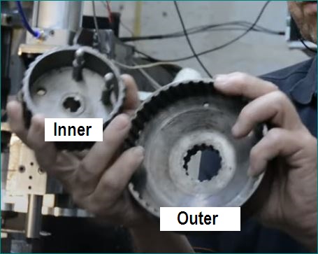

Cutting one keyway (maybe a few) might be feasible manually., but something like the clutch baskets that I showed is another matter altogether. I know someone who did it. It took him more than a day for the outer only and for some days afterwards he could not move his arm. If I did not have the pneumatic cylinder I would have got one. If I couldn't get one I would have made it with a motor powered crank.
I prefer the cylinder because it gives me some control options. As I had it the video it cycled automatically, I was hoping that with the soft ending set stiff at the retracted end that it would "rest" long enough at TDC for advancing the feed. That did not happen and I was concerned about dragging the tool when feeding on the upstroke. Since the video I have added an Arduino to the mix. When the ram returns to TDC there is an adjustable time delay (0 to 2 secs) to give time for even a geriatric operator to advance the feed without dragging to tool. I would not have been able to do that with a crank system.
For the inner clutch basket a form ground milling cutter would the job well, but that would not work for the outer basket.

Why, Tony? I would just turn the bit 180 deg and plunge away on the outside?

I do not understand your first sentence, I wonder if you misunderstand the requirement.

Yes, I had the features reversed. I thought you were talking about the inside and outside (i.e., outer) of the same part. When, in fact, you were talking about 2 different parts. When you mentioned "inner" I thought you were shaping the inside of a basket. But you were referring to the inner-basket and not a particular surface at that point. Your video was clear, I just saw 2 baskets and thought you wanted to do both.
Attachment 39874
I can't see your features but I assume you could put a relief on the inside of the outer basket so the chip could curl into it. I see "relief" often on internal ring gears.
