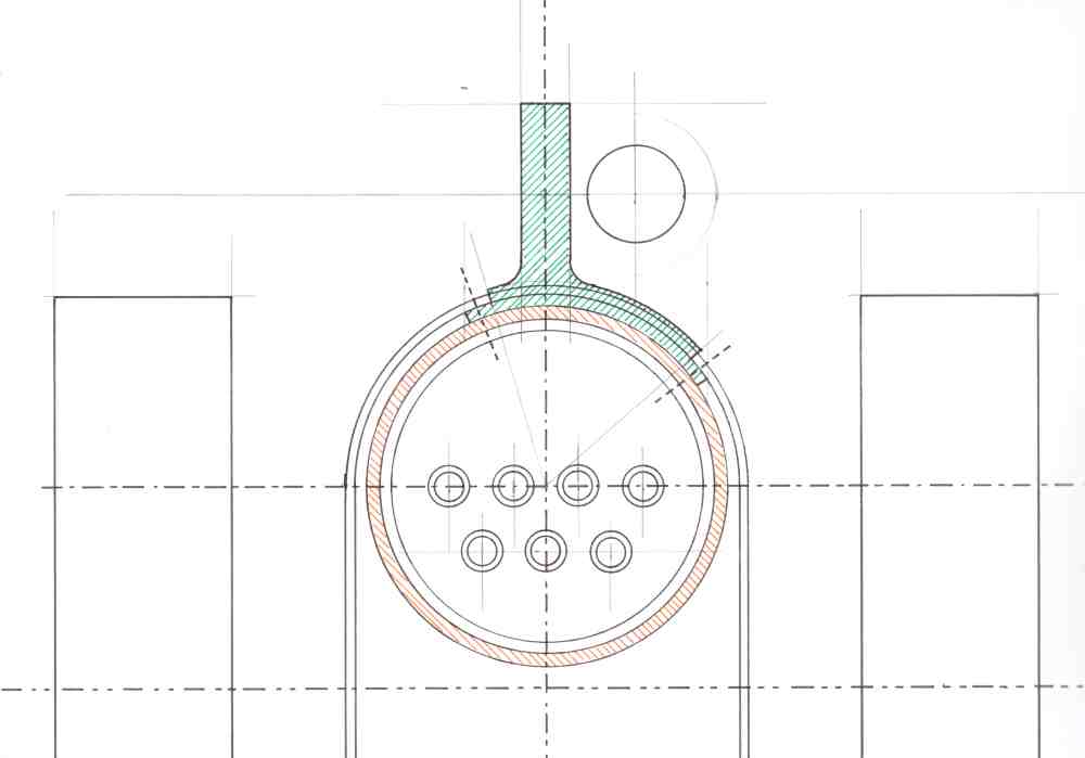

    Hi, have been learning how to form the endplates for a boiler, used a hammer to round the edges:
    But then decided to make a forming tool
    Made two endplates for the traction engine boiler
    then drilled holes and made up 7 off 3/16" pipes using brake tubing
    More info around the heat treatment is here
    glue-it.com
    The next stage is to make up the other fittings and silver solder it all together, Best regards, Nigel
