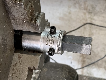

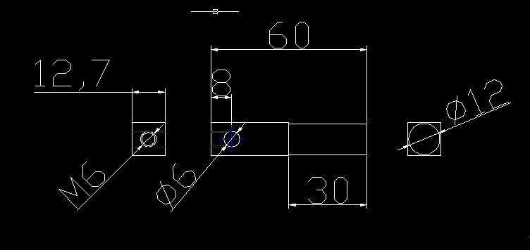

So I quickly fabricated this holder. Basically 60mm of 1/2" square bar from the scrap bin, Turned the one side down to 12mm to fit into the boring Head. Here I used my socket adapter as I do not have a 4 jaw chuck.
Attachment 32671

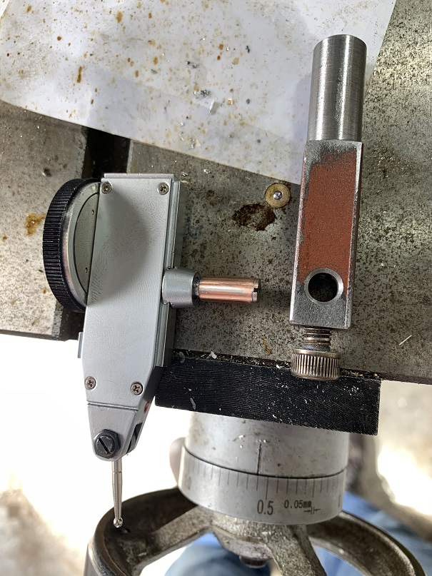

The other side a 6mm hole to mount the gauge and an M6 in the bottom to clamp it all secure.
Attachment 32672 Attachment 32673

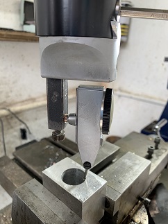

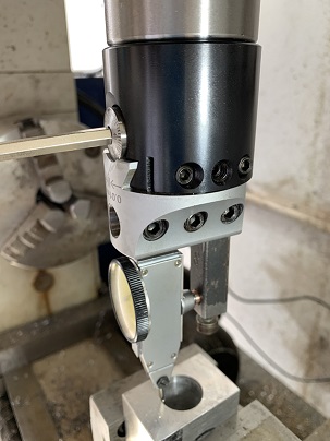

Worked like a charm.
Attachment 32674 Attachment 32675
