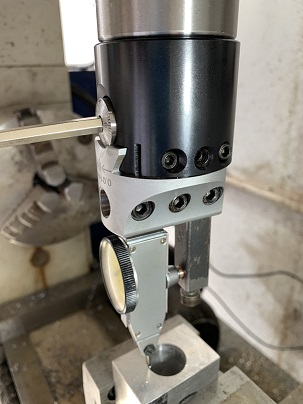

    Due to my Milling Machine being so small I had to move the vice to get the 20mm Drill in and out of the chuck.
    I needed a 21mm hole that needed to be a tight fit for my 12mm linear bearings. The 20mm drill drilled a 20.5mm hole so not a lot for me to play with to get the hole to a 20.95mm press fit.
    I had a small dial gauge that I wanted to use as an edge finder but never used as I got a very inexpensive commercial variety.
    A quick search on this forum and even on Google did not reveal anything. I hate to reinvent the wheel.

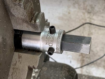

    So I quickly fabricated this holder. Basically 60mm of 1/2" square bar from the scrap bin, Turned the one side down to 12mm to fit into the boring Head. Here I used my socket adapter as I do not have a 4 jaw chuck.

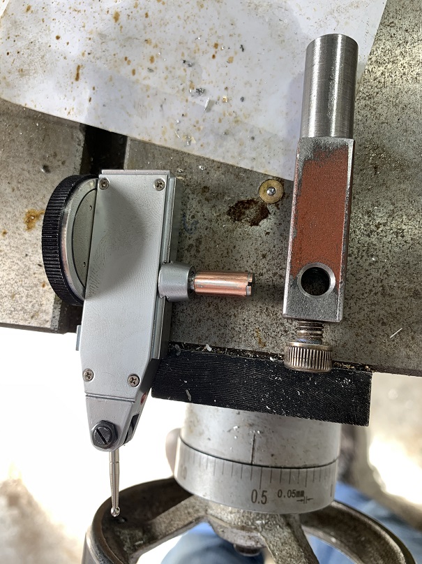

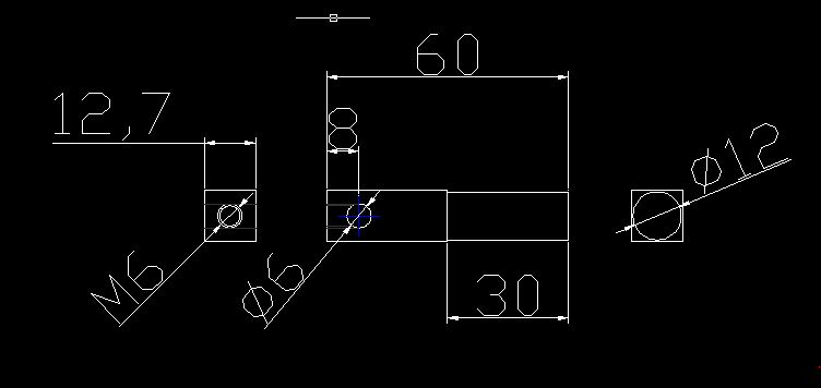

    The other side a 6mm hole to mount the gauge and an M6 in the bottom to clamp it all secure.
    Small Gauge holder for Boring Head-bb-gauge-holder-4.jpg Small Gauge holder for Boring Head-drawing.jpg

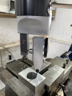

    Worked like a charm.
    Small Gauge holder for Boring Head-bb-gauge-holder-2.jpg Small Gauge holder for Boring Head-bb-gauge-holder-3.jpg
