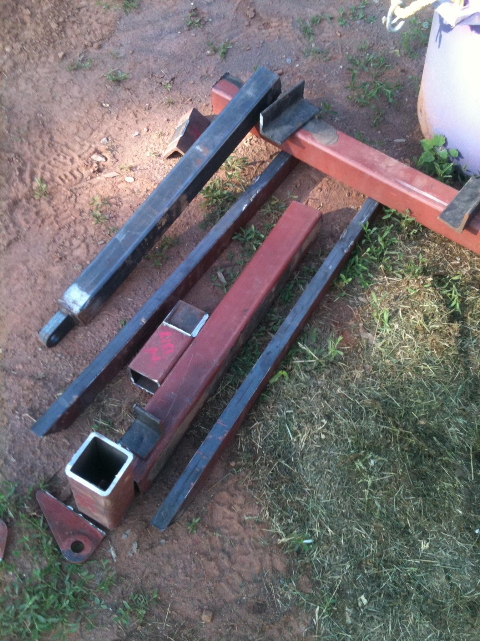

    Here is the steel bar and tube cut out.

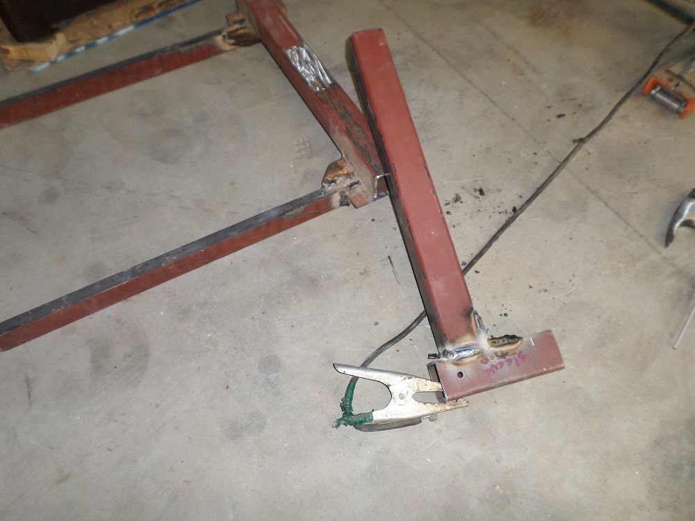

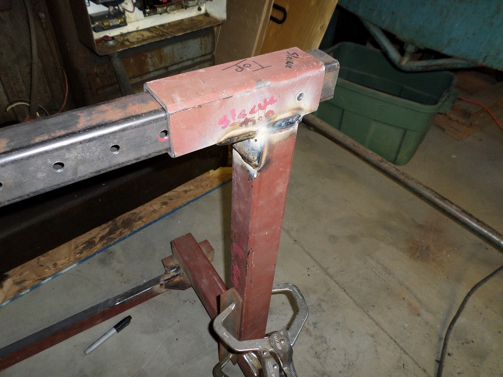

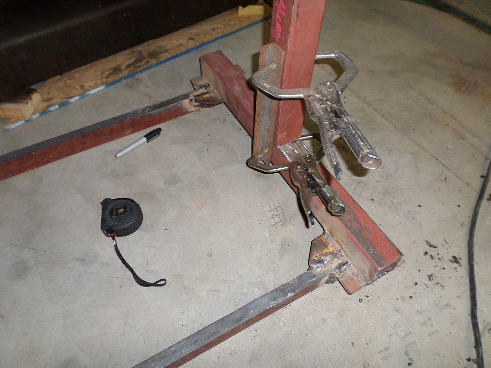

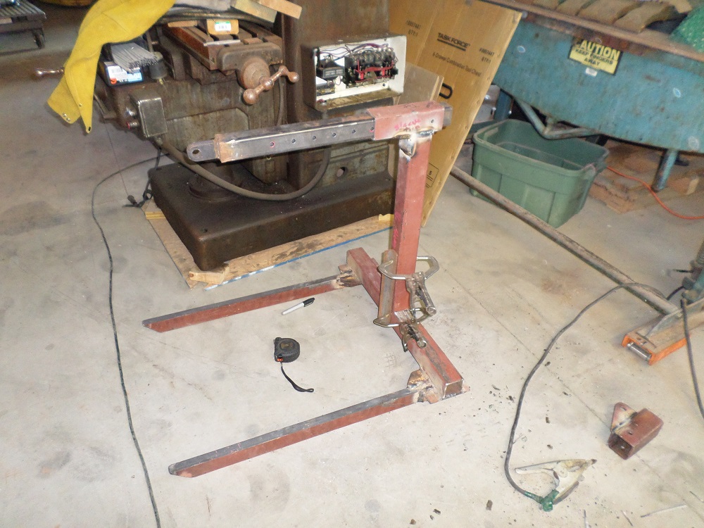

    Then I started welding things together.

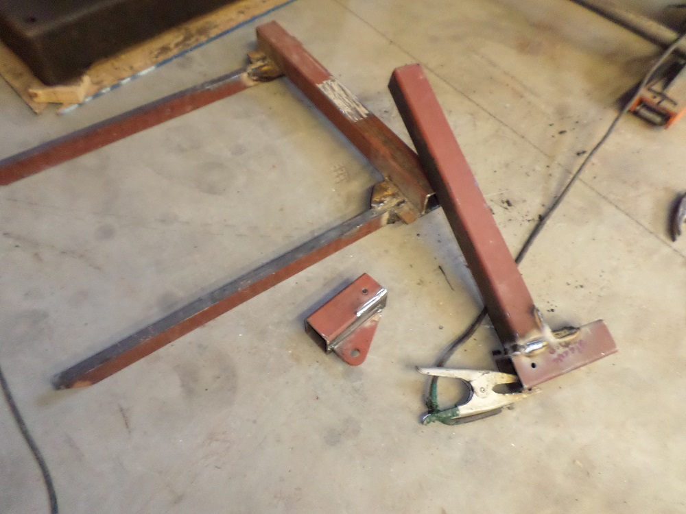

    I continued with the welding....
