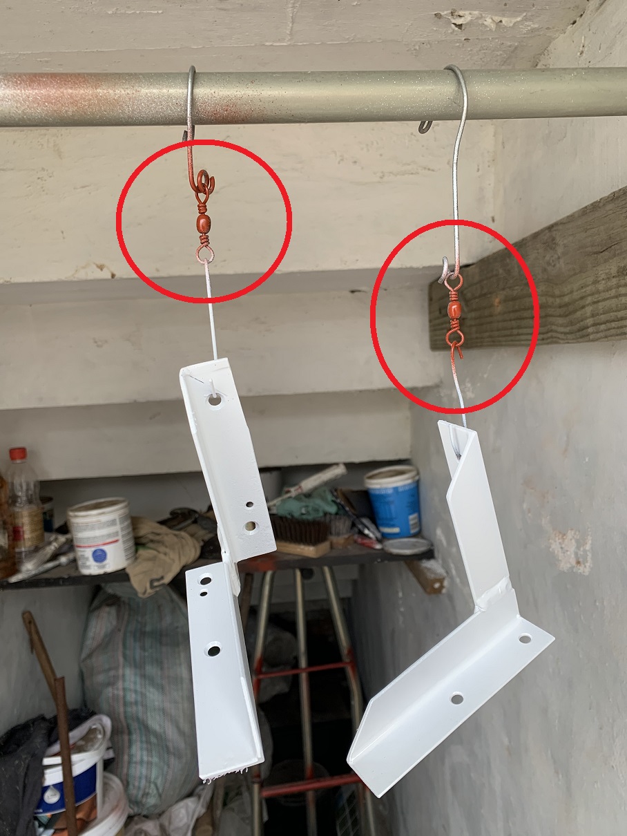

    I often have to stray small little brackets and this is usually done with a rattle can.
    I usually just hang then from the workshop roll up door. Problem is to go all the way around at one stage you are actually spraying into the workshop. Something I try and avoid because my newly sprayed MG TC is directly in line.
    The solution is to use some fairly heavy duty fishing swivels. If you spray clever enough you actually turn the job with the force of the paint, although after a few months depending on how often you spray, they do tend to seize up, but a quick dip in some thinners and they are as good as new.
    Another trick you will see the main wire has like a screw end at the bottom. This prevent the swivels from getting lost when the bracket with the secondary hook is unhooked.
    One of those small ideas that makes life in the workshop a little easier.

    For years, I've been using the fishing swivels on my key rings. Just add a small split ring to each end.

    This is a "duh, why didn't I think of that" idea. Quick, easy, cheap, and above all, practical. Well done!
